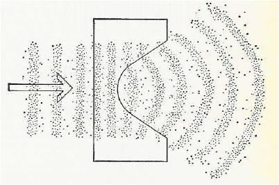

In general terms, the lens provides an acoustic path length that increase as you move off axis.
This delays the sound and bends the projected wavefront. See Attachment #2

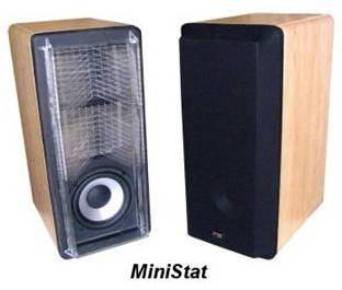

The Soundlab minisat incorporates the lens into its grill frame. See Attachment #3
Looking at the Soundlab lense, you can see that they did not use the hyperbolic cutout that JBL and JansZen did. Rather, a simple 90 degree notch was used.
For your purpose, you could keep the flat panels you prefer for personal listening and build a lens/grill frame that you could attach when company comes over. When using the lens, you would need to EQ up the high frequencies since the lens takes what had been an on-axis flat response and spreads it out over more space. The result would be a drooping HF if you didn't correct it.
