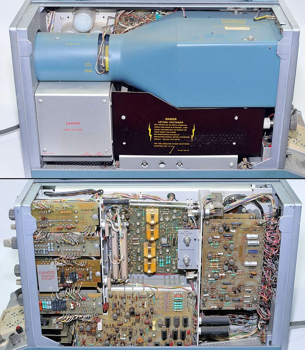

You could get an Instruction Manual for the Tektronix 576, it's like 1 inch thick, with schematics, service information, circuit descriptions, parts lists, everything. Either the real manual or on CD.
You can also get key parts like the step generator and collector (plate) supply, power supply, display amplifier .....

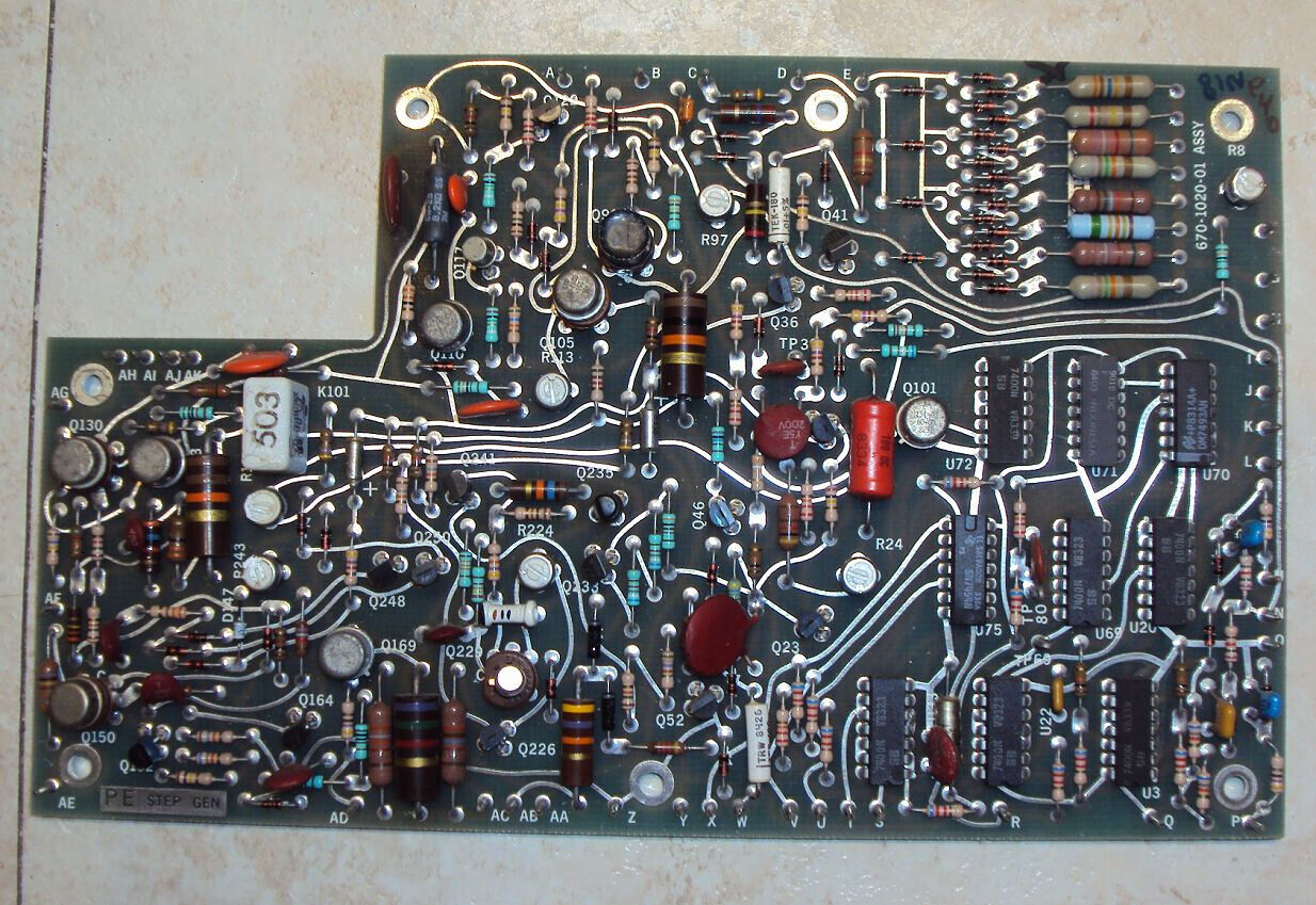

The step generator:
https://www.ebay.com/itm/145488175207?itmmeta=01HS4GF1F0JVQFV37VNHZ1SHGC&hash=item21dfc56067:g:VV0AAOSwzBVlc2I0&itmprp=enc:AQAIAAAA0IMzL/IlmXg2siKqwMw56Av9gY2/75GSJ4SYiROMa4J6iNwYhiGUHUc6y0qshaxO/jL9D6PaE6ff/qFMu8CnmRyWhDgivQ8VcrTghMZuFmJXk3NNM/x4OPEquNwyCQ5qfMXtJYorQca3oMd2bPTW5VE28acuQsBzxi7yAyhOIFGf3XUKCsOwXPmr6wqiI3rSHy1NcYOOzY7UPK53XO3S2DJxuo5u8BM1vgwxJdd+5ksPbGtgMGmpO2SuiYk3YcNMDLFtilbijWD9HuIekK6UhXc=|tkp:Bk9SR8yXvJDJYw
You will need the step generator selector switch to go with the PC board. Part # 670-1025-02
I don't see one currently on Ebay, but they come up from time to time.

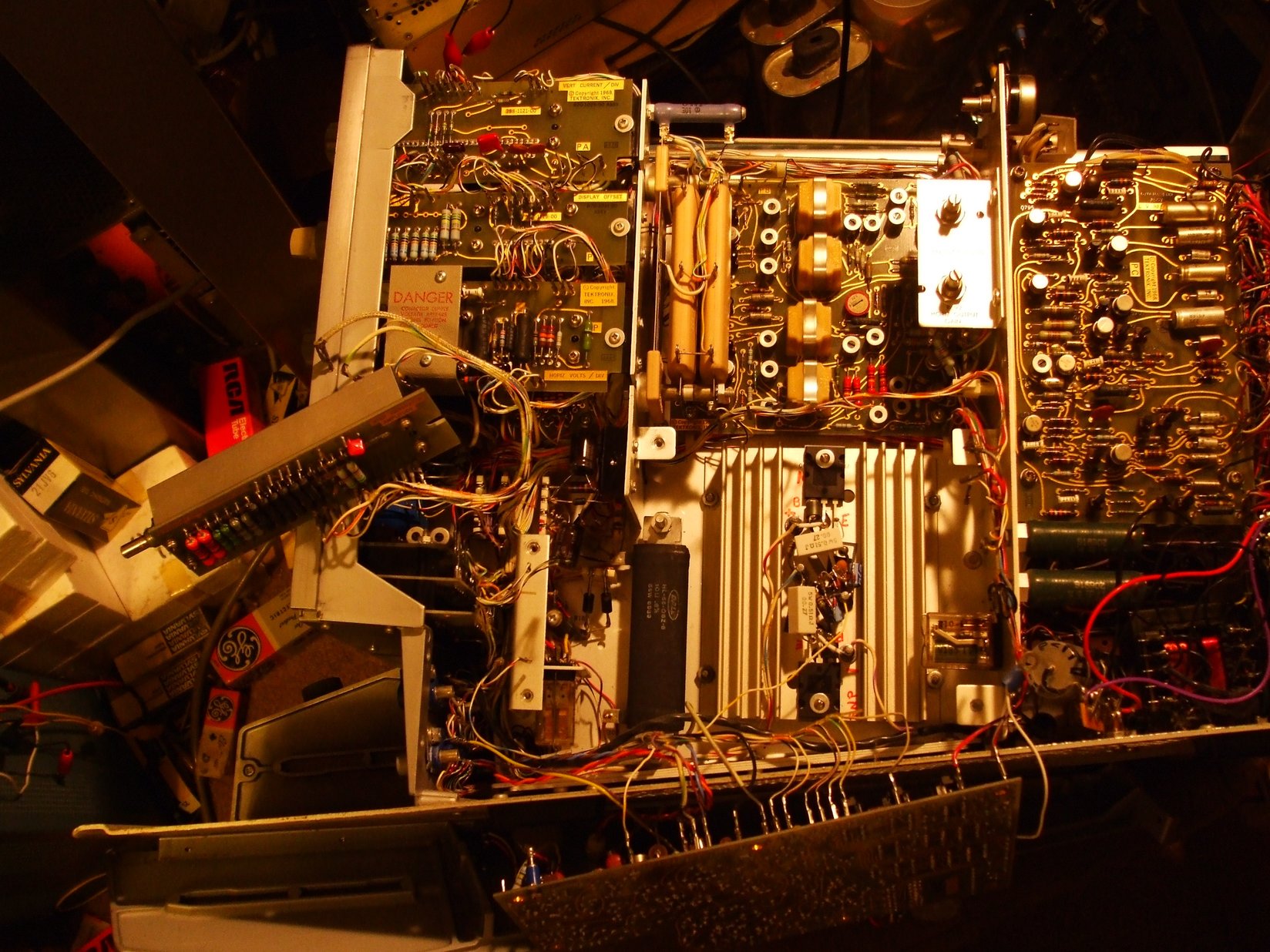

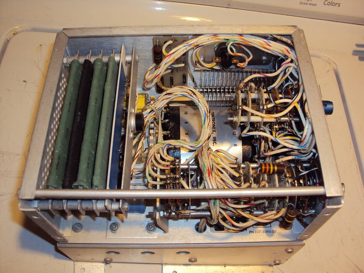

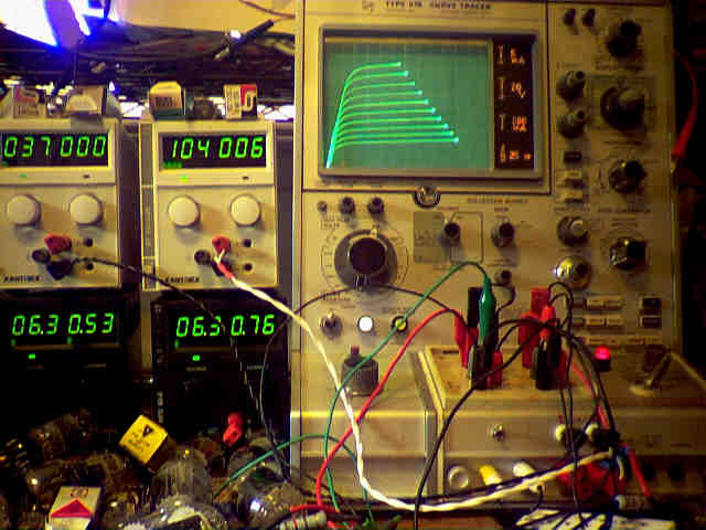

Here is a picture taken while making mods to the Tektronix 576 to curve trace tubes. The Step Amplifier (on the big heatsink ) gets modded with higher voltage transistors to handle steps going up to +/- 170V total. Some caps and diodes around the Step Amp get up-rated for higher V too. And a boost supply for the step amplifier gets added in the bottom right corner. The Step Generator PC board is swung out at the bottom to access the Step Amplifier.

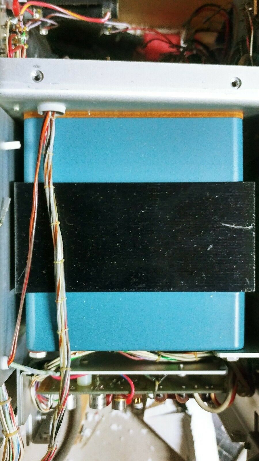

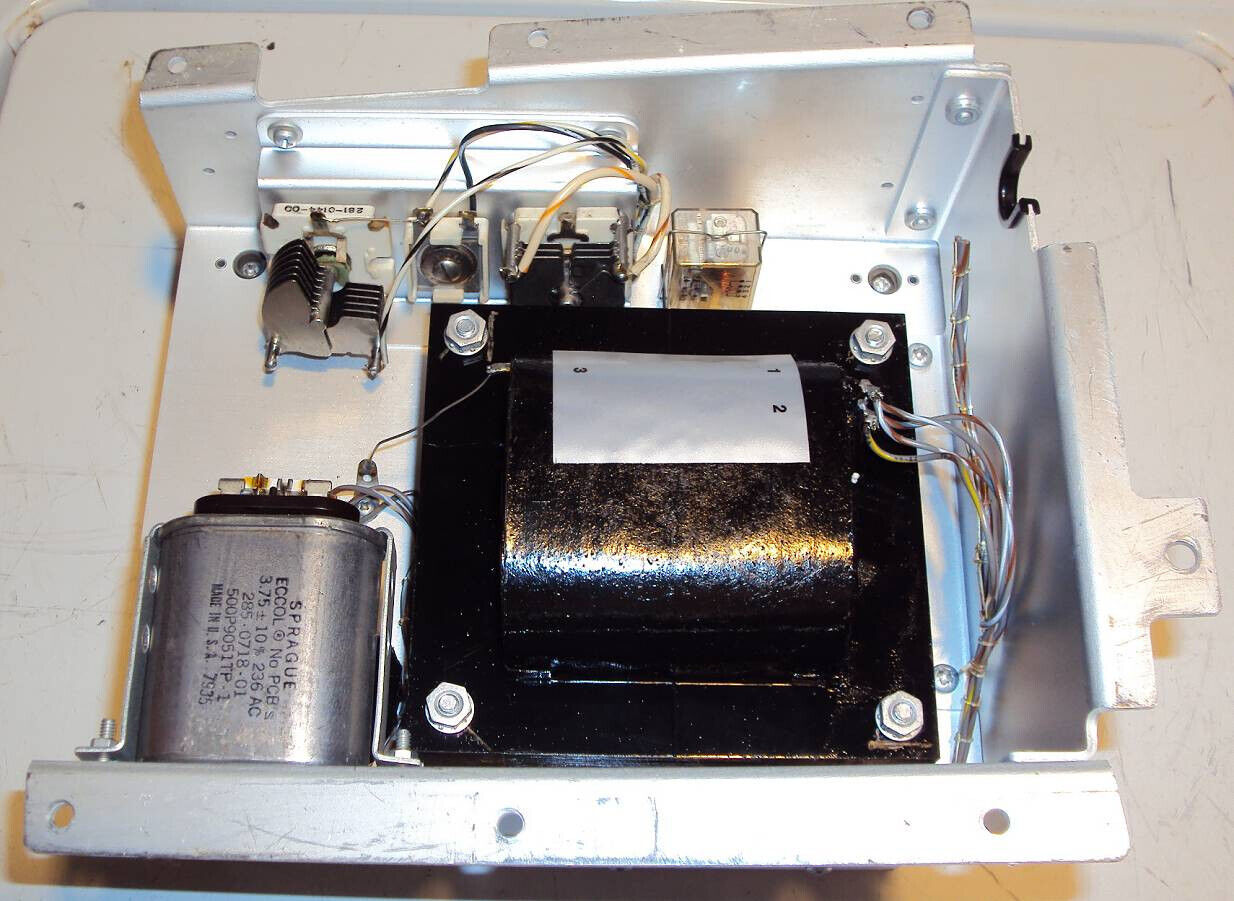

Back to components. Here is the LV xfmr that runs the unit:
https://www.ebay.com/itm/3260457374...OkCK2nBMRnITUiZIfVf6Ku8uT/Q=|tkp:BFBMptXumslj

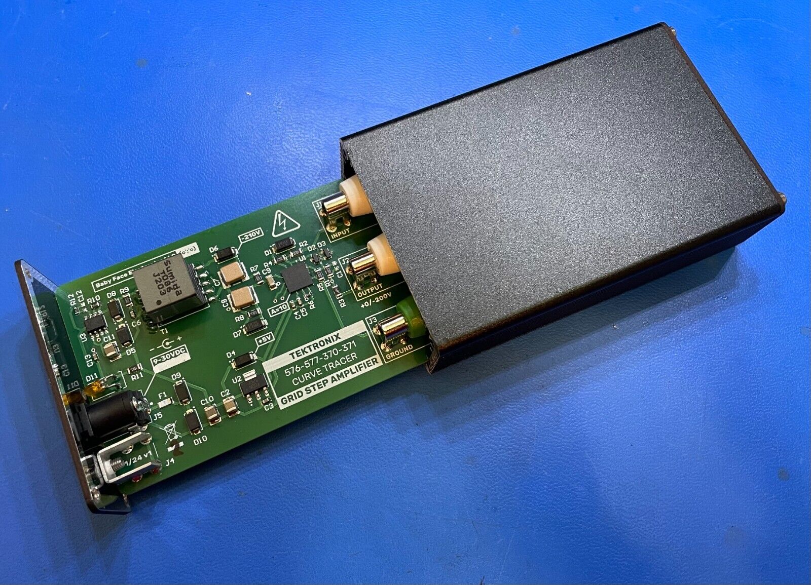

Here is an interesting product for the Tek 576, a Grid Step Amplifier 10X (to -200V ) for testing tubes. You don't have to mod the 576 for tubes with this. Must be new, I hadn't seen this before. 20 mA drive capable. Only does usual - grid voltages, so won't allow + screen grid curve tracing.
You will need two of these to conveniently compare two tubes on the two test channels. Umm, maybe can use just one to drive both tubes grids simultaneously.

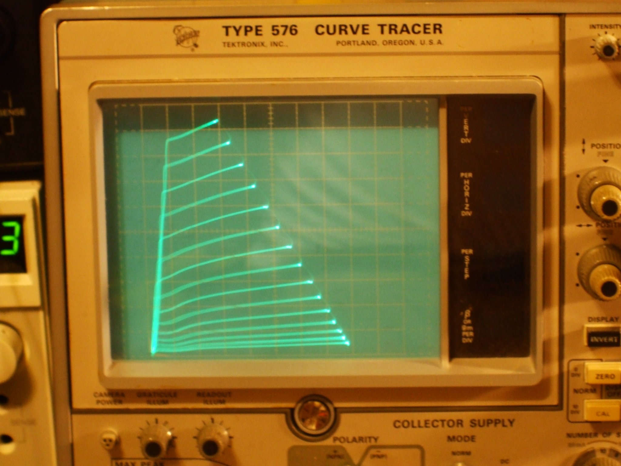

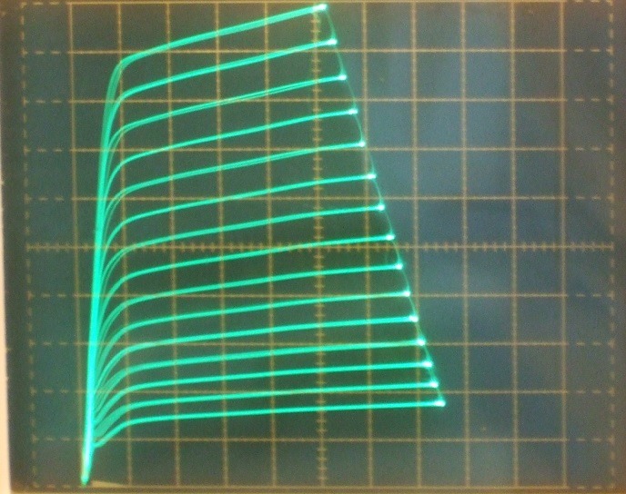

The Tek 576 can handle up to 200 Watt tubes. 1500 V plate V max. I actually modded that down to 750V max with a rectifier wiring mod, for safety reasons. So 400V and 750V plate sweeps are what I typically do on the 576. There is a Variac adjustment knob on the front for reducing max V ranges too.

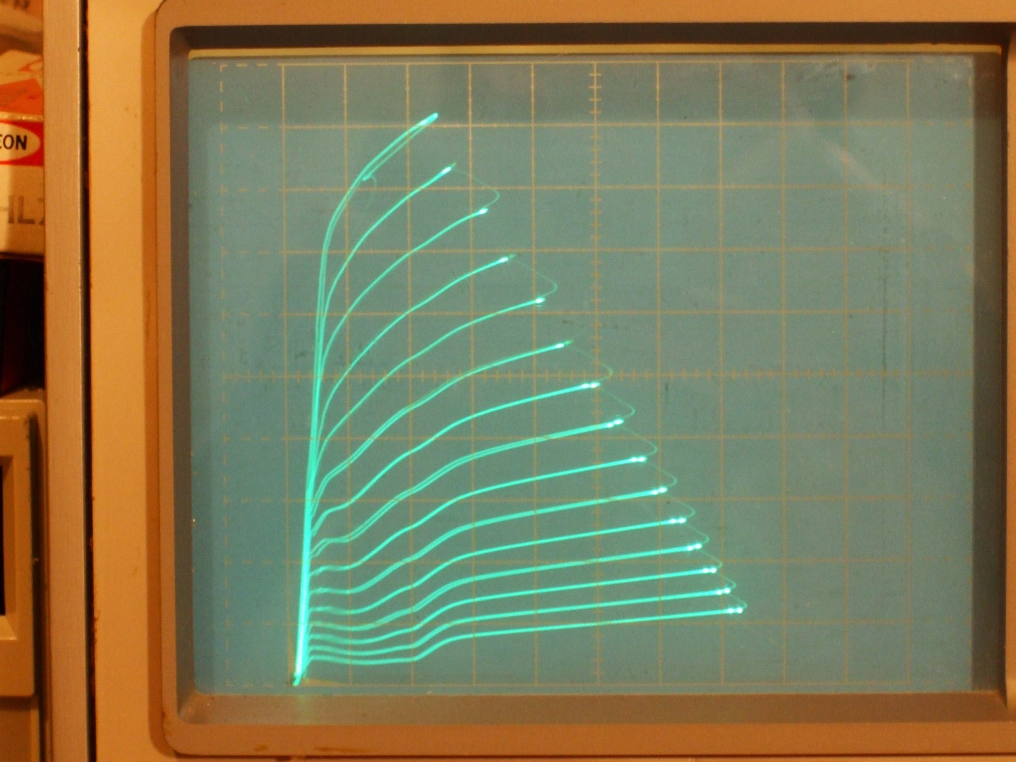

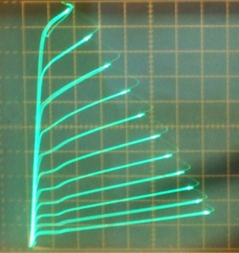

I also modded the step generator to optionally do 15 traces instead of the usual 10 (or less) standard. ( Just had to pull one IC pin up and wire in a different resistor into the D/A circuitry. ) Step size is also continuously variable with a knob on the side. Easy to read out the actual step V.
15 trace example below:
You can also do Vgrid to Plate current scans to check linearity of tube gm.
I use some digital readout, adjustable current limit, bench supplies for heater voltages and screen grid voltages. (Vg2 switches in automatically when running curves.)
A toggle lever on the device connect box allows you to flip between two tubes quickly for comparison/matching.

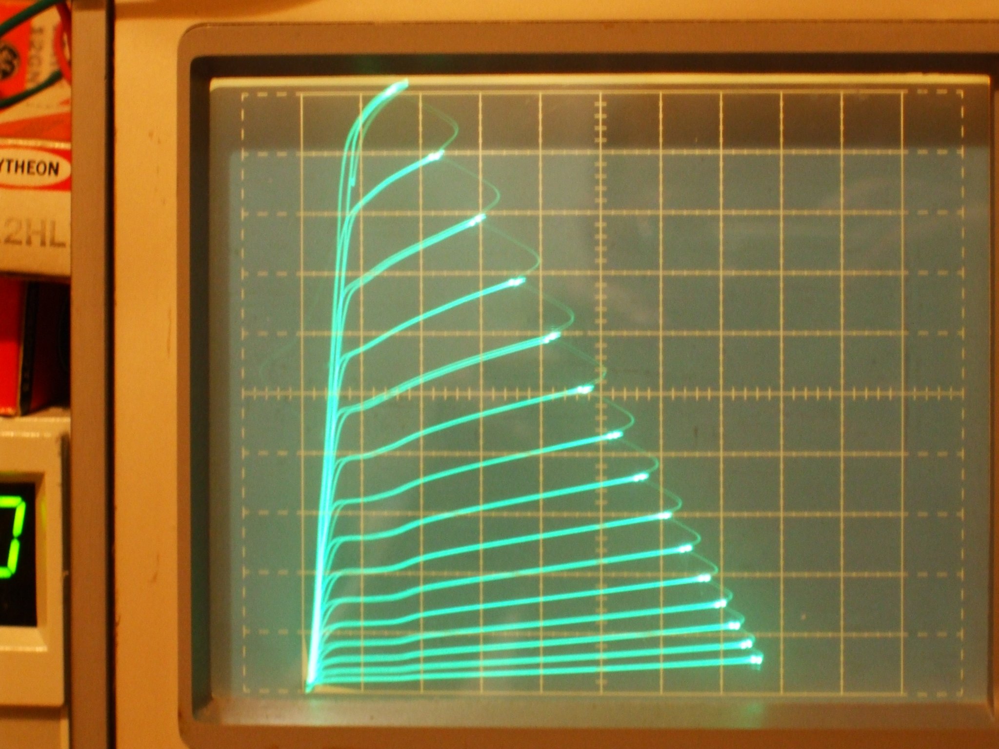

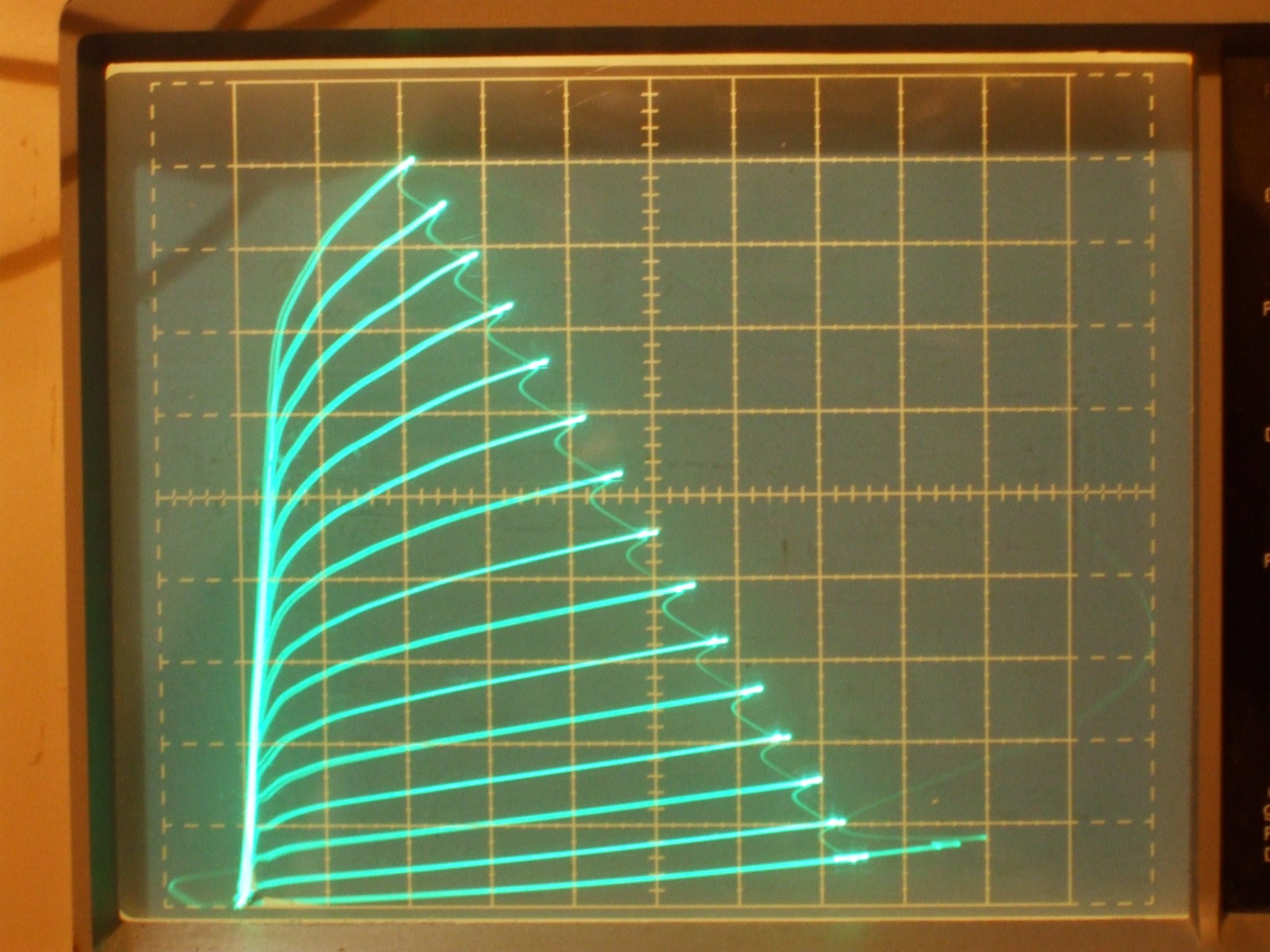

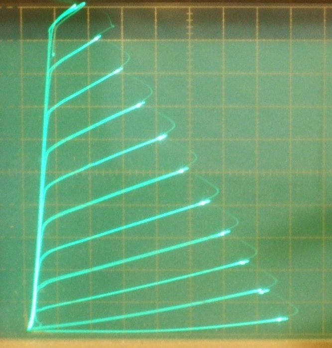

The low plate current, low plate V kinks that Keit was concerned about (point of the thread, for pentodes/beam pent.) seem to be strongly grid2 voltage related. Not sure that this got resolved as to the tube design issue. 26LX6 (a Sweep tube) demonstrates this moderately. Some tubes have really big kinks there, 25DN6 for example. And low screen current tubes have minor kinks, 21LG6. Grid2 drive or Crazy drive magically removes the kinks. But other pentodes don't have any kinks to start with, 6197. 6197 does not have grid wire alignment. But 12HL7 does not either, but has the kinks back. I'm sure grid wire alignment is part of the story, but apparently not the whole story. Some more fun curve tracing needed. I have one sweep tube where grid2 is perfectly mis-aligned, g2 gets hot real fast.
pics: 26LX6grid1drive, 26LX6Crazydrive, 25DN6grid1drive, 25DN6grid2drive, 21LG6grid1drive, 6197grid1drive, 12HL7grid1drive
