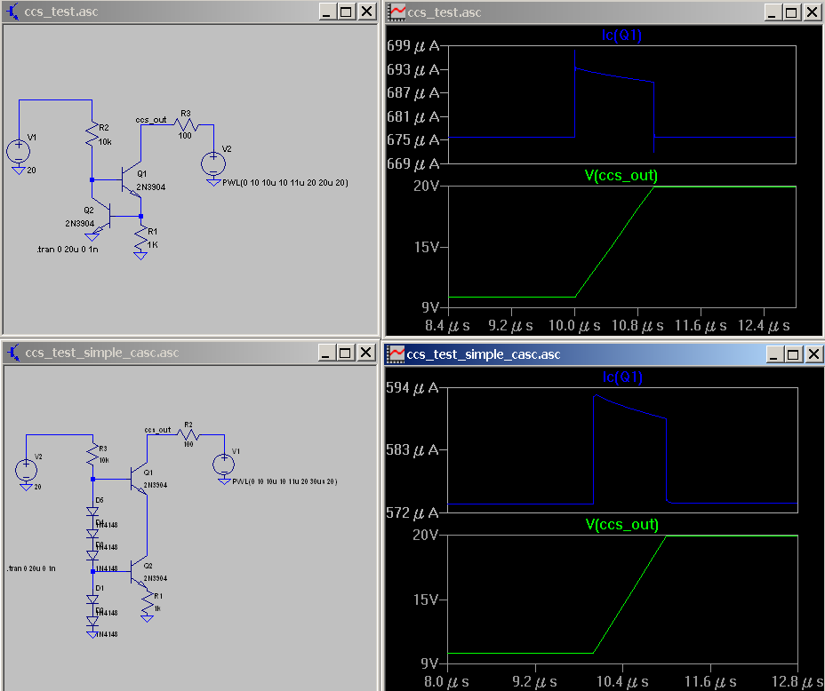

Especially ANF does contain deep NFB. I simulated the ANF configuration for relatively fast voltage transitions on the output (10V/us) and in the bottom transistor the current looked pretty ugly. It had to compensate for transient current flowing in CB capacitance.
I suspect there is more to this than meets the eye....info on SPICE set-up...and models required....
In fact the output impedance of the ANF current source (my prefered name for this arrangement) is of the order of 500M-1G depending on the control elements current gain.....
Loop-transmission local to the current source ranges from 10dB to 40dB up to 200KHz.....
Stability margins are vast....typically >80 degrees....
The ANF current source's transient response is the equal of, and indeed superior to that of any other configuration...
Mikeks,
In ideal world ANF should be the best.
The SPICE is of course not a proof of anything. I actually was quite suprised to see any overshots in the very simple case:
see attached image comparing cascoded CCS and ANF.
I used LT SwitcherCAD and stock models.
The oscillation visible in ANF response decays within 10ns.
You might be right that there is more than meets they eye in that case (simulating engine artifact)
The pretty ugly stuff I have seen comes from, I admit, quite an extreme case: CCS for a class A single ended amp.
The power transistor was a MOSFET. When run with a more detailed SPICE model (I think it was one of IRFs with package inductances included) it would actually generate quite severe ringing.
This just proves that when parasitics are added in equation the behavior might be quite different.
BTW how do you know the phase margins? Care to share your results?
I was thinking of some more SPICE experiments but what really stops me is the knowledge that it may be a moot excercise since I have no access to a good quality models and simulator.
I guess we may need someone with network analyzer to build the real thing and measure it :smash:
Przemek

pb said:
In ideal world ANF (current source) should be the best.....
As with most things, that depends on the application.....
Be that as it may, the ANF current source does appear to be the optimal arrangement for the second-stage (TIS) source in the generic topology....where its transient response, (given large, and very short inter-component PCB traces), is exemplary...
Its performance, of course, may be further enhanced by using fast-recovery Baker clamp diodes.....
