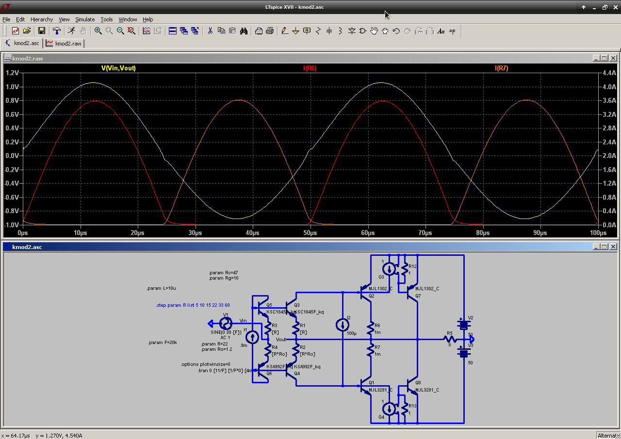

The problem is not merely slow switching. Now that the drivers control the switching, the output transistors must respond instantly to what the drivers do, otherwise the switching lags after the 0 cross point. The output transistor bases are shunted by both Cbc and Cbe, which amounts to a heck of a lot of capacitance, especially after Miller effect.
We can't compensate for this merely by designing phase lead into the drivers, because part of the charge current is Vout-dependent, and the other part is Iout-dependent. If the load impedance changes, the proportion of charge currents changes and the compensation will be over or under what is needed. And then there is the fact that these capacitances are constantly changing. But maybe compensating the majority of the charge current would be "good enough"?
I wanted to see what would happen if I just compensated the Cbc with a known accurate method. This does okay with 12mA keep-on bias provided by I2.
G3 and G4 act as current mirrors, which reference the Cbc currents of Q7 and Q8 to drive the Cbc of Q1 and Q2. This way Cbc is eliminated from the causes of phase shift between the collectors of the drivers and the collectors of the output BJTs.
I don't think anyone will be enthusiastic about the idea of adding expensive BJTs as vegetative limbs, but if you have 5 pairs of BJTs, and use 5x current mirrors, it might have more practical value.
As a proof of concept, it's at least better than before. The asymmetry at crossover is a result of the nonlinear base charge resulting from the exponential Vbe waveform in parallel with Cbe. There are some methods of compensating this as well, but parts count might become exponential.
THD is 0.11% at 20k and 1k.
I could bias the vegetables, but I've never found a reason to, unless you go the whole hog and use it as a power device to compensate not just the charge currents but the DC base currents as well. Which gets complex very fast with not much actual practical gain. And in this case, doing so would require the slave BJTs to be voltage driven.
The only way to get that to work would be to give the output BJTs their own feedback loops as power current multipliers, which could have been done in the first place, but the whole point of this exercise is to improve economy and simplicity, no?

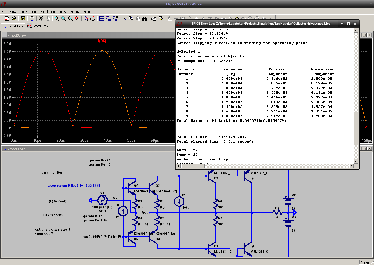

With delicate tweaks to the driver degeneration, I can get THD down to 0.014% at 1k and 0.042% at 20k.
The main improvement comes from removing the 2nd harmonic with driver degeneration offset, and finding the Oliver null point for them. It probably is very dependent on load and output voltage, and wouldn't hold up under thermal cycling.

Hi Mooley, When I compare you simulation schematic to the original schematic provided in EW there is a difference. You have both of the 1nf capacitors linked to the output node. Shouldn't Cf be connected to the base of Tr9?
Using BC550, BC560, BD139, BD140, MJE15032 and MJE15033 Cordell models seems to work. With a 20 kHz tone input generating a 30W output the simulation calculates 0.14% THD.
To set the bias to 100 ma required R7 to be increased to 1K (Depends upon hFE values). This can be checked using the simplified equations provided in the original EW article.

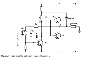

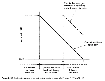

Peter Baxandal wrote chapter 2 in the 'Audio Engineer's Handbook' edited by Michael Talbot-Smith and he explains the standard push-pull emitter follower output stage has 3 modes depending on frequency and one of these is current drive. Bob Cordell's design approach is to minimise the current drive region by adding an extra 3rd Darlington stage 'Triple'. This means the current loading on the VAS by the output stage is negligible -- in other words the output stage is voltage driven and not current driven.
In a current driven output stage all the current from the VAS goes into the output stage. In voltage drive none of the current from the VAS goes into the output stage and the VAS current goes into the CCS and the VAS output resistance (due to Early effect) and the Miller compensation capacitor.
I'll attach the plot by Peter Baxandall showing the 3 regions for the standard Lin topology. This applies when the VAS has a high resistance load (either a CCS or bootstrapping) which is usually the case, but does not apply to the triple Darlington variant.
Peter Baxandall says up to f1 (LF) the output stage is effectively current driven. After f3 (HF) the output stage is voltage driven due to the low output impedance of the VAS from VAS local feedback. Between f1 and f2 there is a transition from current drive to voltage drive. This is probably news to most designers, even well-read ones.
Douglas Self may have explained this in his later Edition's, but I can't quote chapter and verse. Maybe someone can let us know if it's in one of his books.
If you want to read the full text by Peter Baxandall, it's on myDrive here.

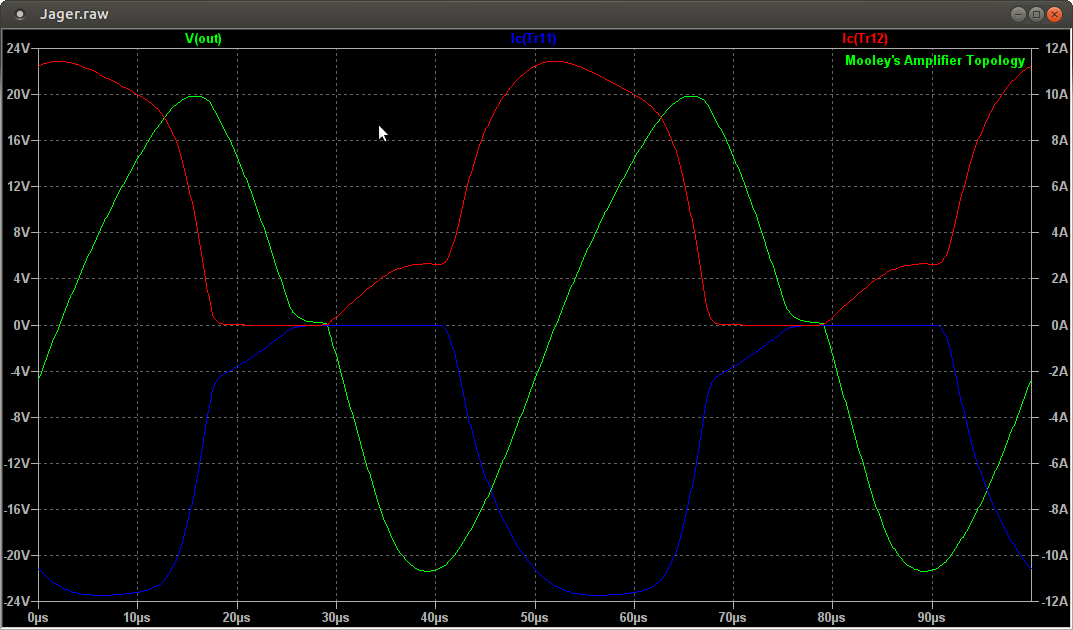

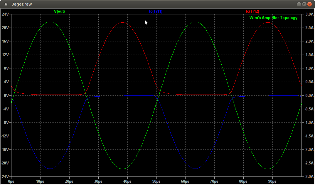

Some more information about simulating Wim's amp
In fact distortion is pretty obvious in the sim without even looking at FFT's or number crunching.
The artifact that you are seeing is a result of your (unintentional) modification to the original schematic.
Using the original component nomenclature from the EW article the simulation results when Cf is connected to the collector of Tr9 generates the artifact you are seeing. The biasing has been tuned to 100 ma with 20 KHz sine input. (See attachment MooleyAmp.png)
Using the original schematic with Cf connected to the emitter of Tr8 gives a better result with 100ma bias and 20 KHz sine input. (See attachment WimsAmp.png)
The original schematic set R7 to 150 ohms to give 100ma bias. With the devices I used it was necessary to set R7 to 1K to achieve the same 100 ma bias. The output transistors did have different beta values. This explains some of the asymmetry in the current waveform though the output transistors. Depletion charge also has some effect.
The open-loop bandwidth is less than 1 kHz. I believe this is the main reason the THD is about an order of magnitude worse at 20 KHz compared to 1 kHz. Of coarse it is possible to modify the amplifier schematic and test this assumption.
