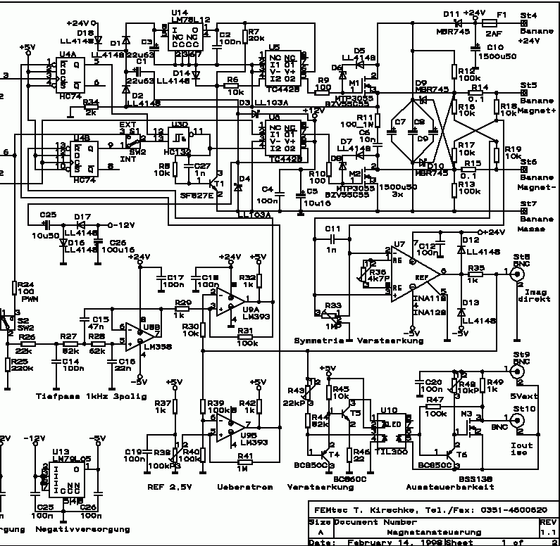

Hello, a couple of years ago I also had to build some circuits with a variant of current mode control.
Both Fets opened synchronously, the current was measured across R14 and R15. The resistors R16 through R19 removed common mode swing and doubled the measured output. Maybe, this is an idea for full bridges.
I also used current transformers for C-leg current sensing in a piezo-motor application at around 80kHz with very small ferrite cores, diameter was about 6mm from Epcos. Have to check the correct data, if interested.
Regards, Timo
Regards, Timo
