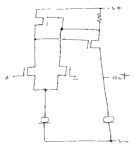

This is an interesting circuit -- I think I saw a bipolar version of it in a schematic by Stocchino (sp?) in Electronics World a few years ago. When I modeled it in Workbench using MOSFETs, the distortion was extremely low, as you might expect. However, it had a rather nasty turn-off glitch at clipping, which I tried to get rid of using a HF bypass cap without success.
Does anyone know if this glitch is present in the actual circuit, and if so, is it curable?

I suspect that your scheme might be similar to the input stage used in the ETI-477 amp designed by Dave Tillbrook. He used BC550C and BF469/470 transistors.
