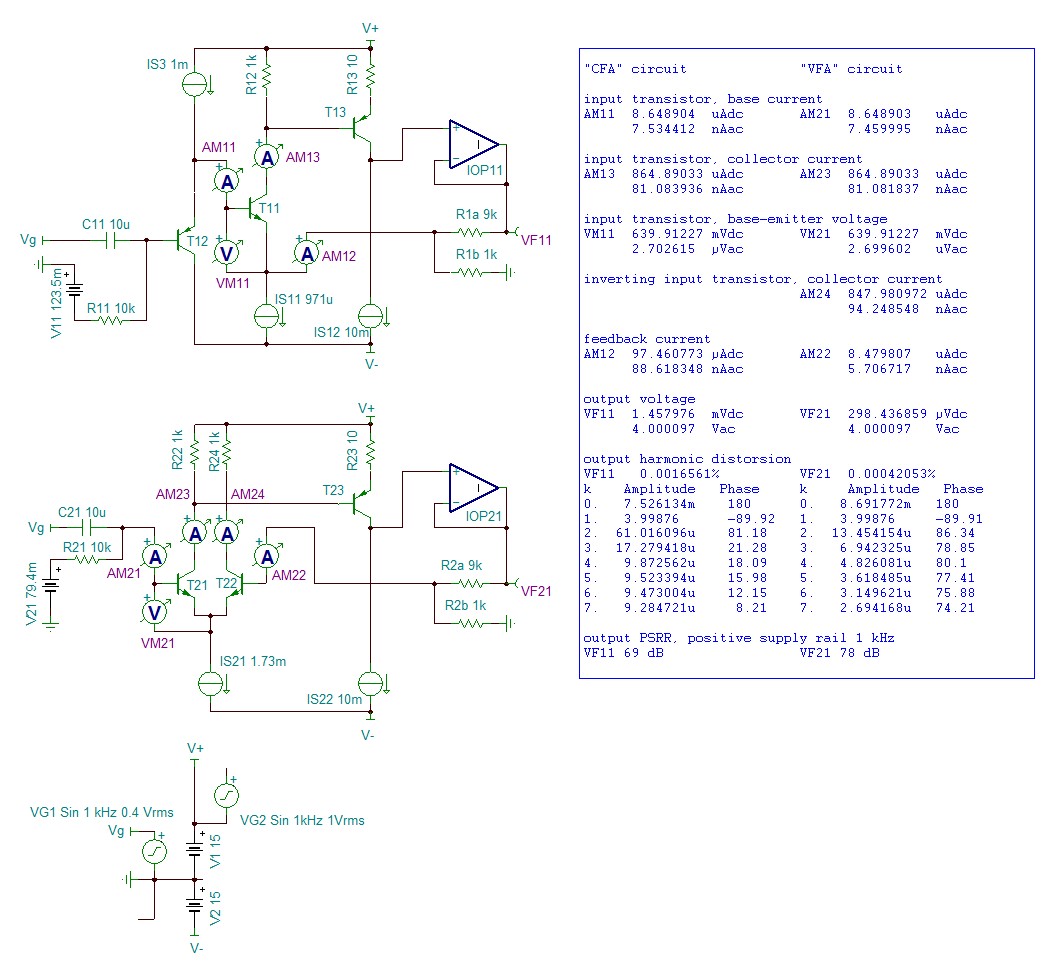

This is very a basic comparison between a so-called CFA in a simplified form and a VFA.
It shows that input transistors T11 and T21 work at AC and DC with identical values. Their output current is determined by their Vbe
It's quite difficult to see where a current is fed back.

A properly balanced LTP generates far less even order distortion than a so-called "CFA" input stage.
Notice that typically so-called "CFAs" are single gain stage arrangements: merely a pair of complementary common-emitter amplifiers with each acting as the collector load for the other and current mirrors used for level shifting.
Therefore, the amount of forward path gain, and, thus, loopgain, generated by the "CFA" is far less than that generated by traditional VFAs with an LTP first stage.
