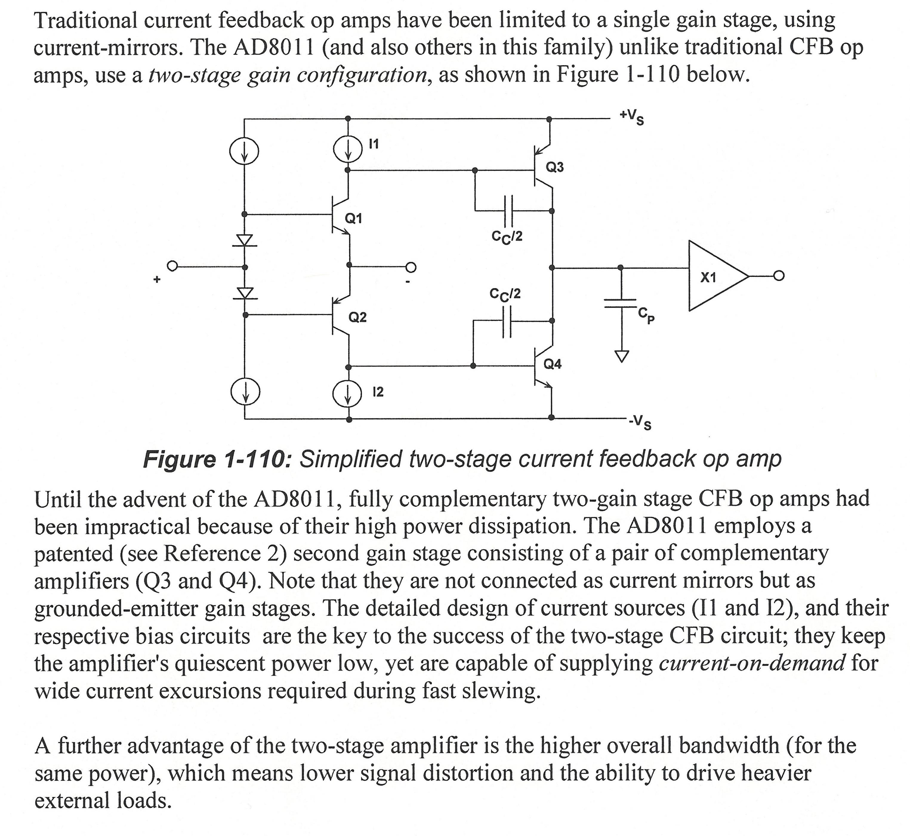

This is the same as I just earlier put up from AD's archives (see Fig 1-110).

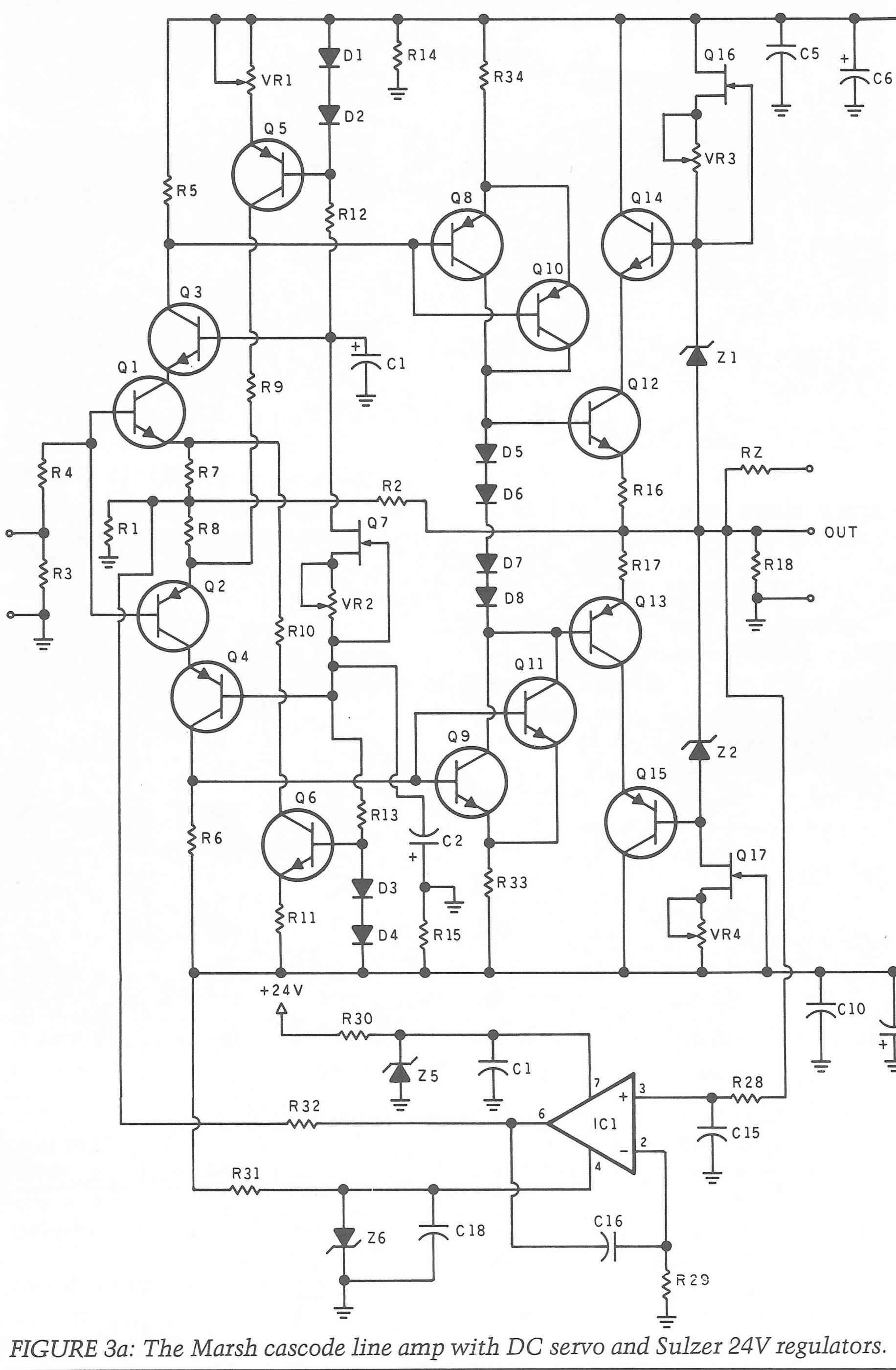

Look at Fig 1.15. The AD8011 topology (1995) was from earlier work by others before it was put into IC package. You will find the topology origins in the article that I did in Vol 3 of Linear Audio.

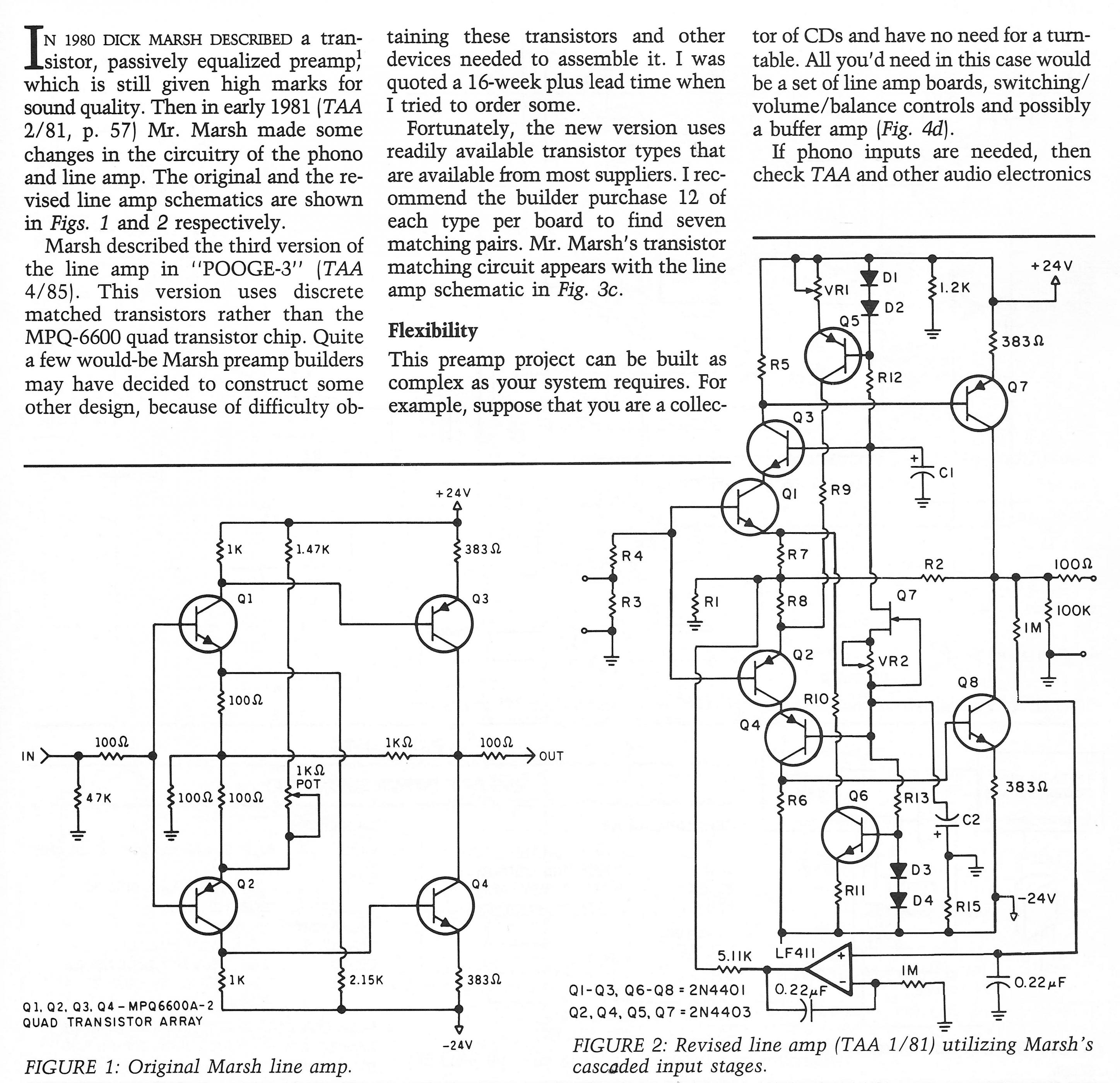

But to make a long story short.... I did it and published it in TAA back in 1980... pre Elantec. My original work was done in the late 1970's. It was done as a line stage and also similar idea was published for a MC pre-preamp. The MC pre-pre used complimentary push-pull common-base input with cartridge as emitter/gain resistor. Ckt used gnfb to input to further reduce input Z and load the MC cartridge to lower its distortion right at the source.
Thx-RNMarsh

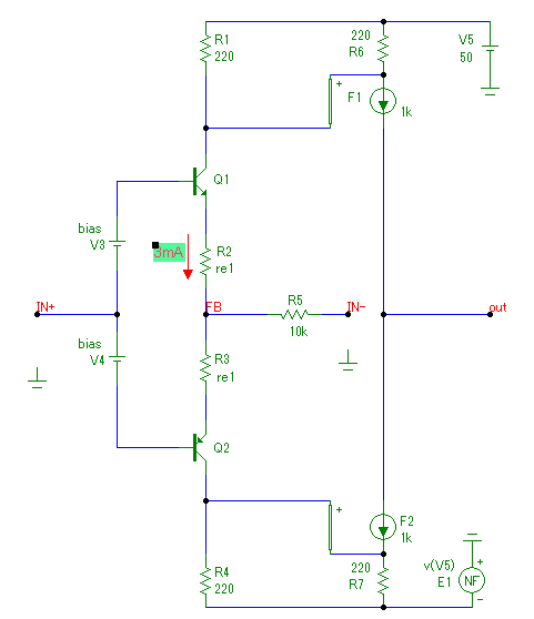

Hi Jan,
See picture.
>How does that improve linearity?
Same principle as with class B output stages.
Re1 + internal emitter bulk resistance should equal to 26mV/Ie (at room temperature, at least).
E.
Thx-RNMarsh
Look familiar?
Thx-RNMarsh
