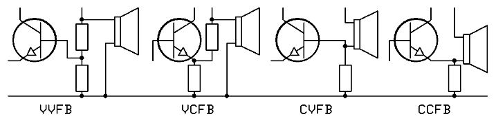

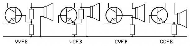

Kiwanuka said:Whether a circuit is a current feedback amplifier is and was traditionally established by identifying its negative feedback connections. The so-called “current feedback” topology almost invariably utilizes series-applied, shunt-derived negative feedback, which makes it a voltage feedback amplifier. It is to be regretted and roundly deprecated that so many intelligent people wasted so many decades deluding themselves over this rather pointless topology.
This nicely summarizes MK's position. While indeed calling the CFAs "current feedback" is in violation of the basic negative feedback topologies (as many as 4), being in fact exactly "voltage feedback", calling the CFAs a "pointless topology" and the authors "deluded" is absolutely garbage, and he should be ashamed of.
I would 100% agree though with his evaluation when it comes to audio amplifiers.
