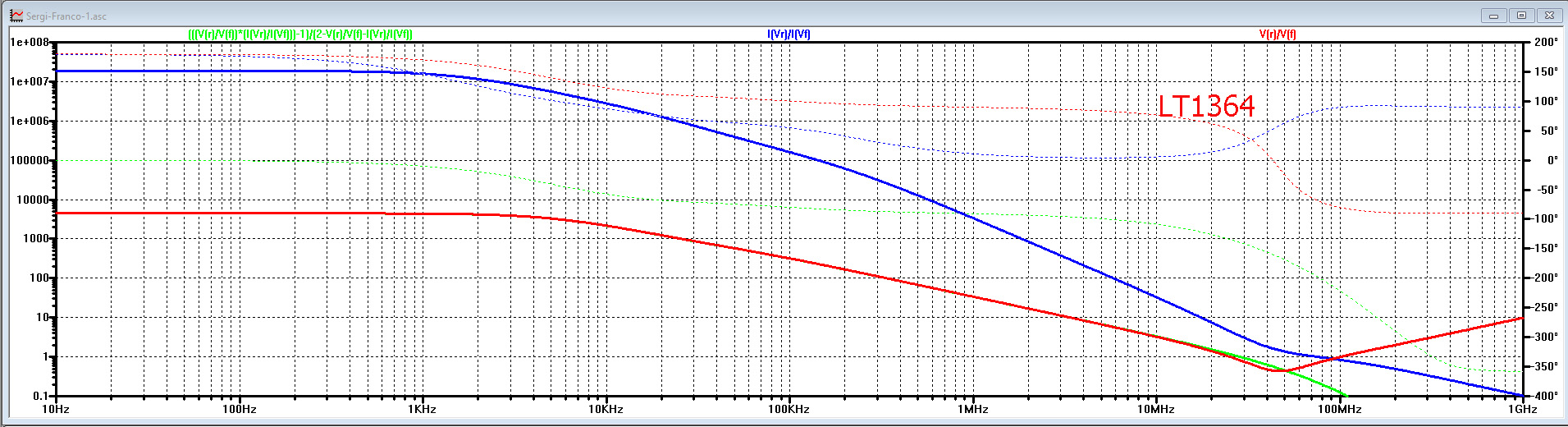

If you apply the DIT rule to the LT1364 it must be a CFA because it uses a 500 ohm resistor to drive the inverting input.
717464d1543002367t-current-feedback-amplifiers-semantic-lt1364-gif

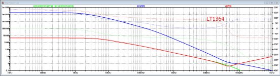

IH

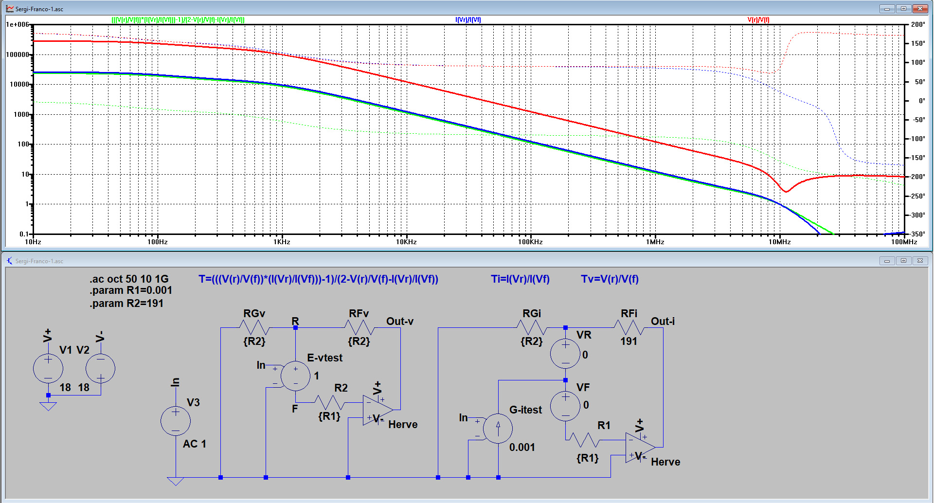

In the model I have made available based upon the Middlebrook DIT, you can freely change the values of the feedback network and see whether it is still meeting any of the conditions.
With very low values, the CFA might no longer be classified as a CFA, however stability does not allow to make the values too low. But you can test your circuit exactly as it is going to be used.

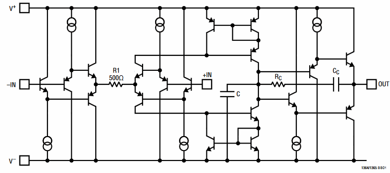

Where in the circuit would you propose to apply DIT? It makes a difference. Normally, this would be done at the inverting input. There, you'd find a VFA, not a CFA.

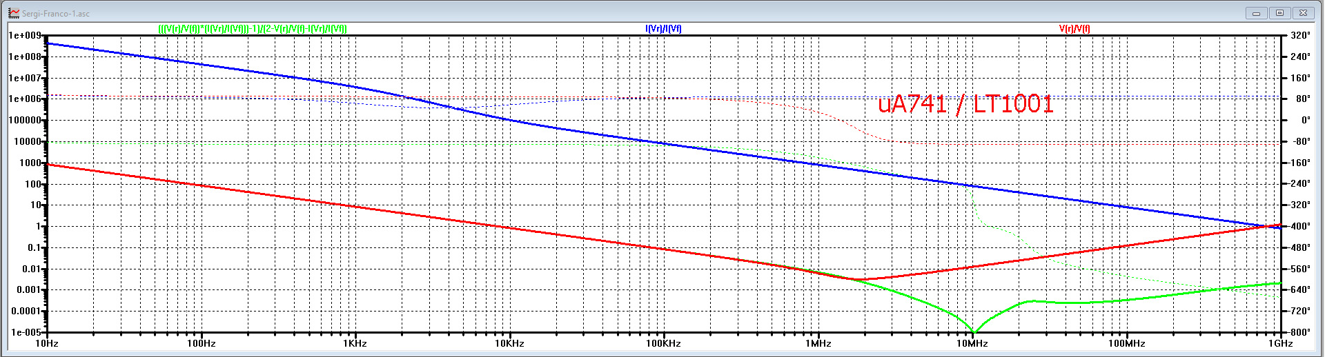

Still, I see a problem with resorting only to Middlebrook to distinguish them. If I drive a 741's non-inverting input with a voltage source, connect a 100 ohm resistor between its inputs, and employ a 10k impedance feedback network, voila! I have a CFA!

Hi Chris,
I didn't use a uA741, but a LT1001, also being a very slow sub 1Mhz GBW amp.
I used the 10K feedback and 100 Ohm between the inputs that you mentioned.
Nevertheless it is by all means still a very convincing VFA with the DIT method.
Hans

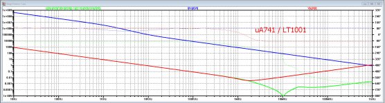

Hi Chris,
Hans
Huh! My error, I guess. When I changed the "Rg" in my feedback network, the bandwidth remained constant.
I'm left then only with a reluctance to name a circuit by its predominant form of feedback, which can be switched in some cases by simply changing the value of a resistor. That's why I prefer to use the source of the input stage current to name the circuit. This does not change with feedback network resistor values.

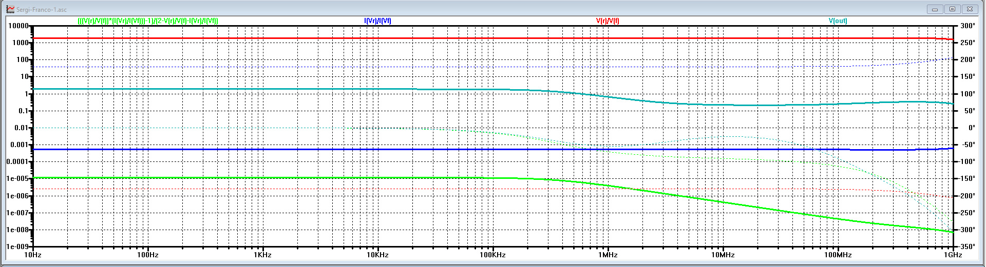

Ian,
Here is a reply to your other question what happens with a very large Rg.
I used a LT1395 CFA for this experiment.
Rg was made 10Gig and not the get a ridiculous high gain, Rf was made 100K
Looking at the image, it still holds as a CFA, because Ti is much closer to T and still decades from Tv.
I have added a fourth trace V(out) which is the output of the LT1395 when driven with a 1 volt input signal and Rg / Rf resp 10 G and 100K .
This gives you an idea how the transfer function will be under this extreme situation.
So far it seems that the DIT is giving the right answers even to extreme ones.
Hans
