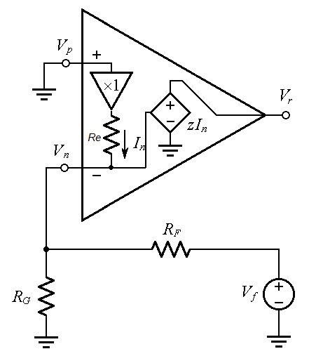

Currently many interpretations of the CFA topology rely on the two following schematics extracted from figures #1 and #3 of S. Franco's article :
In defense of the current-feedback amplifier | EDN
The first one represents a classical CFA circuit built around a diamond current-conveyor stage (Q1 to Q9) and a diamond buffer output (Q11 to Q14).
The Vn point, the common point to the output of the currents mirrors (if accessible) and the Vo node can source and sink currents.
The current-conveyor action consists in duplicating the current in the Vn node at the output side of the current mirrors.
The second schematics is a simplified application of the CFA.
The Vp node is grounded (0V) and the Vn point is connected to the output of a divider (Rf, Rg). The divider input is not connected to the buffer output of the CFA but to a voltage generator.
The Vn node which offers a quite close copy of voltage at Vp which is at 0V can be seen as a virtual earth.
One proof invoqued for the validity of the CFA concept is that, as there is 0V across Rg, Rf and Rg does not constitute a voltage divider and the only value to take in account is the current through Rf.
Of course ! As it is, the circuit offers a virtual earth input without global negative feedback. It Rg is connected to another voltage source instead of ground, some current will pass through it and enter the Vn node where it is added (mixed) with the current coming from Rf.
But, we have not to forget that the virtual earth input without global negative feedback, albeit being quite well performing, if far from perfection.

As long as the controlled source is current controlled, why would there be no feedback without re? Of course the schematic with controlled source is an oversimplification, but if you would have an ideal current controlled voltage source with high transimpedance at your disposal, I don't see why you would need an re.

Note : here I implicitly use the singular to refer to a pair of transistors of the inverting input (in-) of a diamond circuit.
The in- of a CFA behaves as a voltage follower (100 % local feedback) and acts firstly as an output towards the feedback divider.
It is the feedback network which is the load of the inverting input and not the divider output which loads the inverting input.
Thus the values of the network resistors do not much affect the voltage at in- which can have an almost null impedance (however, these values lower the open loop gain when they are increased) .
The in- delivers the necessary current to impose on its load a voltage which is a copy of the non-inverting (in+) voltage (buffers of a diamond circuit are considered as perfec).
This current is the feedback current in the CFA (topology) term.
But the feedback in amplifying circuits consists of substracting the return voltage from the input voltage. Currently, we only have a current...
Happily, the above process of delivering current is under the control of the transconductance of the transistor which emitter forms the inv- node and which can be seen as a kind of local output.
The transconductance is the law which intimately correlates the base-emitter voltage (Vbe) of a bipolar transistor and the current through it.
Here the base receives the (buufered) input voltage, and the emitter a voltage in correlation with the feedback current.
The Vbe, correlated to the feedback current, executes the fundamental process of voltages subtraction in an indisputable manner.
When the feedback is disconnected from the output, the inverting input is loaded only by Rb. When the feedback is re-established, the resistive value seen by in- increases and the current it delivers decreases.
The higher is the feedback signal, the lower is the error signal.
