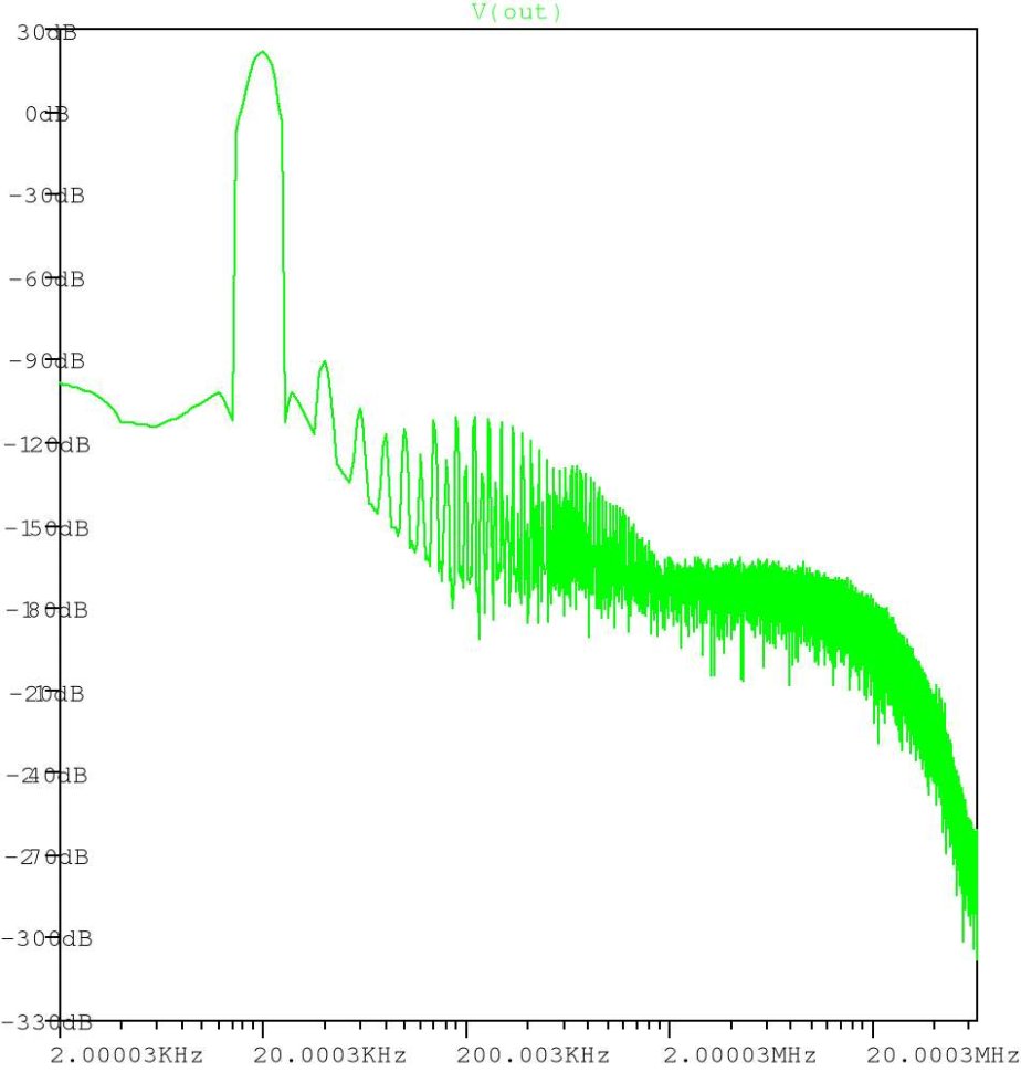

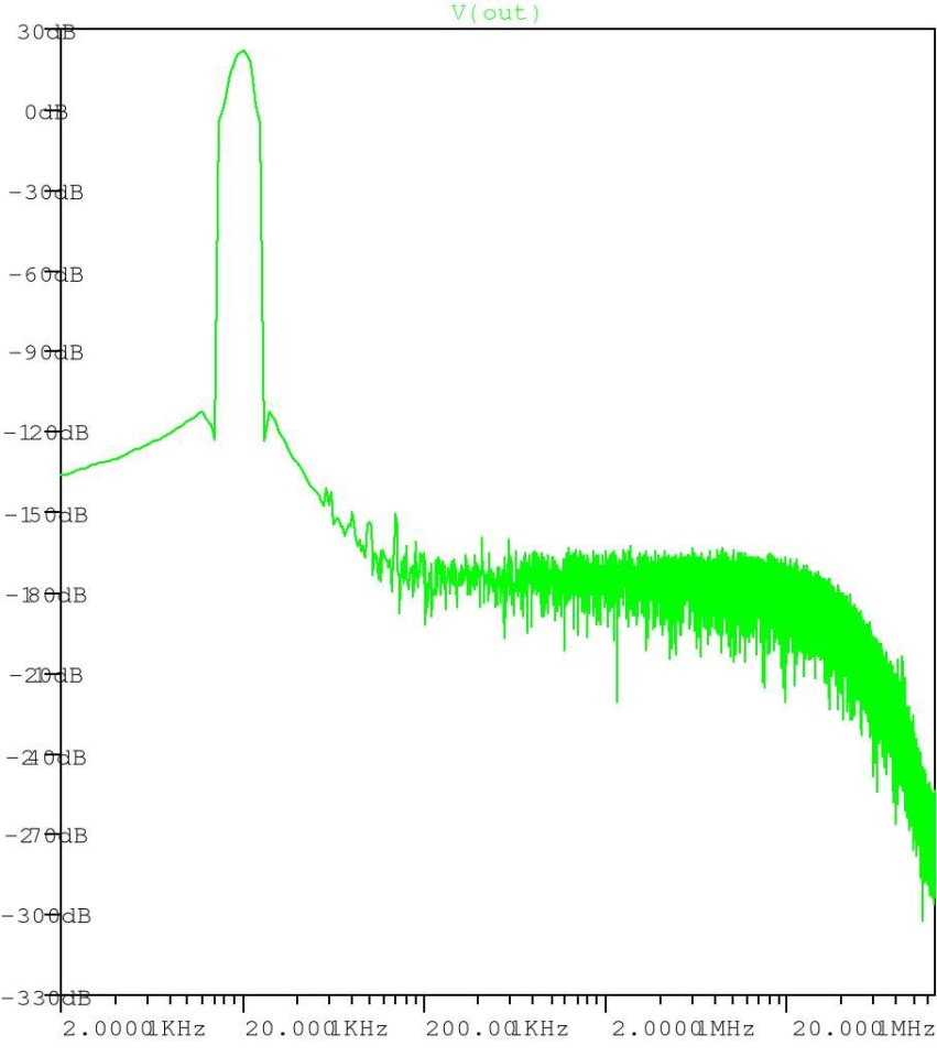

Glen, why don't you try to understand the Walker and Albinson patent and publications, instead of spouting gibberish? It's fairly simple to verify the LTSpice FFT numbers I posted, and you'll get something similar with a wide variety of BJTs - there's no fancy ultra-linear boutique device required, except for the VAS. You can even substitute the input stage and VAS with something very simple, and you'll still get the 10..20 dB improvement I'm claiming, as compared the version(s) without current dumping.
Edit: With an LME49860 as the Class-A gain stage, and a tricked-up current-dumping Class-A voltage-follower that I'd prefer not to disclose for a few months, I'm already at -160 dB THD20 at 1W into 8 ohms. Even with ordinary diamond buffers as the output stage, you can get to -130..-140 dB without any difficulty. The Class-AB numbers shown are not difficult at all.

I have “verified” your simulation results, and the problem with your method of obtaining ultra-low THD figures in SPICE is exactly the same as the last time I “verified” that Mullard inspired amplifier you LTspiced and quoted totally unrealistic (in the real world) THD-20 figures for.
This time the first thing I did was to enter your circuit into LTspice exactly as per the schematic in your opening post, but with the omission of the current dumping network (see attachment).
The output stage was optimally biased with ~50mV emitter-emitter at the output devices (Andy C’s models).

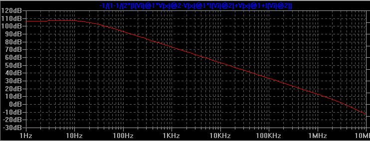

I then ran a transient analysis and THD analysis at 20kHz. THD-20 came in at 0.0013% and, not surprisingly, the amplifier could not even drive (without oscillating) the 10R/100n Zobel network without an isolation inductor.
I then ran a loop gain analysis (see attachment). The unity loop gain frequency is over 6MHz with a phase margin a couple of degrees! There is no way in a million years this circuit will work in real life.
The loop gain at 20kHz is therefore optimistically high and the THD optimistically low.
To return realistic THD-20 figures (which would actually be about 20dB higher) you need to revise the frequency compensation for a unity loop gain frequency at least 6 times lower.

I was just interested in simplifying the circuit to see a ‘best possible case’ reduction in the unity loop gain frequency, which was convenient to test as C6 (without the rest of the bridge) is in the common “phase lead” position.
As far as I can ascertain, with the rest of the bridge in place the unity loop gain frequency is still in the vicinity of 5MHz.
