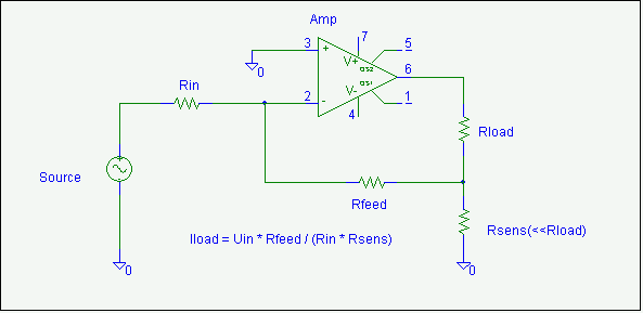

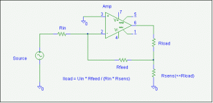

The disadvantage can best be tackled using an inverting amp and current feedback (one more reson to use inverting amplifiers :cool: ).
Regards
Charles
How would you go about this with an inverting (voltage feedback)amp? Your input current would have to equal the current through the feedback impedance = load. So you need another power amp and a resistor to generate the input current :(
Taaaaaa da da daaaaaaaaaaaa !
Regards
Charles
Edit: In the drawing it says: Iload = Uin * Rfeed / (Rin * Rsens)
It is of course: Iload = - Uin * Rfeed / (Rin * Rsens)
