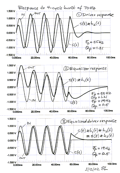

Hi Graham,
I think you are misinterpreting SL's comments. What he is showing is that by equalizing the driver, (in his example from Q=1.21, Fs = 55 Hz to Q= 0.5, Fs = 19 Hz), the response, in both the frequency and time domain, become identical to that of a driver which has Q = 0.5, Fs = 19 Hz without EQ.
We need to remember that suddenly changing waveform current cannot provide equal cone displacement during tonebursts (musical transients) due to driver/system specific kinetic-potential energy storage/exchange mechanisms which arise during waveform time.
True enough at resonance and below the resonant frequency, but not in the mass controled (mid band) region.

To compensate/control LF driver kinetic energy requirements a dynamic waveform needs additional boost/cut especially during the first half cycle of waveform change, and this would require a ‘tunable’ electronic gyrator the like of which I have not yet seen developed – one designed to match specific driver/system characteristics.
No. It requires the same type of eq as would be required to flatten the steady state response.
I thought I would post this picture to illustrate some of what I have read. The top curve is the impedance of a typical driver. The center curve is the response, normalized to the response with true voltage drive (zero source (Re) impedance) for various series resistors. As Re gets large the response approaches that of a current source. Below that is the phase response variation form the pure voltage drive case, with is directly related to the amplitude variation.
Also when the equation governing cone motion is written the force applied to the driver is given as

But it does Graham. The impulse response of the eq'ed system is the convolution of the eq's impulse with that of the uneq'ed woofer. This will yield the same impulse as an independent Q = 0.5, Fs = 19 Hz system.. form T=0 to infinity.
What is that plot suppose to show in your mind?
Compare the top plot, the un-eq'ed driver, to the bottom plot, the eq'ed driver. The improvement in response is apparent. The wave form distortion in both cases is a result of the systems (both before and after) being minimum phase. If you want to achieve a perfect burst response the eq would need to be carried low enough so that there is insignificant phase shift at 70 Hz and above.
The eq applied in SL's case is not inverse filter, it is just pole shifting to a lower cut off. If the system HP response is given by
T(s) = 1/(1 + So/Qo + So^2)
where So = jw/wo, wo is 2 Pi Fo, and Qo is Qtc of the woofer, then the inverse filter is
I(s) = 1/T(s)
which would yield an Eq'ed response
T'(s) = I(s) x T(s) = 1.0 = perfect reproduction.
What SL did was to eq by
Eq(s) = (1 + So/Qo + So^2)/(1 + Se/Qe + Se^2)
so that
T'(s) = T(s) x Eq(s) = 1/(1 + Se/Qe + Se^2)
Not perfect, but better (for a 70 Hz burst) due to the lower cut off frequency. In the frequency domain this is observed as amplitude and phase errors. If the system is eq'ed to a low enough frequency following SL's type of Eq but say, shifting the cut off to 5 Hz or even lower (in theory to DC), then the response would be further improved.

He is a plot similar to SL's except it is 5 cycles at 70 Hz. The top is Fs = 55 Hz, Q = 1.21, center Fs = 19 Hz, Q = 0.5 and bottom Fs = 2, Q = 0.5.
I(s) = 1/T(s)
so that

Forgive me Graham, but when I read your statement I did not see any caveats about what is practical, etc. I read an unconditional statement that inverse filters can not correct the problem. And I was trying to point out that they can. Not trying to be argumentative here. What is or isn't practical is another issue, to me.
The ideal of eq'ing the system flat to low frequency is an attempt to reduce the phase nonlinearity over the bandwidth of reproduction. It is the phase nonlinearity that is the root of the problem. However, there is a better way to attack it. This low frequency problem has been addressed and there is actually digital software available for correcting it. The stored energy isn't so much related to the amplitude variation of the response as it is phase. That is, it is a consequence that the system in minimum phase. If the phase of the 2nd HP response (q = 0.5, Fc = 20 Hz) were corrected to linear phase the first 1/2 cycle problem would disappear. All that would remain is amplitude scaling due to the amplitude response of the system. The Q = 0.5, 20 Hz system has an amplitude error of about -0.7dB at 70 Hz so what you would see is a 70 Hz output which followed the input exactly but the output would be scaled down by a factor of 0.96. If the response was a Q = 0.7 @ 20 Hz then this amplitude error at 70 Hz would be insignificant. Of course, at lower frequency where the response amplitude starts to roll off there would always be some amplitude scaling, though no time error.
The problem with this type of phase correction is that it requires a relatively long delay (maybe a few hundred msec, perhaps more). This isn't too much of a problem for music but would not be acceptable for sinc with a picture as required in HT.
