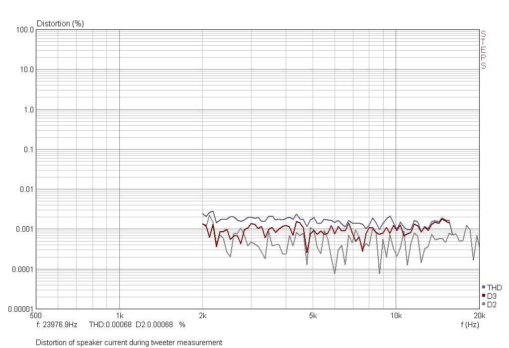

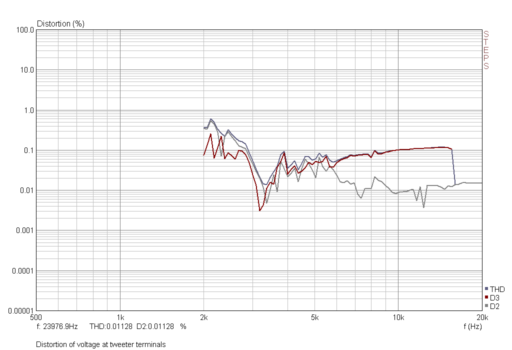

To build a V/I amplifier, one needs a soldering iron, as you have already stated correctly. So, I understand that the beach is probably not the best platform for the real work, though it may be inspiring, to some extent, for suggestion thoughts
I think that these two measurements may be quite interesting. They show distortion of tweeter current, when the tweeter is supplied from amplifier with current output, and corresponding voltage distortion at tweeter terminals. The distortion of tweeter voltage is a result of tweeter non-linear electrical impedance. Distortion of the current that feeds the tweeter is negligible, compared to its non-linearity.

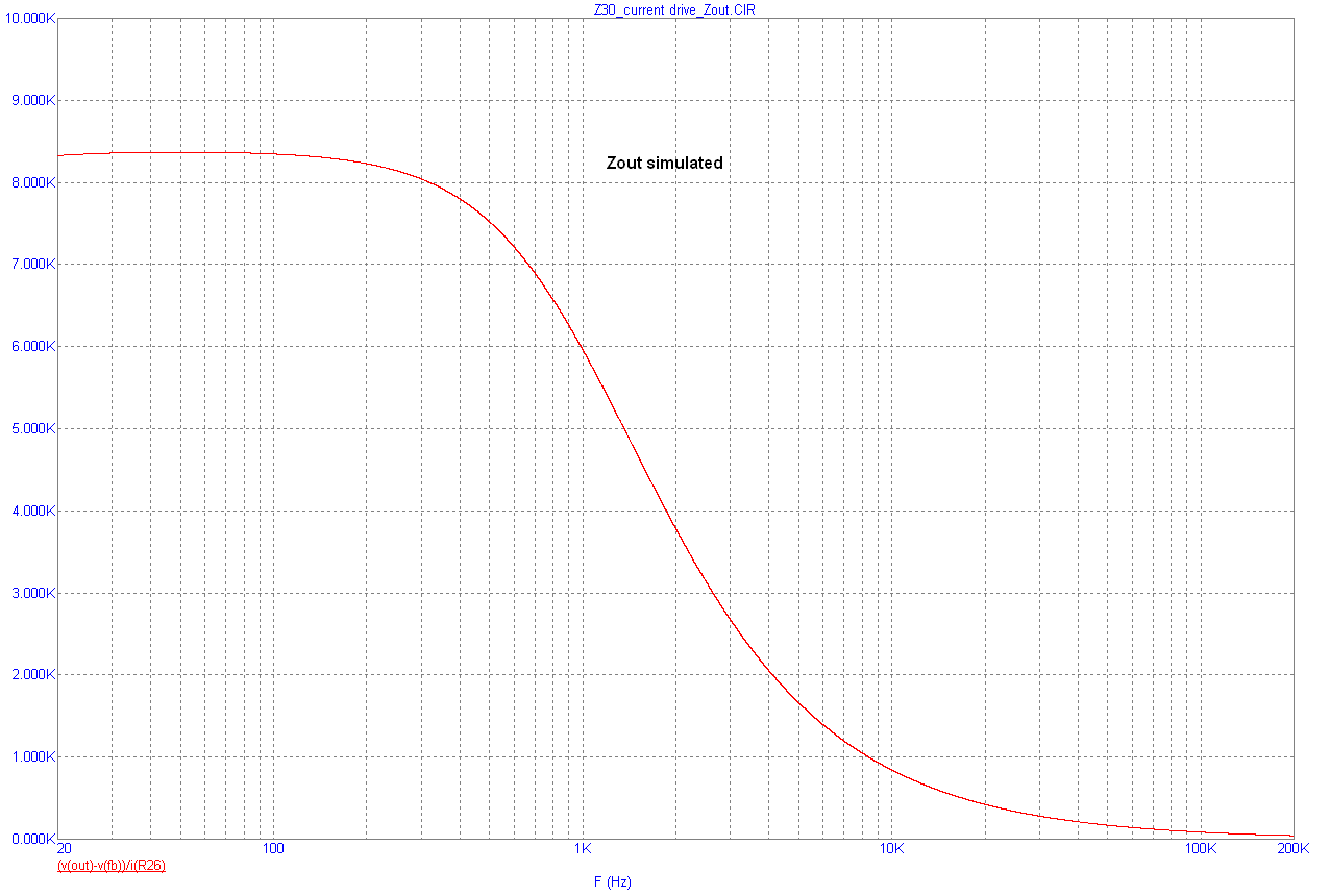

Lastly, are you actually doing what I proposed .. combining the inverse of the Impedance curve and 'measured' response with a target function to get good sound from a Current fed speaker?
Pavel, have you measured Zo with frequency of this amp? Without the R23 C11 & R14 C5 Zobels of course.This is the amplifier that I use for current driving of speakers. It is a very simple circuit.
Only simulated, I will measure it as well. This amp works even without those two Zobels for speaker testing, but I do not feel very well then
