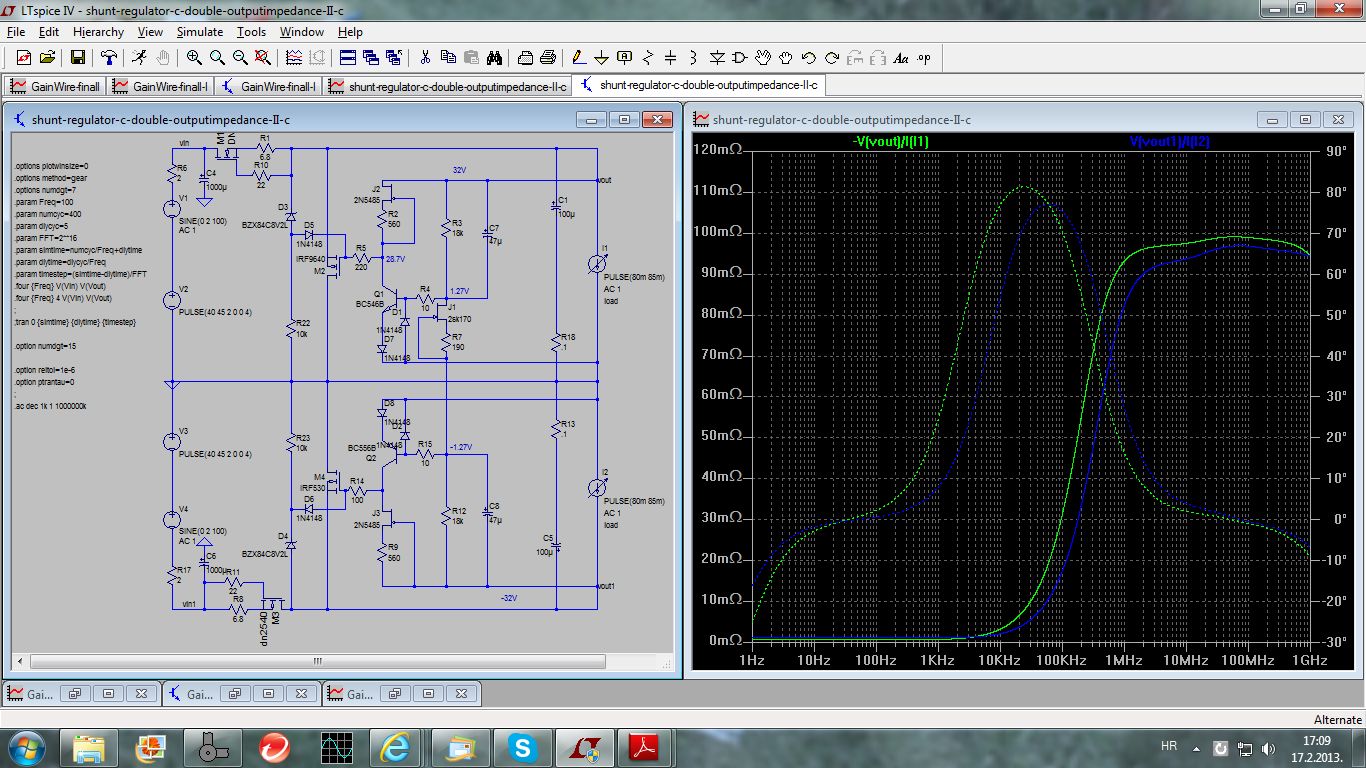

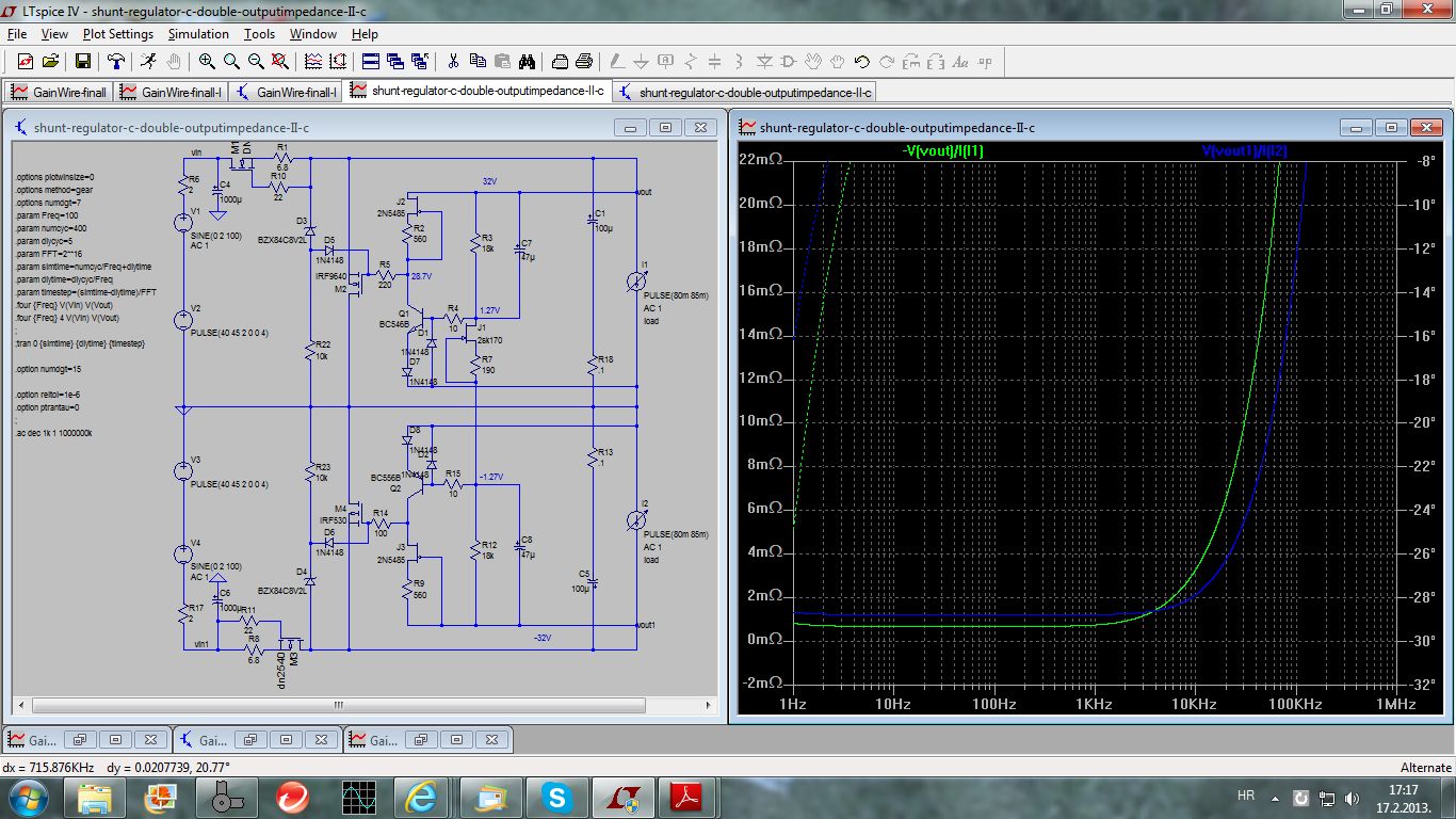

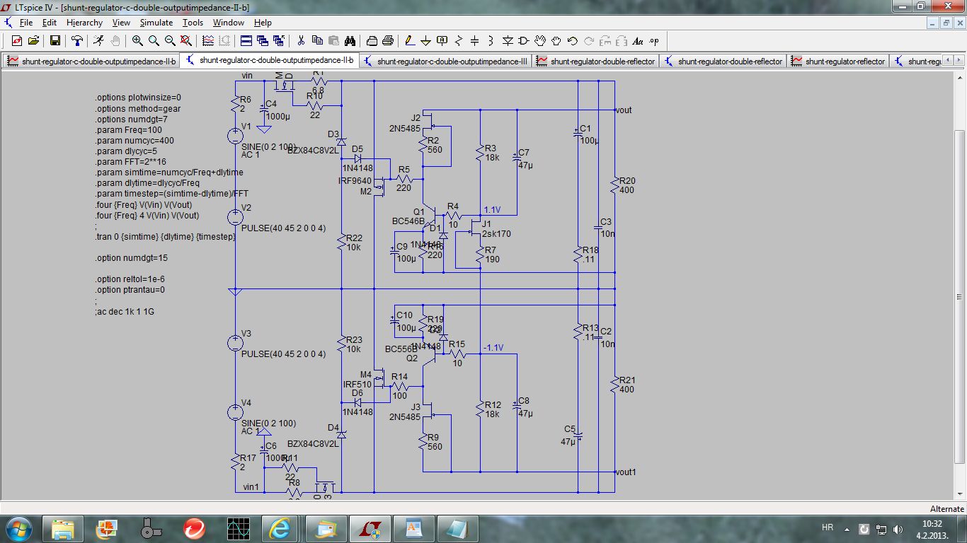

Here is new shuntreg simulation. I am trying to keep just one jfet ccs as in this case output voltage adjustment is possible with one trimer(R7 in this case). Here CCS voltige is 2.2 V and I think its on safe side of the knee(in saturation region).
dado
Yes, that's one way to get the voltage across the 170 larger. I also like the bypassing of the resistors with the 47uF, for lower noise, but be aware that for a fault condition on one of the outputs, say a dead short to common, the bipolar base associated will be abruptly reverse-biased and break down. This typically will result in beta degradation. So a diode connected across the b-e junction to clamp against reverse voltage is a good precaution.

One more caveat that occurs: again, under fault conditions, the power DMOS parts can see out-of-spec magnitudes of gate-source voltages. Although zeners for protection are somewhat high capacitance, you could bias one "on" and use a small signal diode like a 1N4148 to be normally reverse-biased and only clamp a gate for a good-sized but in-spec overvoltage condition.

I'm more worried about the shunt ones. If the bipolars momentarily saturate or swing too much the gate-source voltage magnitudes get big. |20V| is usually the momentary maximum, or you puncture the oxide and it's all over. For continuous bias usually |10V| is about as high as recommended.
Of course if no fault condition ever occurs, you'll be fine. But it's very demoralizing when bringing a new board up and some errant condition pops one of the parts :eek:
Have I got it correctly?

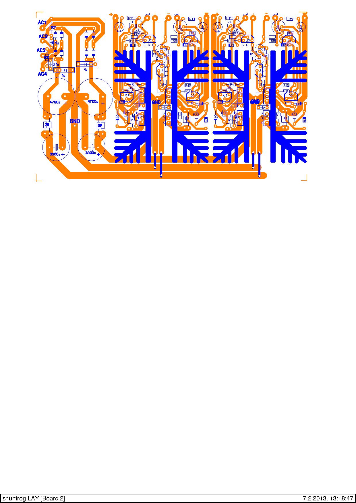

This is finall tested shunt regulator version. I built one channel for now, tested it with no load and with a load and it looks stable and no visible riple or high frequency oscilation.
Now I have to assemble second channeland test it with the lineamp(GainWire).

How about using those supertex depletion mosfet in place of the jfet's? They have higher early voltage than the 2sk170 at those low Vds. I just do not know if they are noisier.
I will buy some of this deplection mosfets for triyng some ideas.
You can also cascode the main current sources for higher output impedance of the ccs. But your regulator is very good as it is.
