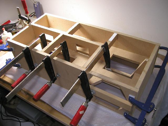

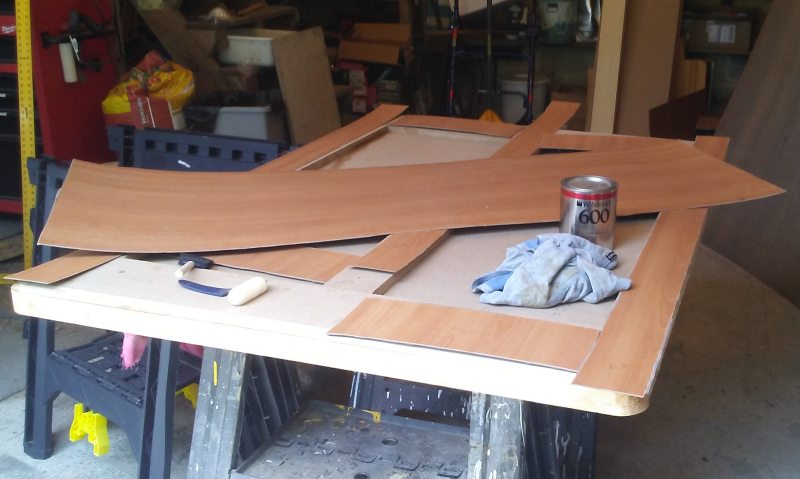

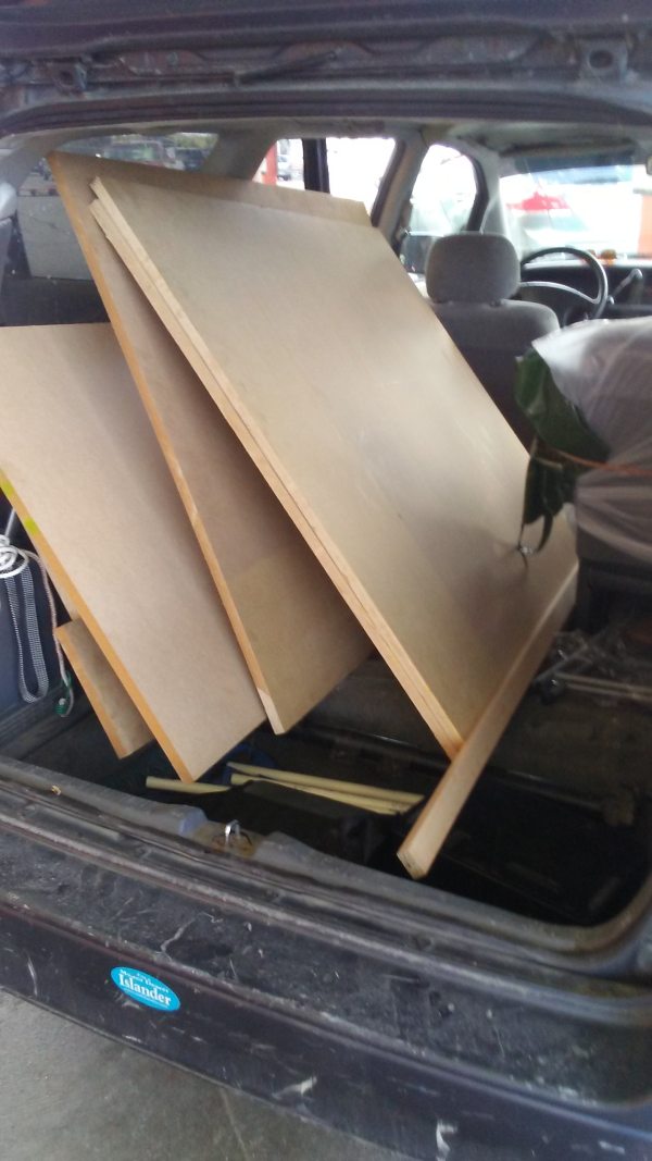

I have three rolls of Wilsonart which have been rolled-up in a woodshed since the 1980s. They unroll to a strong curl. An hour on a hot driveway took some of this out. When cut to sizes (largest 57"x42") the curl looks manageable, using scrap plastic pipe as stickers. Gonna try that tomorrow. But wondering how newspapers come into it.

Seems like the newspaper would stick? No, because not pre-coated? I guess I can try; I am starting on the bottom and a $#@!-up there won't show.

After some warm days (what we call hot), the curl is entirely manageable.
