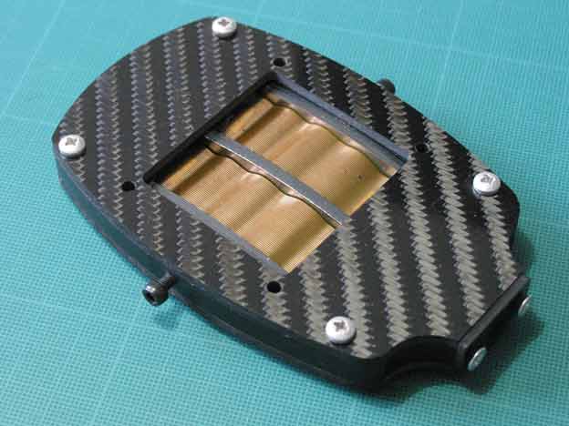

My diy headphones are not electrostatic but I do have electrostatic Stax 404s and have listened to Staxs for years,
the high voltages have never worried me...the stax use about
600v polarising rather than the 2kv suggested.

This is a picture of my transducer.
I only have one set of parts at the moment [I will have a pair when the rest of the parts arrive] ,the diaphragm is a reject one
I just installed for a test so ignore the dodgy folding.
No High voltage worries with this.
