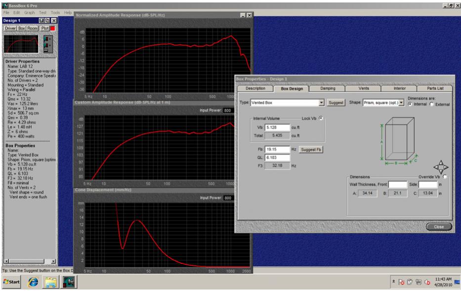

20Hz to over 200 Hz can be done at over 110 dB just using a 7.76 cubic foot (actual built size) ported cabinet with a pair of high Xmax drivers.
With room/corner gain, a single half that size may hit 110 dB.

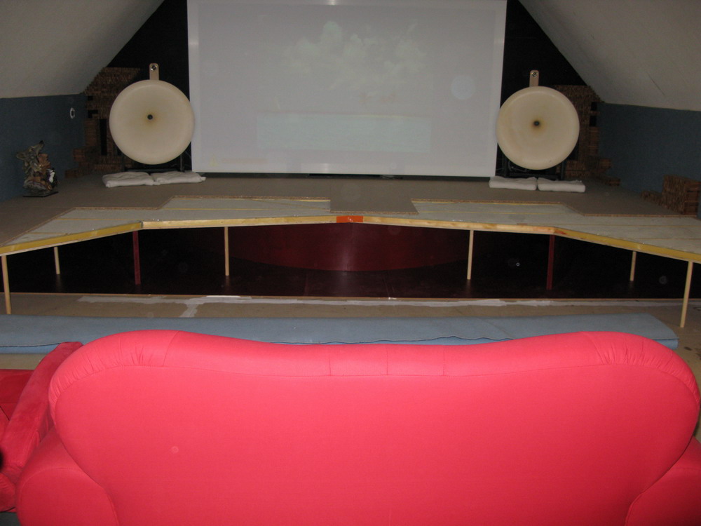

It looks like you need at least a couple of meters (possibly more than that) of free space between yourself and the horn?
Hello Markus,
For the last picture, the listening distance is less than 3 meters from the mouth and there is no audible artifacts due to that limited listening distance.
That's really surprising for me that here in France wher the living rroms are generally smaller than in most other countries there is many floor bass horns like this and that in countries where the mean living room is larger than in France there is none...

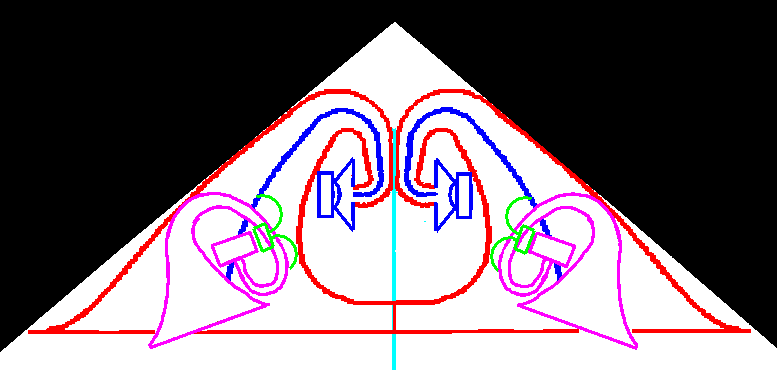

There is another solution more adapted to smaller living rooms which is the "stereophonic floor corner bass horn".
Here is a shematics of that one (bass horn in red color line, median wall of the horn in blue, purple = Western Electric 22A, Green = tweeter horn):
Depth from the corner 1.5 meter
Width of the mouth = 3 meters.
Best regards from Paris, France
Bass horns, if used below 100 Hz or so, have little directionality, so the distance from the mouth is not important, they will simply sound louder the closer you are to them.Oh, I have no doubt about that.
My concern was rather the limiting dimensions of my room.
If I'm forced to sit too close to the horn?

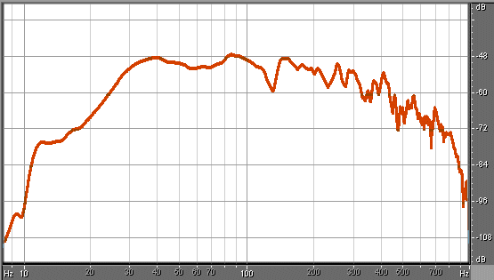

Hello,
The floor basshorns pictured are used without any problem with a low pass crossover set at 350Hz, some of them with an active correction are used until 450Hz.
Here attached a frequency response curve for a single channel of the bass horn seen in :
http://img209.imageshack.us/img209/7042/estrade31024x768qs8.jpg
alos the pulse response (PCM wav 2kHz) in text format.
