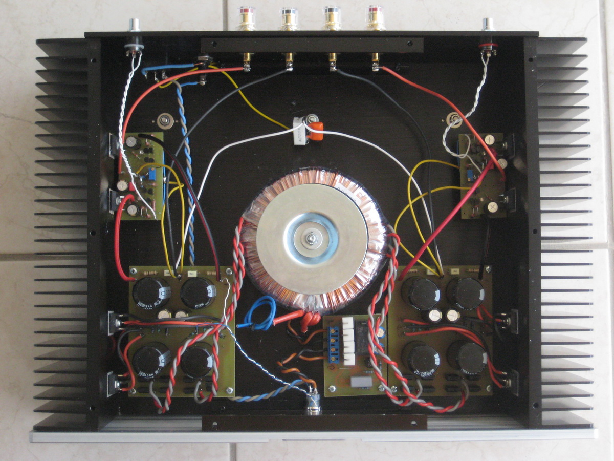

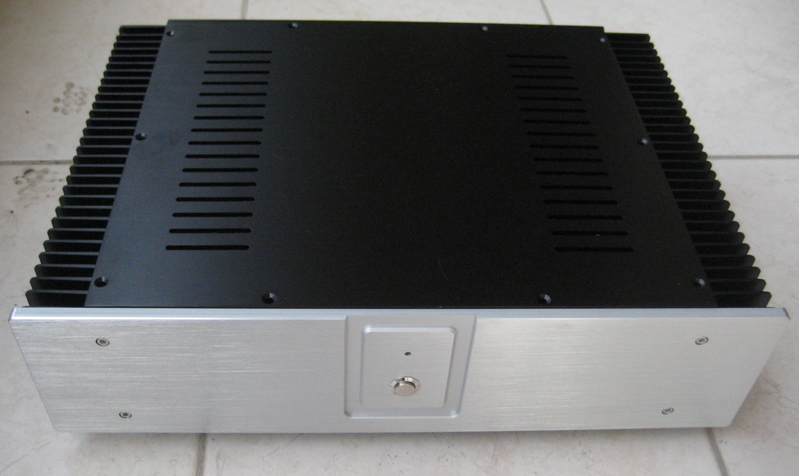

Well, my journey, with Cubie2, finally, reached its end. After much study, trials, frustration and hours of labor, I am proud to claim that I have built the finest amplifier I ever connected to my speakers. The amp is finished a couple of weeks ago, but I wanted to give it an extensive testing (both laboratory and listening) before closing the case and presenting my findings her.
So, as I wrote previously (although in a semi-final state), I'm completely surprised from the final result. The sound is amazingly fantastic: extremely analytical without being clinical, voices are natural and warm without any sign of sibilance, instruments separation is exemplary, while bass is deep and firm. In all, I'm deeply satisfied from my new amp and I'm seeking for free time to sit down and enjoy it.
Frequency response is -0.1 dB at 20 Hz and +0.2 dB at 20 kHz. Initially, gain was a little bit high at 22 dB (very limited range from the volume control of my preamp), so I had to reduce the value of Rb (zero feedback design - refer to schematic in post #225) from 150R to 120R to bring the gain to exactly 20 dB. With +/- 16.5 V supply, power output (at the beginning of clipping) is 8 W (on a 8 Ohm load). Bias current is set to 0.85 A (since I have plenty of heatsinking and temperature rise is minimal).

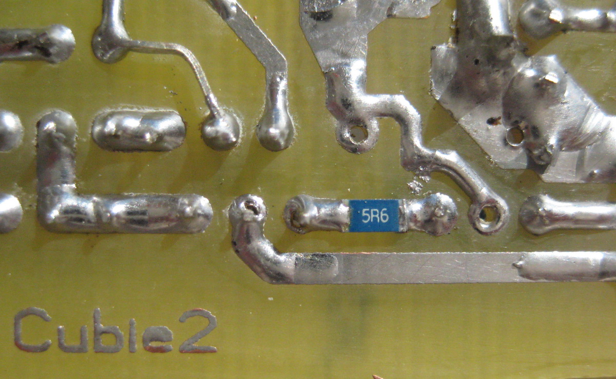

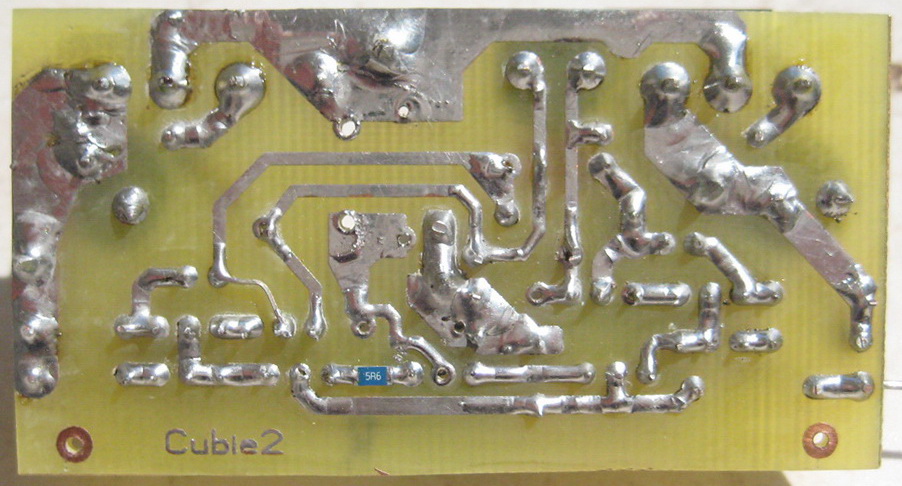

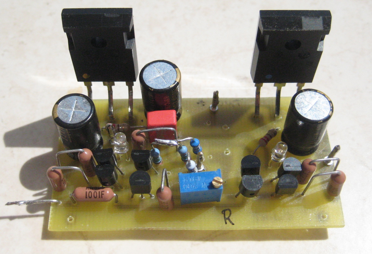

Below, I present a couple of pictures. On the PCB picture, please notice the 5R6 SMD resistor I have put on the source of 2SJ74. I made this, following the suggestion found elsewhere in this forum, in order to equalize the Yfs of J74 to K170 (since these are not truly complementary JFETs).
Juma, I would like to thank you once again, not only for providing such a beautiful design, but also, for all the help you gave to me through this journey. And, whenever you come to Athens again, I invite you to come to my place to listen your great amplifier on a great loudspeaker.

Can you point me were to find more info about the little resistor you talk about? I don't believe the resistor itself does anything in our case because of P1 in the schematic... How did you select / chose your Jfets? I mean, what are their Idds?

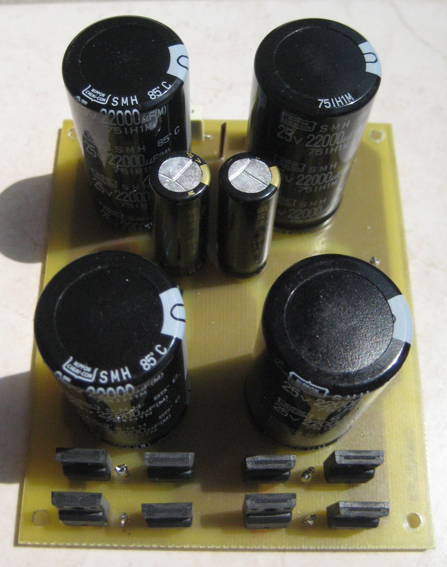

Yes, the power supply is sort of "dual mono". Generally, I prefer to separate power supplies for each channel, as the PS is part of the signal path itself. So, in my construction, the two power supplies only share the primary winding of the transformer.
I have found this information somewhere in the F5 thread (a very long thread) and somewhere in the following F5 headamp thread:
F5 Headamp ?
The idea of this is to degenerate the 2SJ74 in order to match its transconductance to that of the 2SK170. It's very easy to get a pair of matched Idss and measure the Yfs at a certain point. You will find out that there is a substantial discrepancy. Of course, you could use whatever you have in hand, but with a matched Yfs pair the 2nd order harmonic distortion is reduced.
As a rule of thumb, you chose a 2SJ74 with an Idss approximately 20% higher than that of the 2SK170 and you add a 5 Ohm degeneration resistor on the source of J74. And that's not a joke, because I have checked it myself. The K170 I used have an Idss of ca. 8.5 mA and the J74s are ca. 10 mA.
