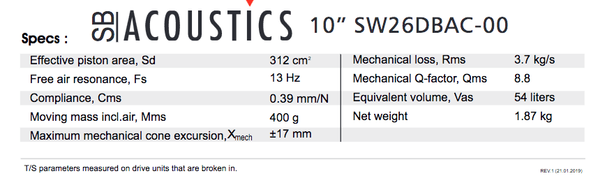

An aluminum cone PR may transfer heat faster than a paper cone.Another side benefit is that it can be placed on its side with the PR firing down. The SBA 10" PR with 17mm Xmax looks good.
The aluminum cone SBA 10" SW26DBAC-00 PR has 400 grams Mms (14 oz, near a pound) of moving weight, about that of a small claw hammer head.
Mounting a PR horizontal is generally a bad idea, gravity will defeat linear response, and with a Vas of 54L, I'd expect it would sag considerably.
The paper cone SBA 10” SB29NRX-00 passive radiator is heavier (505g Mms) and looser (66L Vas).
Have you calculated their Fb in your box volume?

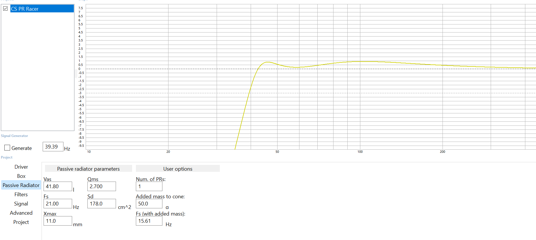

Update. Since the SBA racer PR has specs listed, I gave it a run on WinISD. Cab volume is 6L and SBA 50g weights for PR applied. No filters. Based on my limited understanding of such things, it looks like it hits the spot, would be good if someone of the knowing types would help scrutinise the results. I have attached the zip
The WinISD tabs for SPL and Xmax for both the active and PR look decent enough to my inexperienced eye. I don't really know how to read the other tabs. Output seems reasonable for a porch system. I think v3 will be getting skipped and straight onto v4, the 'Racer PR'

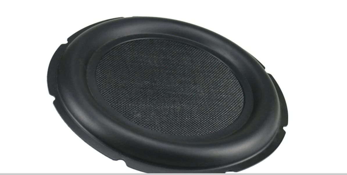

Edit, just ordered the SBA racer PR from Wagner. Hope they do better delivery wise this time. Also ordered some materials to DIY a flat racer type about 11"x4"

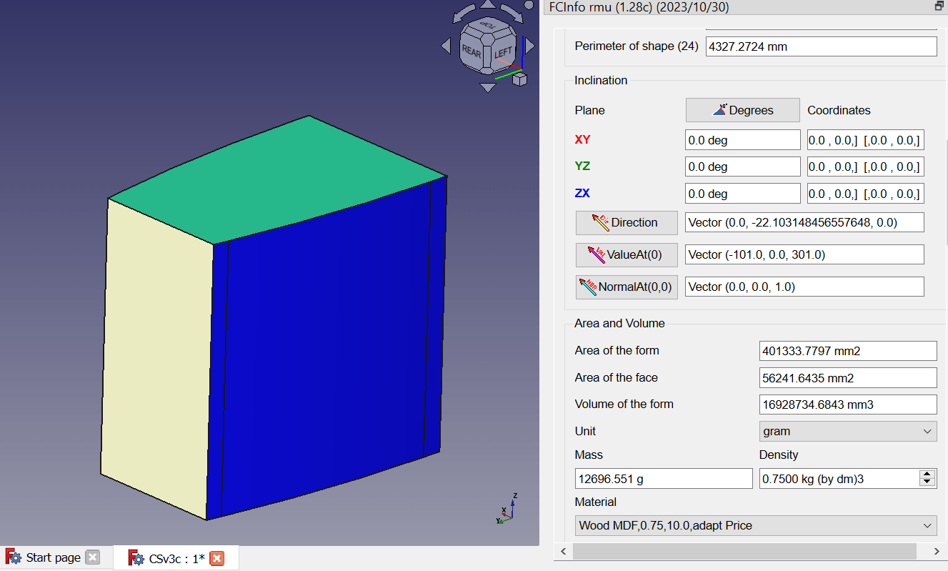

Randy,Cab volume is 6L
6 Liters is ~7.15 inches cubed, 366 cubic inches.
You have mentioned dual custom 8" or 10" PR units can fit on the sides, and the front width is greater than the side height, presumably at least 10".
I'd think you would eliminate the heat pipe since air blows right through the driver's spider, but even including it with the cabinets curves and volume occupied by the driver & PRs reducing volume, the interior dimensions look to be ~10" x10" x10", 1000 cubic inches, ~16.37 liters.
Anyway, you might want to check the cabinet volume.
Art
Art, the cab exterior constraints are 300mm x 300mm x 180mm. I am able to monitor volume and surface area in FreeCAD. But the flattest response seems to be 6L for the active driver. This lets me use the remaining space for structurals and electronics. I have to widen the cab a touch for the SBA racer PR and the new reported volume is 17 odd litres for the base body
