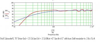

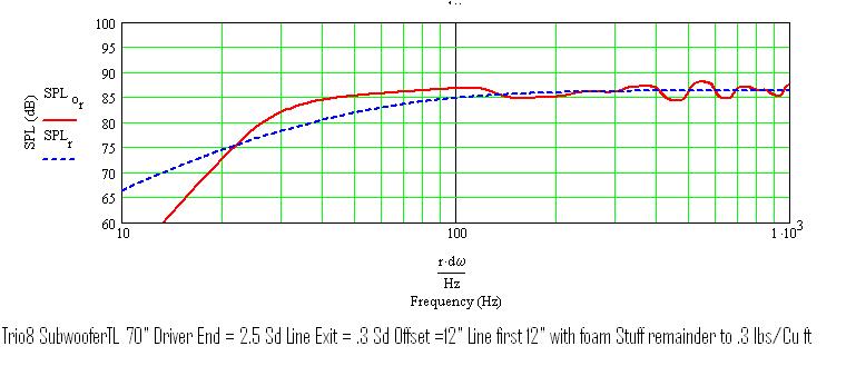

How about a TL?
TL simulations are pretty impressive for this driver.
F10 right at 20Hz
You can build that TL in > 50 liters, if you're careful:)
Mine are 21 X 12 X 10 with 72" length. I don't have Trio8's in them yet. But Soon:D
