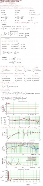

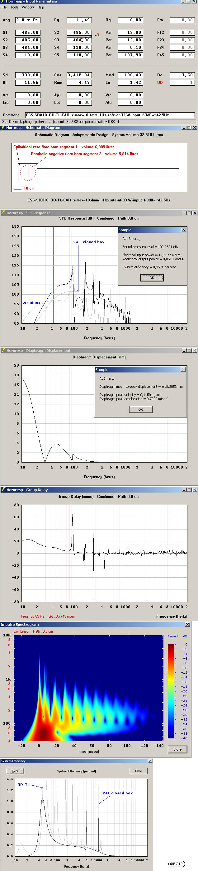

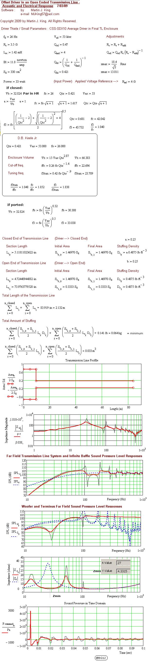

Take a look at the submitted picture and note: the more you fold the given example the worst performance is expected as a function of increasing number of folds 3(more than 3 bends).
Stuffing should be placed evenly in 2/3 of the TL line counted from the closed end.

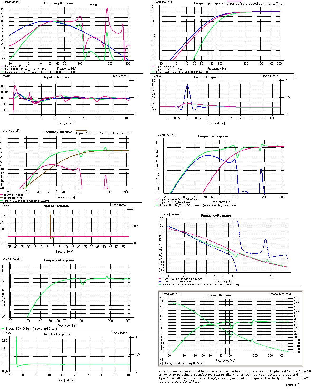

Thank you for posting the link of your IMO very interesting Hi-Fi Car project using the Alpair10 as the main speakers...

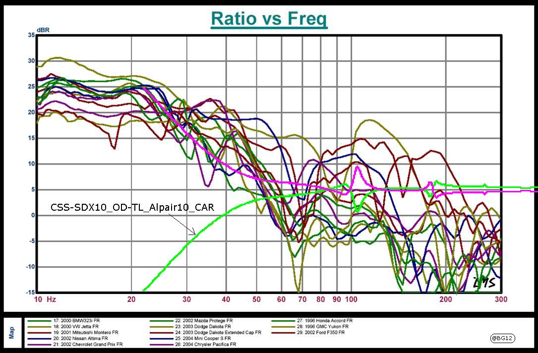

No offense at all if it's the first time you've posted here at Subwoofers: You have probably already noticed that this forum seem to have a misnomer name as many of the threads covers High SPL/High Power Subs needing at least a sophisticated multi-band parametric EQ and/ or High order HP/LP filter FR slopes sometimes exceeding 24 dB/octave...and are not like the normal target for a sub= to be a reproducer with a flat or slightly sloping FR but rather barely cover the mathematical mid-bass octave.
BTW,Here's a picture(submitted) I've picked up here at DIYaudio showing the 'passive' gain in a couple of different car cabins (I made an overlay with my suggestion including the Alpair10) and a link to Tom Nousaine's CabinGain.pdf :
http://www.nousaine.com/pdfs/Cabin Gain.pdf
