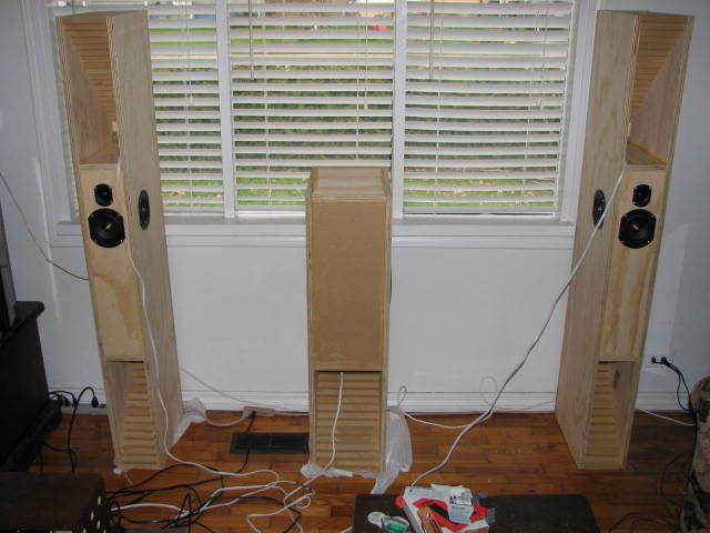

I believe our dear friend is indeed referring to these:
Hi Cal,
I like your boldness - just do it !
What did surprise me is that you've mounted the 2nd driver on the side of the enclosure instead of the rear. (not ideal in this design :clown: ) I suppose you lose the push - push mechanical argument but on the other hand you reduce the distance between the two drivers.
There have been arguments that the worst thing to do is stick two FR drivers on one baffle. Isn't your design more or less approaching a "one baffle for all" scenario? Apparently there'd be severe combing issues.
I presume your design could be used with FR125's instead of the WR + tweeter? Are you currently running the side driver "fullrange"?

Hi Bukem,
The side firing drivers seem to offer the most pleasing combination I tried. It allows for them to be pointed in or outward depending on the distance between the speakers and it acts like a mechanical BSC. Both drivers are running full with only a small cap and light padding on the tweet as I really hate taking a low sensitivity driver and sucking further life out of it. I couldn't even run it as a 2.5 way with both drivers on the front. It just didn't work. The Scottmoose designed enclosure goes a long way to making this a very enjoyable speaker. Combing is not a big issue at all as the side driver is so far off axis that it doesn't seem to have a detrimental effect. It's a big box but to get these drivers to really shine, you have to do something. I'm glad they finally found a home. For a while there I was beginning to wonder what all the fuss was about with them. Now I know.

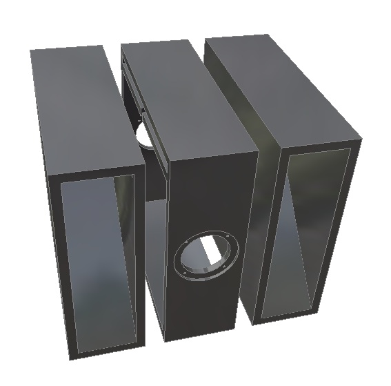

Cal,
Do you have any thoughts about sticking the mouth to the left and right of the driver? Or even to the side? (reducing the height of the enclosure by 2/3rd) ...More or less the idea like in the attached drawing. In this case I have positioned the 2nd driver at the back although a design with the driver on the side could be done as well. It's not a very good "copy" as for the length and path of the cavities but this can be done. I just want to know whether a reworked design like this might work.
Many thanks,
Bukem
Hi Bukem, I'm not the expert here. I rely on others knowledge and I do the subjective listening part.
If i were to do it, I would consider cutting the box in half rather than thirds. That way the construction would be easier as the exit from the compression chamber is in the center as it sits now and you basically be just folding it in two. If you were to try it your way, you'd need others to guide you through that.
The way I look at the current enclosure style is that it's a partial bass reflex enclosure + a horn. The slot + the channels running up to the horn throat look like a traditional vent to me. Perhaps it even mimics an aperiodic type of vent.
At the end of the vent is the horn. I presume the slope angle and width/depth of the horn is fixed.
So basically, what I would like to know, can I shape the vent part in any way I like and stick the horn bit at the end of it? If that's the case then I'll do a few proper designs.
Can't wait to find out ! :D
Bukem

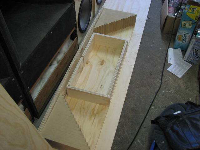

I would imagine you could reconfigure it as you wish. My thought was that the exit from the compression chamber is in the middle now so it would be rather easy to construct a side by side Calhoun. I wonder if the figure you posted might end up being a bit boxy?
Here's the shot again of the boards laid out before construction.
