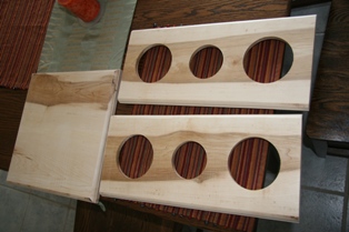

I agree...the X-over was simple to put together as well. I don't really have the best place for listening to music, but the speakers definitely throw a big soundstage with sounds appearing from beyond the boundaries of the speakers. I have just finished the front baffles made from solid maple with heartwood. I think they'll look very nice. I also made a table top from this wood as well to go on the re-built subwoofer that will be downfiring. My first time jointing two planks. I'm excited. I'm trying to find some ambrosia maple veneer right now, but only have only found one place in the states to ship it up. any suggestions from a veneer master such as yourself, RAW?

here's a pic of the new baffles and sub table-top

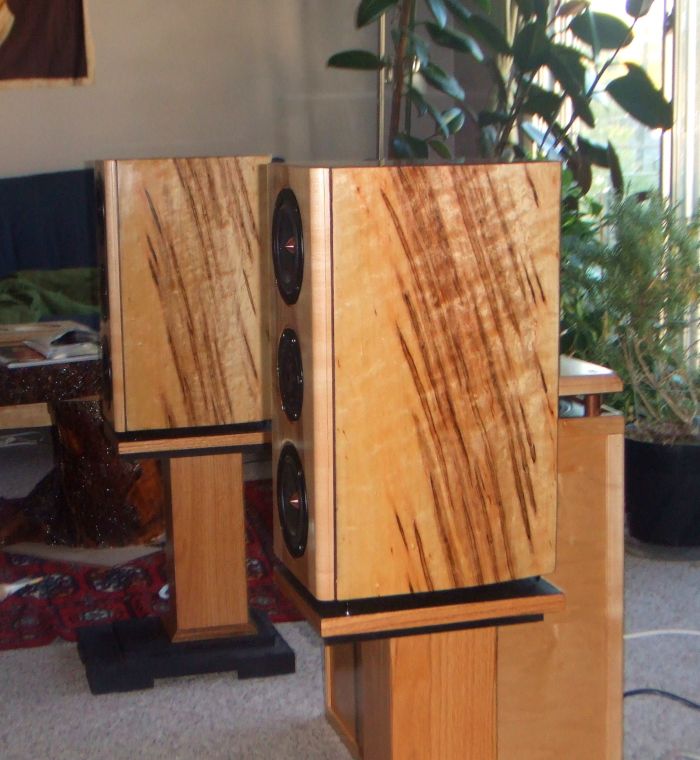

The Speakers are Finally Finished!!
Hey Folks,
I wanted to post the link to my flickr site again, since I have finally finished the speakers and subwoofer. I ended up using an ambrosia maple veneer, solid maple planks, and other maple woods, a bit of red oak veneer, and a bit of walnut for banding and trim. I think the end result is very rewarding. I believe that the finish may actually do justice to the quality of the sound of the kit. maybe. I just finished today, so I still am seeing all my mistakes.
http://www.flickr.com/photos/31487069@N00/sets/72157594487468580/
I also used the veneer glue that RAW suggested which worked fantastic. No comparison to using regular wood glue with the oak for the previous speakers that I built. I built the subwoofer as an upward firing design with a table top separated by copper plumbing couplers. The reason I made the sub top firing is to help reduce the transient vibrations and floor resonances, since i still live in an apartment. The bottom of the sub is very well reinforced, and the sub is sitting on a cement block separated by foam strips, all to help reduce the amount of vibrations that get transferred directly to the skull of my downstairs neighbor. I believe I am still making enemies considering the majority of my woodworking was done in my apartment!!
Anyways, Just wanted to say once again, thanks to everyone who posted and offered advice, and also a big thanks to Bob for everything.
please let me know what you all think of the finished product. and, also, if you are in the Edmonton neighborhood and would like to have a listen, just send a message.
