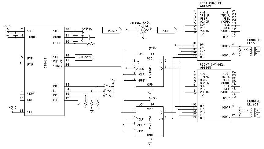

It will work. My only worry is metastability - make sure that whenever RECLOCK goes high, the SCK/FSYNC/DATA lines are *not* transitioning.cathode_leak said:Assuming I intime will get a sync clock (VCXO) for the DAC one way or the other, it will need FSYNC to syncronize, and pickup incoming clock on the line marked "RECLOCK" in the schematic, right? displayed is the interface I2S->DAC, the I2S line runs straight from the CS8412 reciever chip. Any obvious wrongs?
I'd use SCK instead of FSYNC to drive the PLL; it lets you run a higher phase detector frequency without running into any clock phase ambiguity. Your PLL should be 1:1, and it will give you a new SCLK, which I'll call nSCK.
Don't resample the incoming SCK; throw it out.
I2S samples data/frame sync on the rising edge, which is what you're getting from nSCK. So use nSCK to drive your (rising-edge triggered) flip-flops. Now since you've introduced a half-clock delay by resampling, use an inverter to invert nSCK - this is your new SCK for your DAC.
Thanks very much for your replies GM. I'll get rid of the SCK and replace it with the clean one 🙂 Regarding the metastability issue, I've heard comments that it can be overcome by wiring two flipflops in series?
You can use two flip-flops; drive the first flip-flop and your DAC with nSCK, and drive the second flip-flip with /nSCK. But it's not really needed. Just make sure that your retimed nSCK signal has a close enough phase to the original SCK.cathode_leak said:Thanks very much for your replies GM. I'll get rid of the SCK and replace it with the clean one 🙂 Regarding the metastability issue, I've heard comments that it can be overcome by wiring two flipflops in series?
If the CS8412 is putting out a stable SCK and your PLL is locked, then the recovered nSCK should be in phase, so sampling FS/data on the rising edge of nSCK should be fine. In reality there will be a bit of phase lag on nSCK and there will be a bit of phase jitter on SCK, but it shouldn't be any more than a few degrees. So everything should work OK.
If the CS8412's PLL is unlocked or your PLL is unlocked, then the SCK and nSCK signals won't be aligned. When this happens, god knows what sound your DAC will put out. It might be worth taking the unlock signals from the 8412 and PLL, and using them to mute/unmute the DACs you're using if there's no SPDIF signal.
gmarsh said:I'd use SCK instead of FSYNC to drive the PLL; it lets you run a higher phase detector frequency without running into any clock phase ambiguity. Your PLL should be 1:1, and it will give you a new SCLK, which I'll call nSCK.
You mean like this? Oh, and the nSCK inverter... should it be an unbuffered inverter, or a buffered one (eg. HC or HCU)?

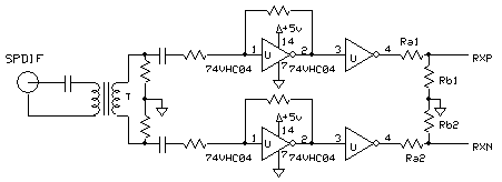

This one goes to Jocko, regarding the SPDIF input..
Would it be a solution if I use a buffered inverter like a VHC04, followed by a resistor to gnd (on both signals) before entering the CS8412 inputs? I might be way off here, but I'm thinking that the energy from the schmitt-trigger could be sent via the resistors to ground....?
Edit: added a schematic...
I am thinking that if Ra>Rb, the energy will have to follow Rb...
Re-edit: I don't need the inverter buffered if Ra>Rb... do I?
Jocko Homo said:The inverter will drive the RX chip directly, as it is designed to work off of SPDIF levels. But your circuit will work much better if you isolate the Schmitt trigger from the line. Read up on them, and key in on the fact that they are a regenerative circuit. That energy has to go somewhere, and guess where.

Jocko: edit to my last post: Would the Ra resistors be obsolete if the inverter is buffered?
