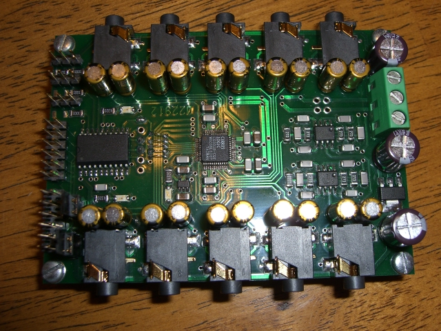

Hi Guys,
Just finished testing my CS3318 board. All I can say is Wow, very nice sounding. Clean and precise. Thanks for the inspiration jan and linuxworks. Now back to my next project.
Best Regards,
Al
