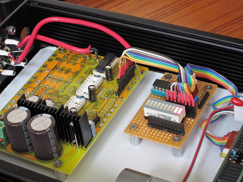

you are free to download the source for arduino controllers and adapt it to the pga board. there is pga code already in the volu-master code base. see www.amb.org/audio/lcduino and the software download link for the zipfile. you need to use arduino (free devel software) instead of their controller. but where their controller touches the pga (chipsel, clock, data; the spi pins) you use the lcduino and its code, instead.
you can then change all the strings to spanish inside the arduino ide, rebuild the hex and download it. but again, its only for aduino (328) chips, so you would have to stop using the ebay lcd controller part and use only the pga board part.
pic of a 3-PGA ebay board that I used for 1 chip, in this build.
a small glue board was made (i2c port expander) so that my controller would be able to big-bang the needed SPI for the pga chip, but use i2c for it. it was just that chip and some wiring to connect the pga 'engine' board with the lcduino controller. the code is already in place in the v1.0 base for pga-over-i2c.
