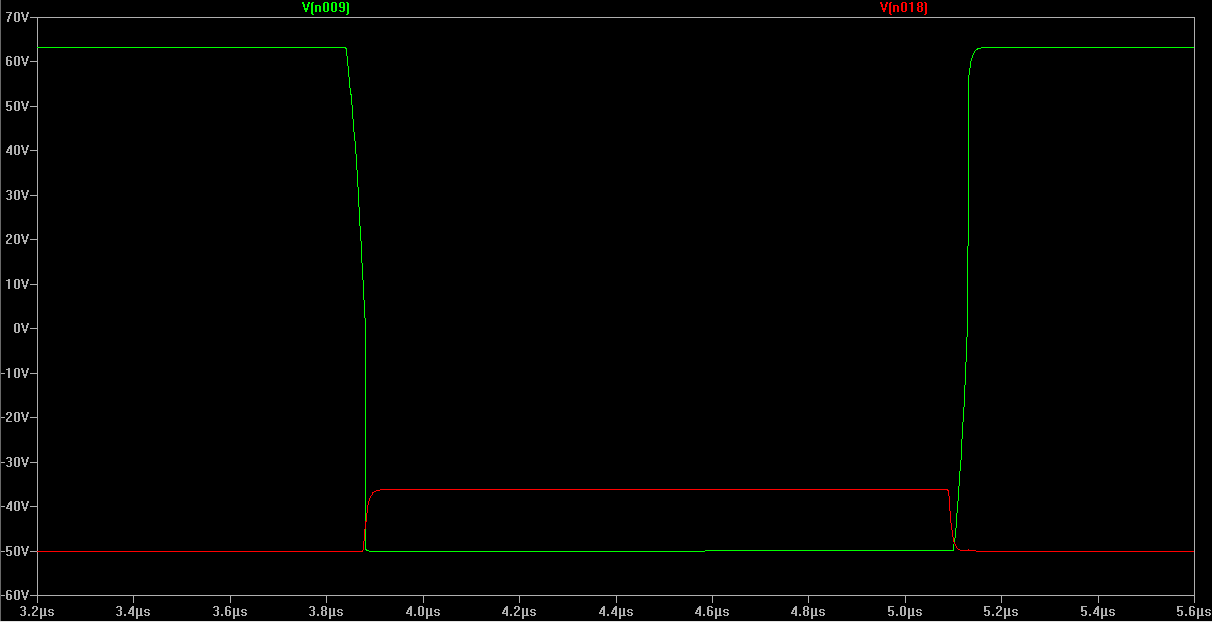

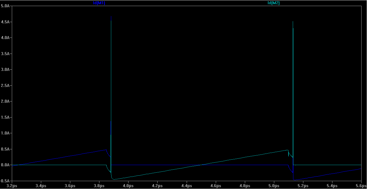

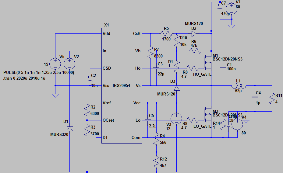

Hello, I'm new in this forum, and sorry for my poor english:) I have a trouble with this gate driver, something's wrong during high side mosfet OFF, the low side mosfet is ON earlier than high side off. On the simulation there's a PULSE GENERATOR because this crunch amp has own ic pwm gen at 0-15V voltage level, and the vdd voltage for irs will be the same voltage. Maybe someone knows what's the problem with that?

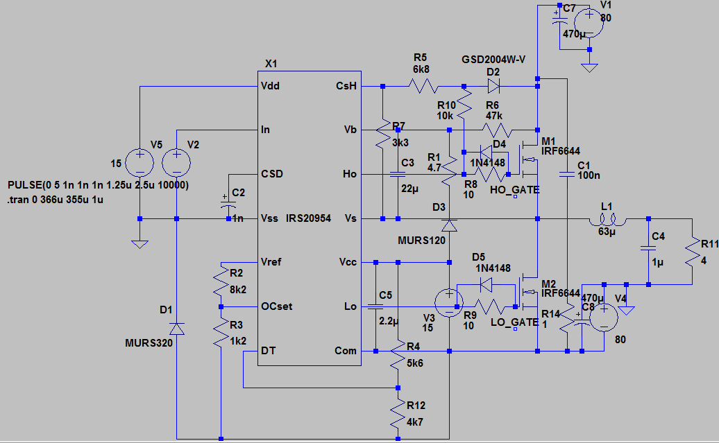

Hello, finally I've got some new info's. I removed gate diodes, recalculated current sensing for high side mosfet and for the low side (both 24A trip), but it doesn't helped me. I found out that mosfets with higher Rdson (125mohm in this simulation) working so much better but I don't know why is that? Any suggestion? Setting deadtime by tying DT pin to COM hasn't got positive effect on low side on, it working only on high side on.
