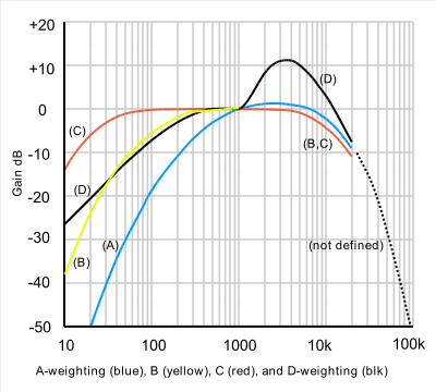

That's at rated power using a forgiving weighting curve. The lowest power model is 250 (or more?) watts per channel into 8 ohms. Best guess is the noise into the room will be at least in the high/mid 30 decibels at one meter, likely more depending contribution of source electronics, tweeter frequency response and how generous A-weighting is towards that 100 dB S/N figure.
