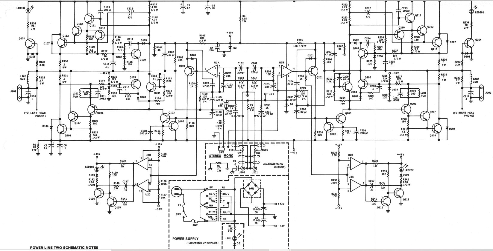

The amp powered up ok with a DBT, and also directly to the mains. However, as soon as I attached my 8 ohm dummy load, I'm seeing pretty significant oscillation in the left channel. I assume that I may be seeing the underlying cause of the original damage. I need more experience solving oscillation issues, so it looks like I have my opportunity. I've attached a portion of the schematic showing the left channel amplifier section. Any direction as to where to start would be appreciated.

A different tack is to look at the 220Hz oscillation and how it presents in various parts of the circuit. [Be sure to use x10 scope probes to ensure low capacitance loading from the probe.] In particular, look at how feedback from the output appears at U1A, and at either side of C103. What is opamp pin 1 amplitude peak-to-peak vs. output at PA output?
Bias to U1A + input arrives via R104 which is bootstrapped from C103. This is relatively unusual, and may make the circuit more susceptible to mischief. What is behavior at U1A output, pin 1. Does the oscillation appear on the + input, U1A pin 3 ? Does the input gain control have any effect on oscillation? Try shorting pin 3 to ground. Any change?
BTW, what opamp type is U1?

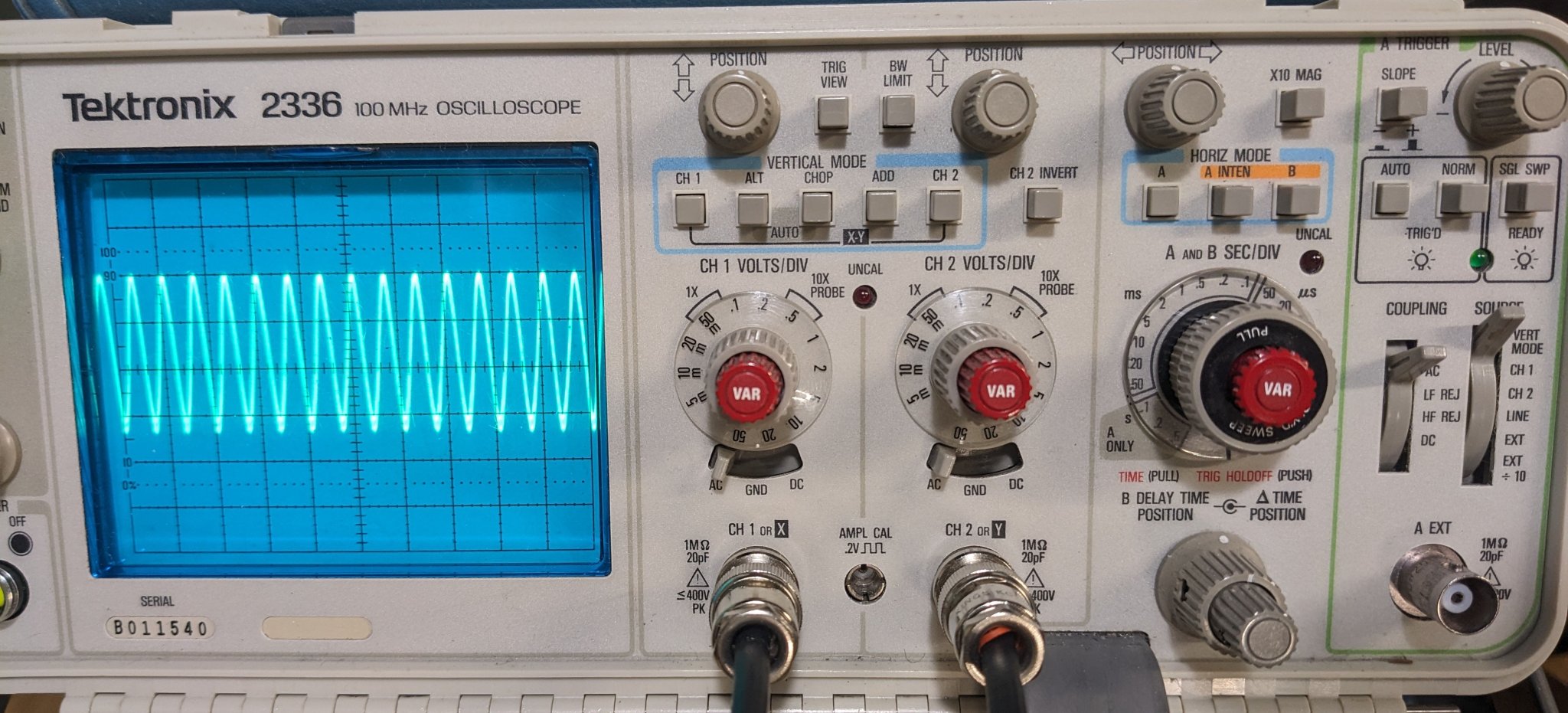

Now with my 8 ohm dummy load connected, no input signal, and the amp being powered through my DBT using a 100W bulb, I'm seeing the following on my scope:
In case it isn't clear from the photo, the time base is .05µs. And while I may have only had Ch1 selected in the shot, it's the same for both channels. I'm also seeing something similar, though not exactly the same with no load connected.
I estimate the oscillation frequency is just under 30MHz--- agree?
That's certainly an RF oscillation. Is the 220Hz oscillation gone? There's a 0.1uF (C116) across the speaker terminals, and 30MHz is probably above its series self-resonance.

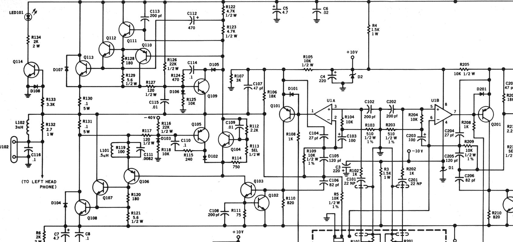

The upper output stage is a NPN triple emitter (3EF) follower and the lower is double NPN emitter follower driven by a PNP driver in local complementary feedback arrangement. The former has a reputation for being oscillation prone, as do complementary feedback pairs. The Q106/Q107 cascade adds further complexity.
I notice you're using coax cables connecting the scope. I recommend a x10 probe and using the shortest ground clip that's manageable for probing. Poke around in the output stages, looking for spots where oscillation is largest for insight to oscillation path, and especially on the supply rails. This is a tough problem. Look at bypassing. Note that C4 is 0.02uF vs. C6 is 0.1uF. Where are they positioned? Ideally near the output leads, with short leads to ground. Use of "base stopper" resistors is a common practice to avoid instability. Look at recommendations from Bob Cordell.

If the electrolytic bypass caps have gone bad, you can certainly pick up an RF oscillation. Collector of Q112/13 and emitters of Q107/08 need to be low impedance from DC to light - especially with this output stage. If they are running Q113 and 108 fully class B in cutoff, their drivers see a horrible capacitive load.

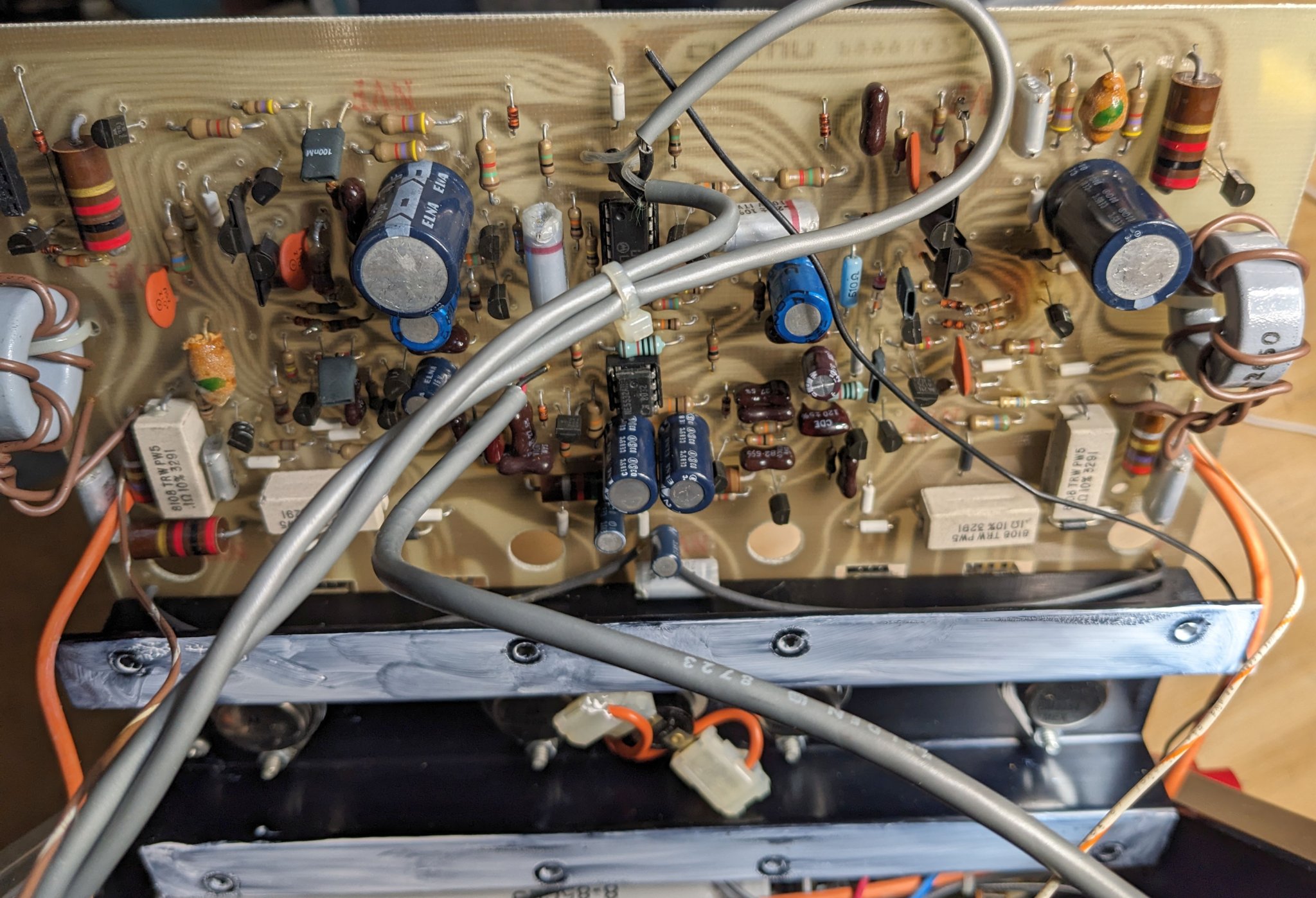

I've attached a photo of the main board. One challenge with this amp is that there are no component ID marking on the board and no image in the service manual showing component locations, making it tedious to go back and forth from foil side to component side trying to figure out what's what.
