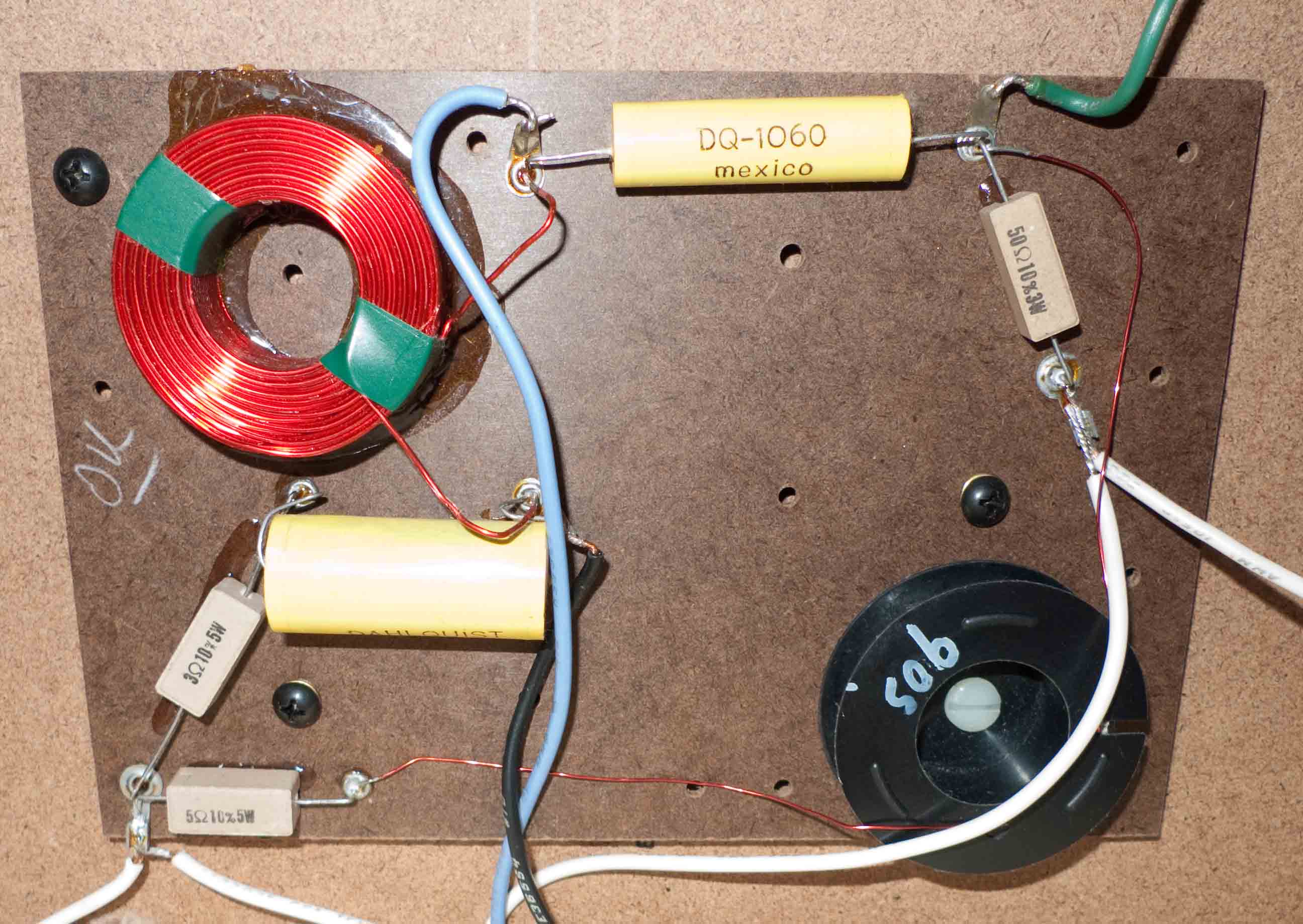

The M-905s are 2-way speakers, so the XO design is pretty simple (see attached photo) and contain only 4 caps total. The cap values are 10k and 5k mF.

Photo failed to attach to original post, here it is...
Well, those caps are not electrolytic caps( they will not dry out). so I would not touch that crossover.leave it original!. most the time when you change caps in crossover it is because they have electrolytic caps that with time they start leaking and dry out, those are the ones you change!. in my opinion I would leave them original.
I agree, there is not much to be done here. You could bypass those capacitors (the yellow things) with some .22uf film and foil polypropylene caps from parts express. The existing caps are film type, not electrolytic which would really benefit from upgrading. It is possible that those caps are polyester, though, and could potentially benefit slightly from upgrading to polypropylene caps. Dahlquist fanatics would probably know if that was the case. Find another project, no huge gains here from tampering, in my opinion.
By the way, those caps are not "10k and 5k"... the smaller one is 6uf.

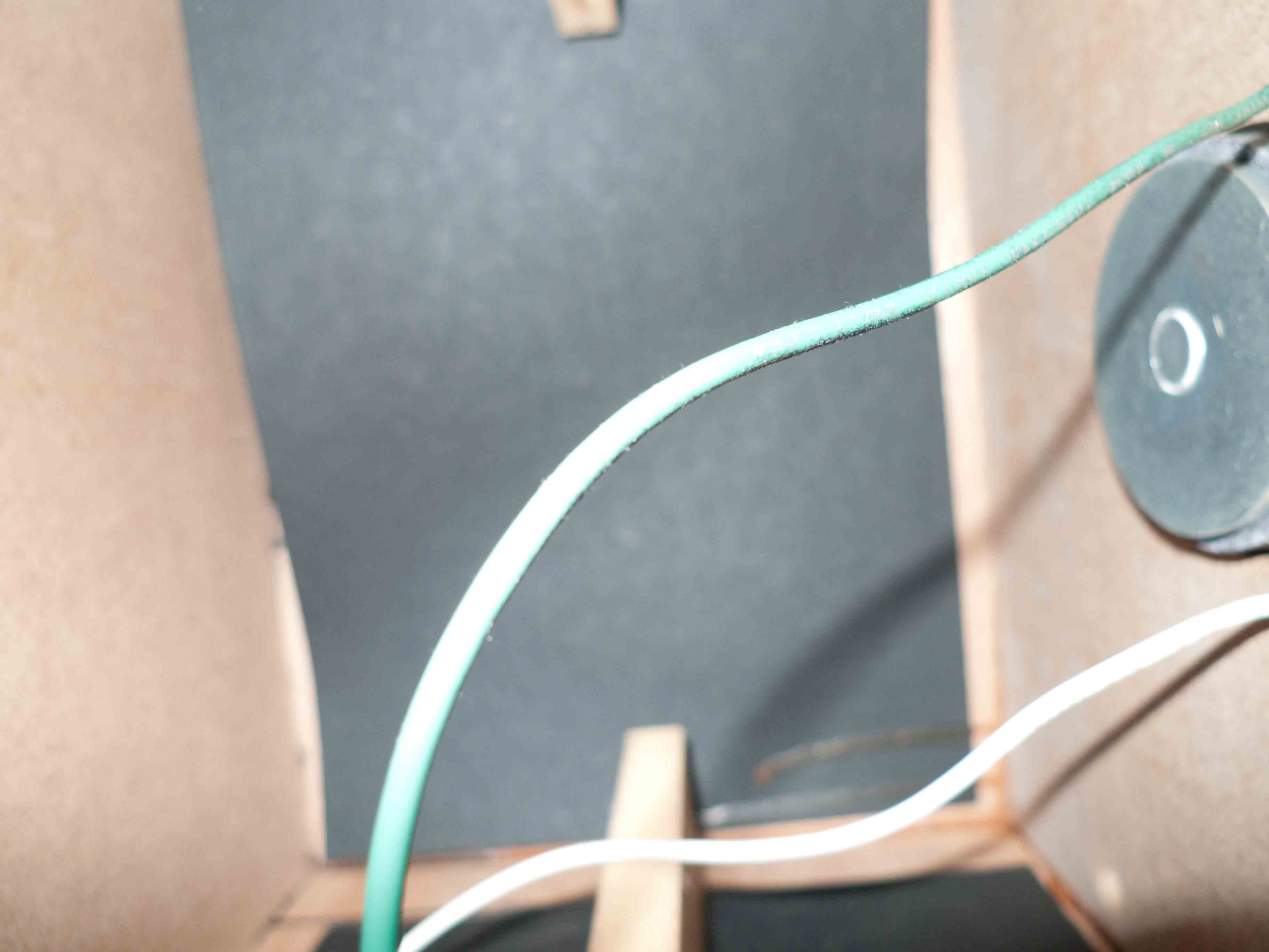

Perhaps somewhere that would be of some benefit to improve is the cabinet. Can you post some photos of that? How thick is the material? How much bracing is there? Does it sound hollow when you knock on the side with your knuckle?
You can always cut some dowels and insert them into the cabinet to improve bracing, as well you can always add some more damping material. These are simple and cheap tasks.

This is your best advice and the adding of extra damping material if what is there is degraded (or non-existent)

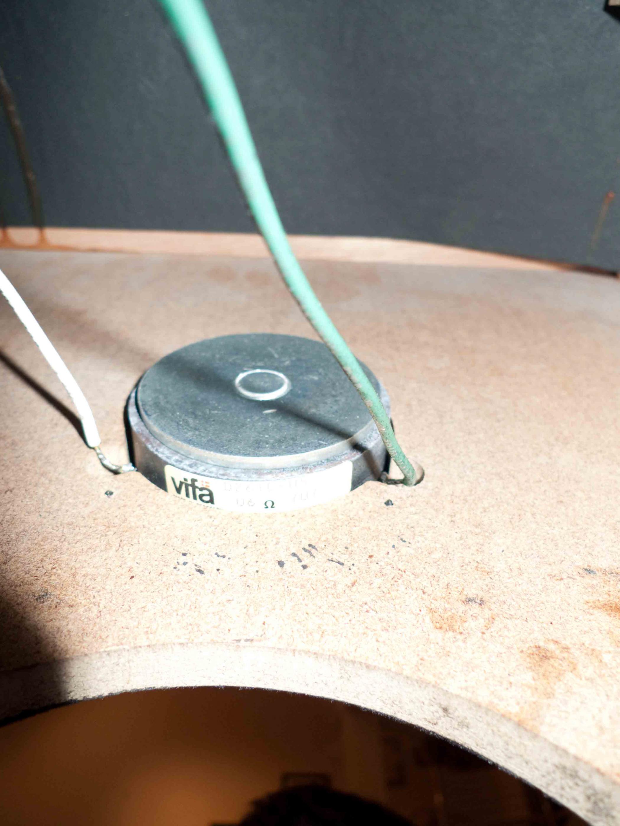

- One of you asked about the drivers — the M905 has Vifa drivers, 8” woofer and 1” tweeter. They’re in excellent shape. Rubber surrounds on the woofers so no worries there. See attached pics.

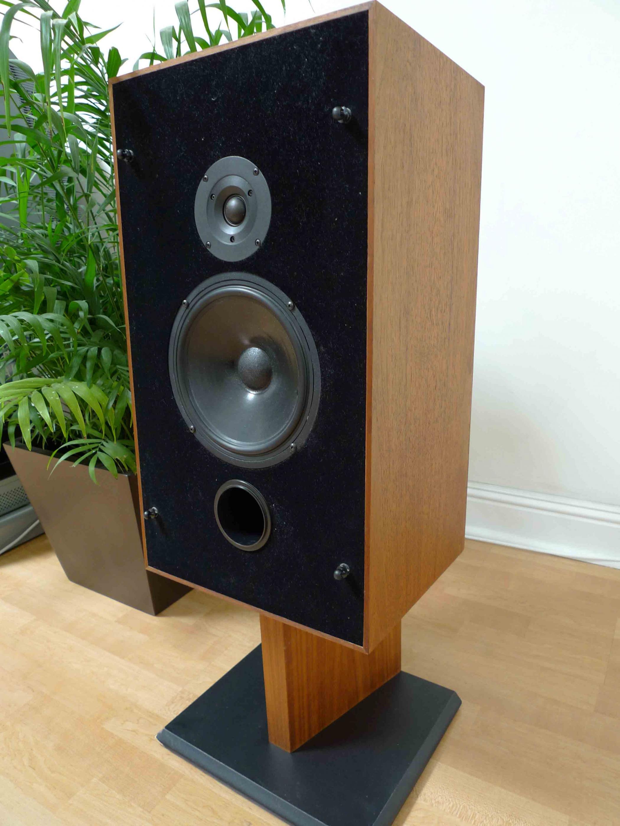

- As for the cabinets, they have a nice walnut veneer over I’m not sure what base material (MDF? some kind of ply?) — Perhaps one of you can tell by looking at the additional pics I’ve attached? They don’t sound particularly hollow when I rap on the them with a knuckle, but neither is the sound completely “dead.” Walls are ~1/2” thick and there is some bracing inside (2 vertically placed dowels) and also some ~2” thick white material which looks to me like fiberglass insulation positioned to cover the entire rear wall of the speaker (I pulled it out of the way when I took the photos so it’s not in the pics).

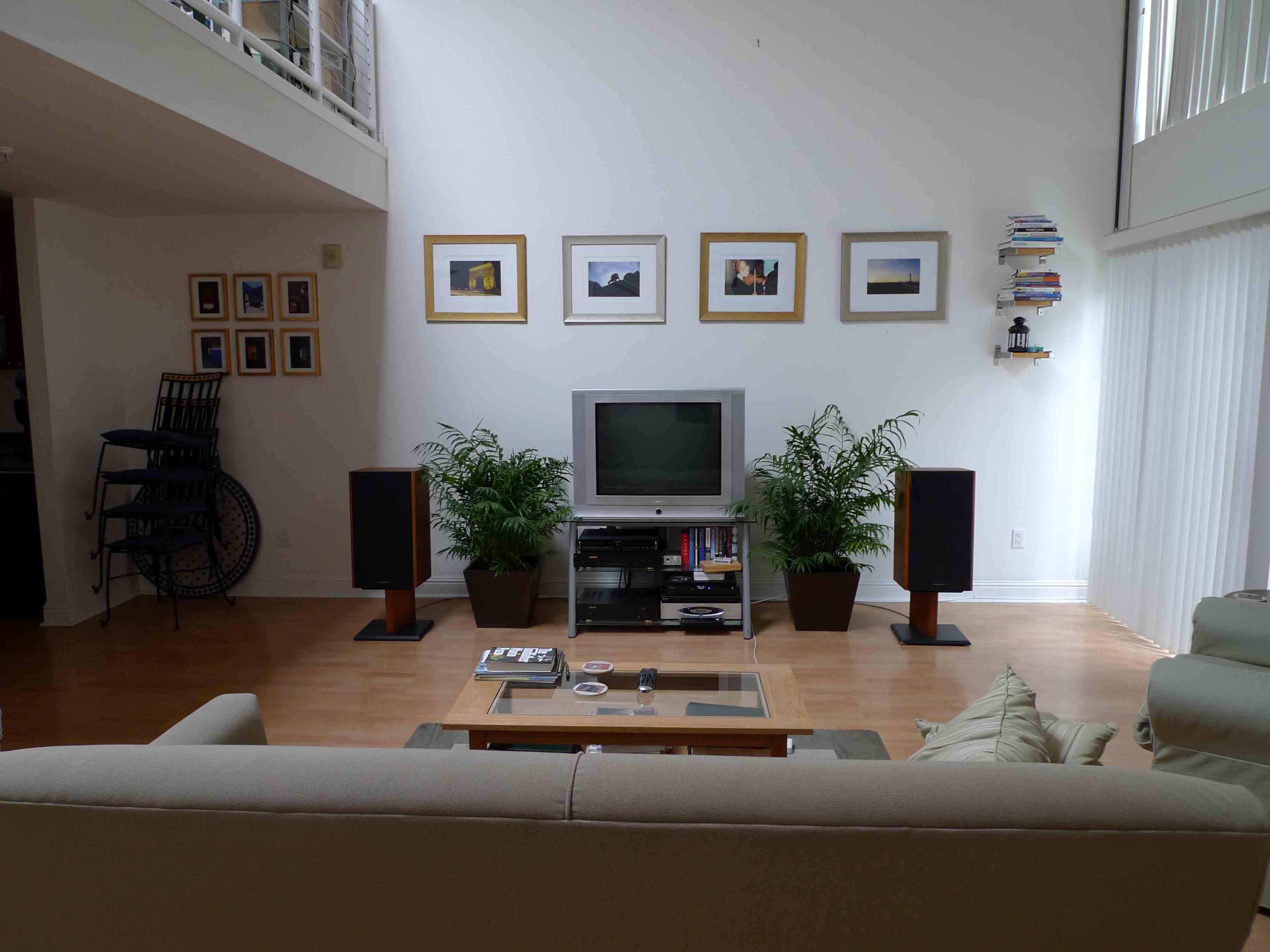

- Any suggestions for improving the way the speakers sit on the hardwood floor? The floor actually is uneven in places so the speaker stands are not resting perfectly flat on all four corners. Problem?

Sounds like adding a few more braces and some extra stuffing would help. It's cheap and simple. If you're still not satisfied, then I would look at finding a different speaker that you like better. The drivers and crossover look good, the crossover design may not be optimal (who knows), but without some fancy measuring equipment you're SOL for a crossover redesign.
By the way, that's a real nice home you have there.Good luck with your project.

Thanks DcibeL. The place is great, should last us until it's time to have kids anyway!

A brace from the weakest point between the tweeter and woofer to the rear panel is probably the most effective single shot.
Some feet -- two in front and one center in rear -- might work for stabilizing them? Maybe even make them adjustable if you want to play with the tilt and height. The height is important, as already stated.
For more image depth, pull them away from the front wall (and perhaps also move your listening position closer).

Room is nice, can't see the back wall but a few bass traps may work to improve over-all sound.
