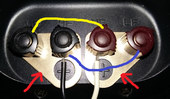

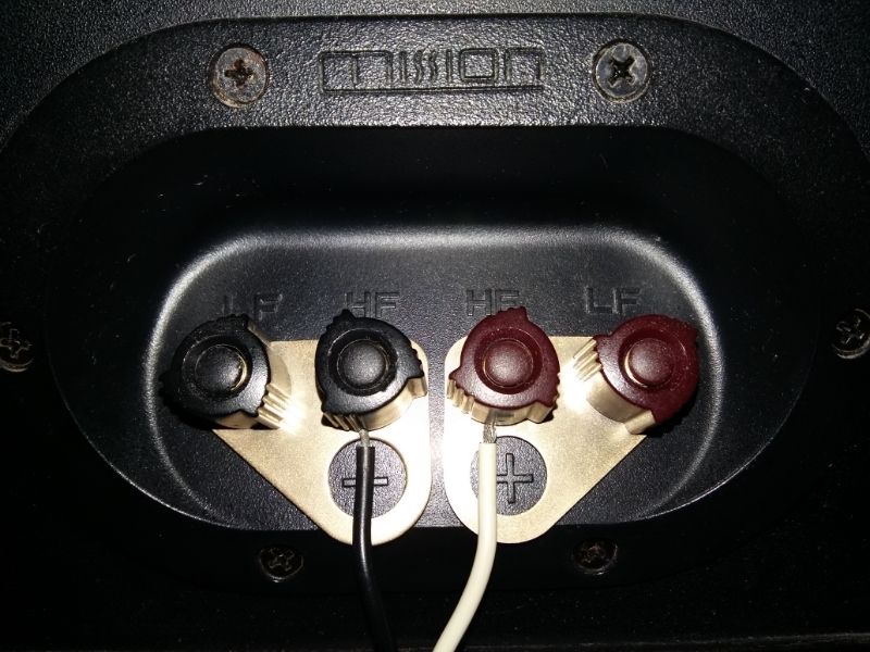

I have to open up the speaker and rewire the tweeter ? This is how I hooked up my speaker.

Those plates are accessible from the outside. If you can remove them, then add a jumper from the second post to the fourth and another from the first to the third. Then connect to the external speaker wires to the same places (second and third posts).

You could also remove the jumpers and connect the tweeter -ve to the woofer +ve (and vice versa with jumper wires to test whether inverting the phase fixes the issue!
The metal jumpers (arrowed) MUST be removed. Also as a santity check I'd make sure that with the jumpers removed that there is no continuity between the HF and LF +ve terminals, and similary with the -ve terminals. Any short will likely blow the output stage of your amp.
Certainly it looks like the speakers were configured to be able to be bi-wired.
