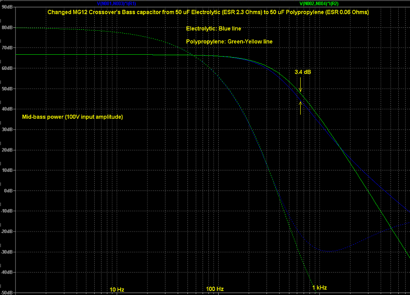

Gootee, if you are concerned about the response, get your hands on an equaliser and play around with that. If you change the crossover you will want to ensure the drivers stay in phase. Since the crossover has few components, almost any changes you make will affect this with little recourse to bring the other driver into line.
If you redesign the crossover then you will obviate these issues, but redesigning is the can of worms unless you do this kind of thing for fun.
As it stands, individual component replacement should be fairly straightforward. Why not try replacing the 33u and 0u1 with a single poly cap. If it sounds bright then try some series resistance. The woofer capacitor should be easier to replace. You can use resistance here too if it doesn't sound right.

Gootee, your last posts about 2 years prior to the above post indicatea you were still vasilating on whether or not to do the xover upgrade and thus, there's been no closure to your OP. Any updates on whether or not you went thru with an upgrade? If so, your listening and/or measuring impressions please?
I also question your OP statement that your goal was the most-accurate reproduction of the source material.
Judging from your concerns about cap ESR and coil DCR changes, I'd say your goal was to not alter the original voicing of the speaker that could result from those changes. Was that then based on an assumption that the original voicing was the most-accurate reproduction of the source material?
