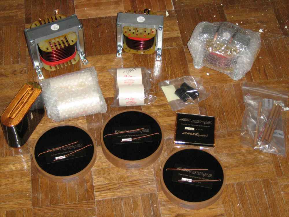

Do NOT use sterling silver for connections or wiring. Sounds awful.
If you have never built speakers or designed speakers, I'd spend some time looking at some of the more sophisticated build-outs and designs on these pages... there is much much more to a good sounding speaker than aesthetic design of the cabinet.

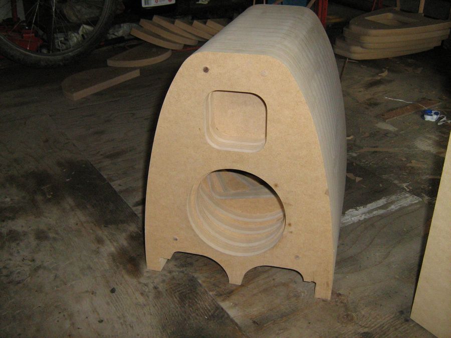

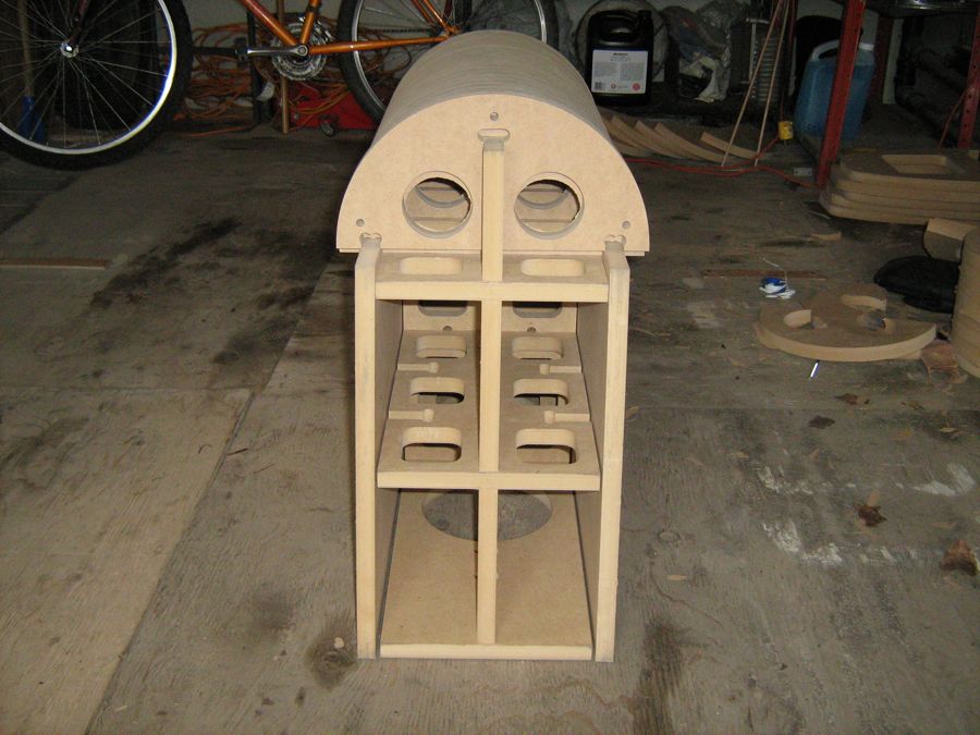

My home is over the top, eccentric to the point of gaudy, and so will my speakers be. When I am done, these speakers will have few peers under $100,000,00.
Really? I have never heard any speakers that even modestly approach that cost, I would bet that most of us on this forum haven't either. You run with a rich crowd. Good luck with that.
Arrogant, you betsha, that's my middle name. '

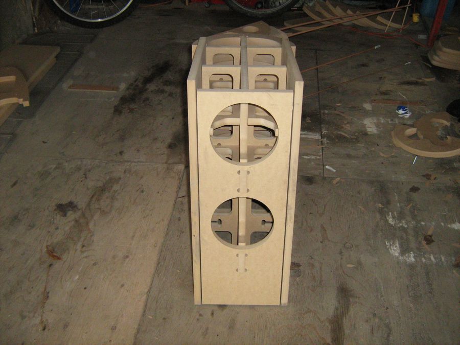

Thanks for the pictures.
Very nice work on the lamination of the speakers, looks good and I bet they weigh a ton!
Ron
Thank you Ron
1) Opps. Why should I NOT have screwed the T&G over the joists, which I did?. Everything else was scrutinized, thank you.
2) The boxes are only loosely put together. The throat of the mid section is too cylindrical. We need to drastically change that. This needs to be done without impedeing on the tweeter's closed chamber. If we put the tweeter in the mid's chamber we will need to cover it in an SBS rubber membrane?, I think. The volume for the mid's as per our original LEAP program calls for a minimum of 2.35 liters with 50% fill for a Q of 0.577 (Bessel alignment), or 2.7 liters 100% fill for a best-transient alignment with Q=0.5. But people have stated that the Accuton drivers are too dry sounding this way. So you see, we are still a long ways away. Boxes will be made, tested, and potentially tossed. I do not want to tell you what it costs to use a CNC machine for half a day, and then put those pieces at the back of the shop. Yikes.
I have still not accurately measured all of the drivers, in chamber, with my amps. All of this may have to change!!!!. The journey, remember the journey.

I agree, Sterling Silver has too many impurities. If we where to use it, which is still up in the air, we would need to purify it. This is not a fun process. We would need to heat the SS in a non-boraxed crucible, carefully skim off the top, and subsequently discard the crucible. You see, the borax stops anything from sticking to the crucible, but we want stuff to stick, this often is the stuff we don't want, the impurities. Carefull weight measurements of all the discarded stuff needs to be made to ensure a high purity silver content. I will be happy with 99.99. As well, zero crystal silver is achieved by cooling the silver immediately after application. This means every connection needs someone with an air source to cool the silver now.
I am curious at your caution about silver. Silver is a better conductor of an electrical signal then copper. Silver oxide conducts electricity, where copper's does not. Surely this would be better then solder which is tin?.
I am not sure the observations regarding silver coated copper can apply to pure 7N zero crystal UPOCC silver, if that is where your observations come from ( I am now assuming, sorry). My thoughts; silver has a slightly lower resistance, therefore the signal will travel ever so slightly more quickly, as well higher frequencies travel on the outer skin (of a wire) where lower frequencies travel more to the center. If the thickness of the silver plating is not sufficient, the higher frequencies will arive, there will be a break, and then the rest arrives. For this reason pure Silver will be used everywhere. The only caution I have for myself is that all of the crossover components are copper. It I am not happy, and if I do not get goosebumps, then that too will need to be changed. This project may be another year away. The journey.
