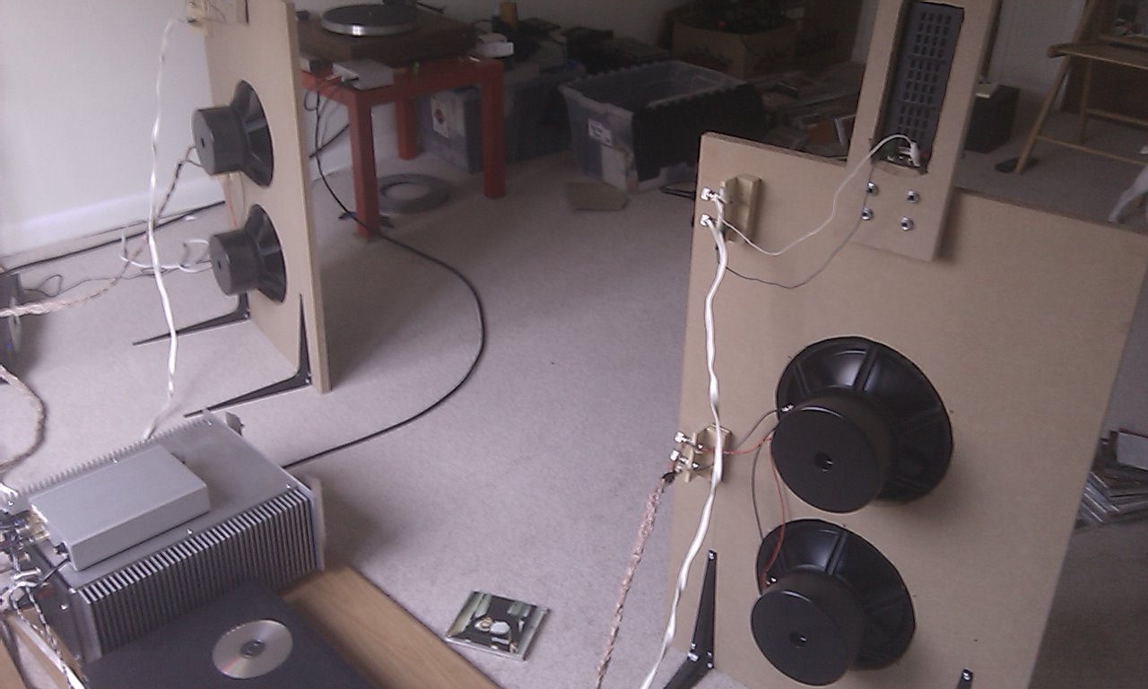

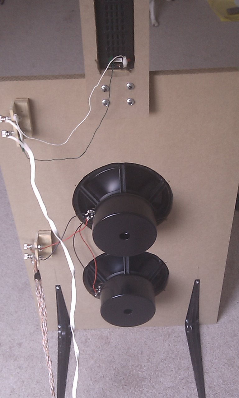

I've been noodling around with the B&G Neo8 PDR and can say it's a great sounding tweeter. Not harsh or too soft. Right now, it's being used without the suggested notch filter at 12khz.
Using it in a 2-way open-baffle. See photos.
It's crossed over around 650hz. B&G specs says it can go down to 300hz, but didn't want to push it. The woofers are 12" Dayton aluminium drivers (discontinued). Daytons are playing at their upper-end of capability which is around 1200hz. The crossover is 12db active.
Baffles still need work, but do a good job for their size.
Drivers are mounted on MDF, but would like to move them to Baltic Birch.
Also want to being the Neo8 closer to the woofers.
