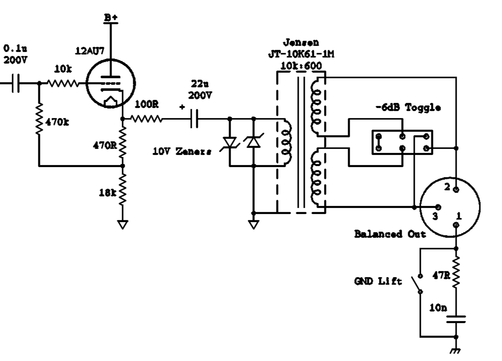

Hi Guys
The first CF could be eliminated entirely simply by reversing the order of the EQ and the gain control. As TUT6 describes, CF driven EQs tend to be rather limited in their range and dynamics.
The second CF should be self biased - just replace the series R from the preceding gain stage to a coupling cap, then get rid of the diode in series with the CF's grid-leak (such diodes a re a really bad idea).
As others have pointed out, the opamp circuit is not laid out properly. A TL072 is a poor choice for a line driver - better to use a 5532. Why not take the input to this circuit from the CF output since you are not providing separate levels for each anyway?
Overall, I see this as an Ampeg SVT pre with some bits re-ordered. It's not a great preamp but at least is much better than the associated power amp. The PA provides all the gain you need to go from instrument to speaker, as the PA input is protected by antiparallel diodes - so less than 700mV peak. A bass easily puts out that much signal if you bash the strings.
In light of the Ampeg-expected interface for the PA, it should be clear that you can eliminate the 68k-30k divider at the output level control if you want to drive any other standard PA input. Most PAs need 1-2V to achieve full output.
Supply voltage for the preamp effects headroom and linearity. Ampeg was nominally designing for clean tones, but also for muted treble tones as was the fashion of the day. As TUT3 details, playing through the SVT PA section alone yields a very muffled sound - no highs at all. Hard to get harmonics or a good slap-bass tone. Fender PAs are unlimited in this regard and much simpler to build.

In an SS preamp, no big problem.You can make active EQ without coils.
In a tube preamp, with close to 300V power rails, the possible 300V PP signal available will be clipped to death by 30V PP max capability of +/-15V powered Op Amps.
That's why in tube amps Relays for switching (or LDR) and actual coils are still used instead of gyrators or CMOS/FET switches, typical tube level signals can't be handled by typical SS components.
In fact, most typical SS switches can handle even less: 15V PP .
That is a DC coupled cathode follower. The diode is for longevity, and the lack of a capacitor is the feature of this stage.

Yes, I know what DC coupling is. There is no need for the diode if you reduce the current through the follower. The follower is doing very little anyway so it can easily be dispensed with altogether. Were it driving the feedback loop or one of the long output cables, it would serve some purpose. At the moment, it just increases tube count. Ampeg used a single-triode bottle to implement it, but that was when you could get such things cheaply.
The reason DC coupled followers need protection is that they can latch up during start-up. The grid goes positive before the cathode is emitting electrons and the tube ends up saturated. Not surprisingly, if the cathode resistor is higher in value this latch up never happens.
If you really need the follower and also really want the attenuation to the output level control, you can simply split the cathode resistor and take the signal from the tap. This would seem appropriate given the comments above about reducing component count. On the other hand, this solution requires a higher value cap than placing the attenuator after it.

Frankly, asking someone if they've built something is not offensive, rather a way to find out what experience they have. Many of the comments made suggested a distinct lack of experience or understanding about how these circuits function and/or how they are typically used. As a point of interest, the SVT followed the original Ampeg philosophy of design: loud, clean headroom. Things had just gotten loud enough by the 1970s to warrant having a 300W+ amp. The "intended" users applied the amp just as designed, where the players in the evolving heavy rock and blues forms were pushing amps to clipping. Ampeg's philosophy was very similar to Leo Fender's with respect to intended use of their products.
With respect to the original poster's circuit: In moving the end of the feedback path from the CF output to the plate of the first stage of the EQ block, you've bypassed the second gain stage and lost all of the "power" of the feedback loop. The amount of boost and cut is severely reduced this way. In the context of the Ampeg circuit, the CF was useful in that it drove the feedback path and the output of the block with a low impedance. This is necessary given that in their circuit, when the mid pot is panned all the way to one end only 620R separates the coil to ground from the EQ block output. There is also a second loop that provides broadband gain.
What you have instead is a poor version of the EQ used in the Fender 200W bass amp. That circuit looks like a concertina splitter with the main output taken from the plate. The EQ pots straddle the plate output and cathode output with their wipers tied to ground through LRCs. The stage becomes a gain stage when the pot is swept to one end - at least for a given frequency range - and the signal is passively cut at the other end. This EQ is set up as a 6-band EQ including the presence control.
How much warmth a given circuit adds is up to the individual player to assess. One or two free-running stages adds distinct tube colour. The enhanced circuits, such as SRPP or circuits with feedback loops, tend to lose some of their tubiness but have their aesthetic appeal mostly from a technical view. In this regard, it is highly relevant if the original poster has built or tried any of these simpler things, or is he just launching directly into the technically interesting circuit?
As I said above, the Ampeg PA has a seriously limited frequency response that squashes the dynamics of the preamp tone. Building just the preamp will result in a brighter tone than you may be expecting. Also keep in mind that most MI speakers are woofers with very poor treble response. Speakers have a huge influence over the final sound. Going direct into a sound card or mixer will require a bit of EQing to have a tone similar to a miked speaker cabinet and complete amp. Fortunately, achieving this in the small signal domain is relatively cheap and easy.
TUT3 provides a history of the Bassman and SVT circuit evolutions with easy to build final forms that use off-the-shelf transformers and parts.
