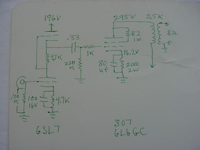

Critique my circuit?
This proposed circuit is little more than the driver from my Fi Primer Loftin-White & an output stage from an old AudioXpress. The driver has lots of gain & sounds good. The output stage seems like it could use a higher Z OPT & maybe a different operating point to better match the 6L6GC?, as I have a shirtload lying around left over from my guitar playing years. I'm quite pleased with the L-W, but can't seem to stop building amps.

Hi 5u4,
nothing to really critizise, only a few remarks to consider:
6SL7 likes considerable higher plate voltages best, about the 195V total you halved for each system in the symmetrical totem pole. If you like it as is, okay, but I would prefer paralleled sections instead (also that would mean one heater winding less - max. heater-cathode voltage for 6SL7 is only 90V, IIRC).
Also, bandwidth will be more limited using the current trickler totem pole you showed than with paralleled 6SL7 sections. Don´t get confused by the "on paper" low output impedance of the totem pole - what counts instead is the peak current driving capability into the Miller-C of the trioded 6L6 (about 70pF, I guess). Your totem will be able to swing only a few hundred nano-Amps (at best) into that Miller-C without slewing in AF range.
You can happily reduce the coupling cap to 0,1uF or something.
A more appropiate plate load for trioded 6L6 or 807 would be around Ra=5k, but don´t expect more than, say, 1,5-2 Watts Po, either way (plate load).
The same plate load (about 5k) could give up to about some 8 watts or something when using tetrode mode instead. So, maybe supplying a switch to chose might be of interest. (For tetrode mode, your totem pole would be preferable, allowing for more gNFB due to higher gain - and it certainly will drive much lower Miller-C of 6L6 in tetrode mode to much higher freqs).
Given the gain reserves, 3-6 dBs of gNFB are possible even when using paralleled 6SL7 sections (which will produce less gain than your totem pole setup) and 6L6 in triode mode. And don´t miss the opportunity to try that. Might improve bandwidth and damping factor noticably.
But, as this all are only remarks, just start with the schematic as shown, it certainly will work as is.
Tom
Thanks for the info. Guess I'm not going to get a decent amount of power, "low" distortion & high gain from a triode 6L6 no matter what, which takes me back to the original plan. The Fi Primer 6L6 amp or Chris Beck's version, which is: SE UL, global NF & pentode driver.

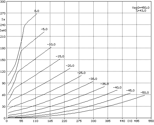

Hi 5u4,
I feel a bit reluctant about 6L6 or 807 SE UL mode, since only very limited and scarce data is available (I know only the Sofia Audiomatica plot, see attachment below, which is almost useless for SE -designing due to the excessively high g2 voltage and very limited g1 and plate voltage range).
My best bet would be going along the STC 807 spec sheet class A SE tetrode mode recommendations with Zener- or VR-tube regulated screen feed, a 6SJ7 in front of that, and using about 12-15dB of gNFB.
