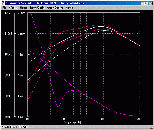

Below is the simulation by Subwoofer Simulator, written by our own F4ier, for a Shiva in a 50 liter sealed box.
The lower white line is the response in "half space" the way most simulation programs do it. The upper white line is the response with the average amount of room gain.
The room gain is from an frd file written by our member Serow.
The purple line is cone excursion, which actually seems to match quite well with the Shiva's linear excursion.
Even with room gain, the response is only 105 dB at 20 Hz-not great. At 30 Hz, though, you get 110 dB with room gain-pretty good for a box not even 2 Ft³.

PS: Just want to add that the above simulation was for a Shiva with both coils driven in parallel for a 4 ohm total load. The voltage level was 28 volts, which into a 4 ohm load yields 196 watts.
The reason I selected approx. 200 watts is that reasonably priced sub amps are available in that power range. The Shiva can take more power than 200 watts, if you want to provide it.

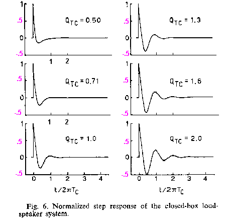

At or near resonance, the closed box has much cleaner step response than the bass reflex. If you survey the step response in the thread I gave you before, you should know that that the cleanest ported box's ressponse is worse than a sealed box with a Qtc of 1.3. The "classic" bass reflex, where Vas=Vb, and Fb=Fs=F3, has step response worse than a closed box with a Qtc of 1.6.
attachment.php
The whole idea of the article is to give the builder a subwoofer with bass that is under control without the use of an expensive servo mechanism. Either the parameters of the Peerless changed or something happened, because he ended up giving a box with a Qtc or 0.4 instead of 0.5. But even with that fact, the subwoofer he outlines will give extremely clear, controlled bass. There is not that much difference between a subwoofer with a Qtc=0.4, or Qtc=0.5.

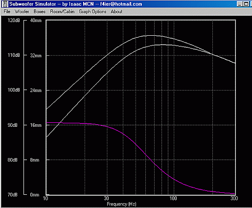

Or else you can use the Peerless, put a 4" diameter port with a screwable end cap-available at any home improvement store-and make yourself a convertible sub. Sealed for music, ported for home theater.
The closable port will be 33" long. box volume will be 50 liters, including the port.
You can do it. :)
Here is the simulation, woofer driven at 28 volts, (196 watts into 4 ohms)
The red line, lower, is the half space response vented.
The red line, upper, is the vented reponse with room.
The white line, lower, is the sealed response inhalf space.
The whitle line, upper, is the sealed response with room
Quite an improvement, don't you agree?
Nothing wrong with the Shiva, just showing you options. ;)
