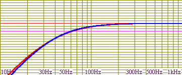

Here is the WinISD simulation using Joe Rasmussen's own measured numbers for a box of 33 Hz, (blue) and 42 Hz, (red).
Red = Qtc is 0.46
Blue= Qtc is 0.50
Not a lot of difference. :)

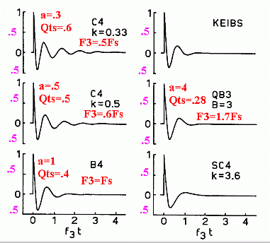

Dave, here is a chart of step responses for various values of Qtc. As you can see, there are only minor differences between Qtc=0.5 and Qtc=0.71. If you ever saw the step responses of Vented Boxes, which some people, (including myself), think sound just fine, then you would see there is no real reason to get nervous about this. Regardless of what you do, you are going to be much, much closer to Qtx=0.5 than Qtc=0.71.
