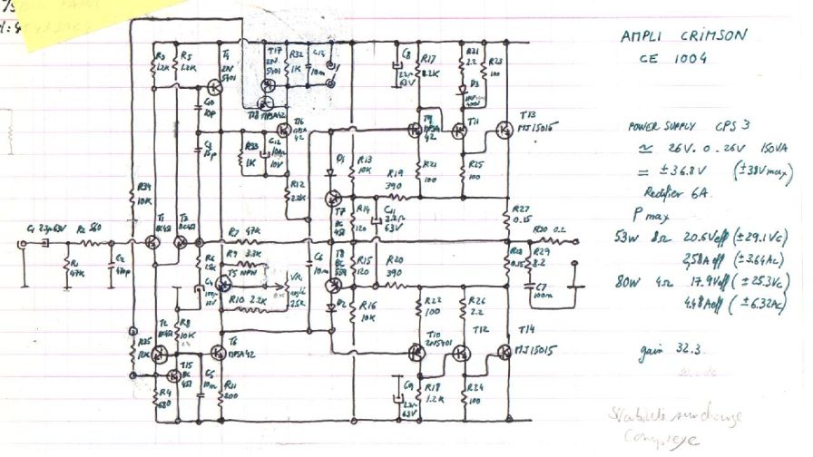

it's a shame it's a monoHow's about this for validation; Vintage WESTREX Amp Amplifier | eBay
Westrex only used the best, so Brian's design must have proven itself to them.
https://www.diyaudio.com/forums/att...on-krimson-amp-schematics-westrex-crimson-jpg
Good for centre channel for cinema
