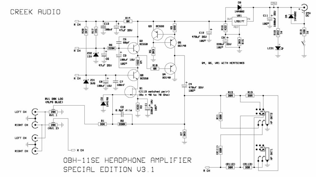

Greetings to you. A friend was moving, packing up, and unexpectedly gave me a Creek Audio OBH-11 SE with a big transformer power supply. Not sure what the differences are between the regular and SE versions, but wondering if I should try the mods here on the SE version? I listened with a good source using both AKG 701 (around 65 ohms) and HD 650 (around 300 ohms). In both cases, I had to turn the volume knob to 12 or 1 o'clock to get to a reasonable volume listening level. Is that normal and would the mods here improve that? Otherwise, I found the amp to be surprisingly good as is for a small little amp. Thank you.
I can add that both "SE" versions were Class A, the earlier one was MOSFET + BJT based, "zero feedback", the later version was JFET + BJT with a negative feedback, with the constant current supply arrangement. I still use the second version OBH-11SE here when I need a headphone amp.

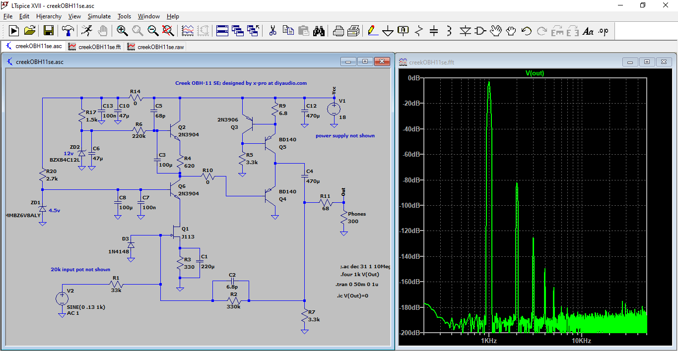

Thanks for posting your design - it looks great to me. I have played with in the LTSpice and it has a beautiful-looking 2nd harmonic dominant profile. Would it be okay if I post my spice file, and build one for personal use?
jason
I have no objections, however today I would replace the output devices with a modern option (for example MJE253G) as currently made BD140s are quite horrible and have nothing in common with the original Philips devices used in OBH-11SE . Also don't forget to put output devices on a heatsink.

Attached is my .asc file, where I just used generic devices and a 4.5V zener since my LTSpice library doesn't have a 3.9V. I will at least breadboard a version with lower gain (R2=100k or maybe even 68k) since I use low impedance phones and listen at low volumes. Time to add some jfets, zeners, and other stuff to my next order.
