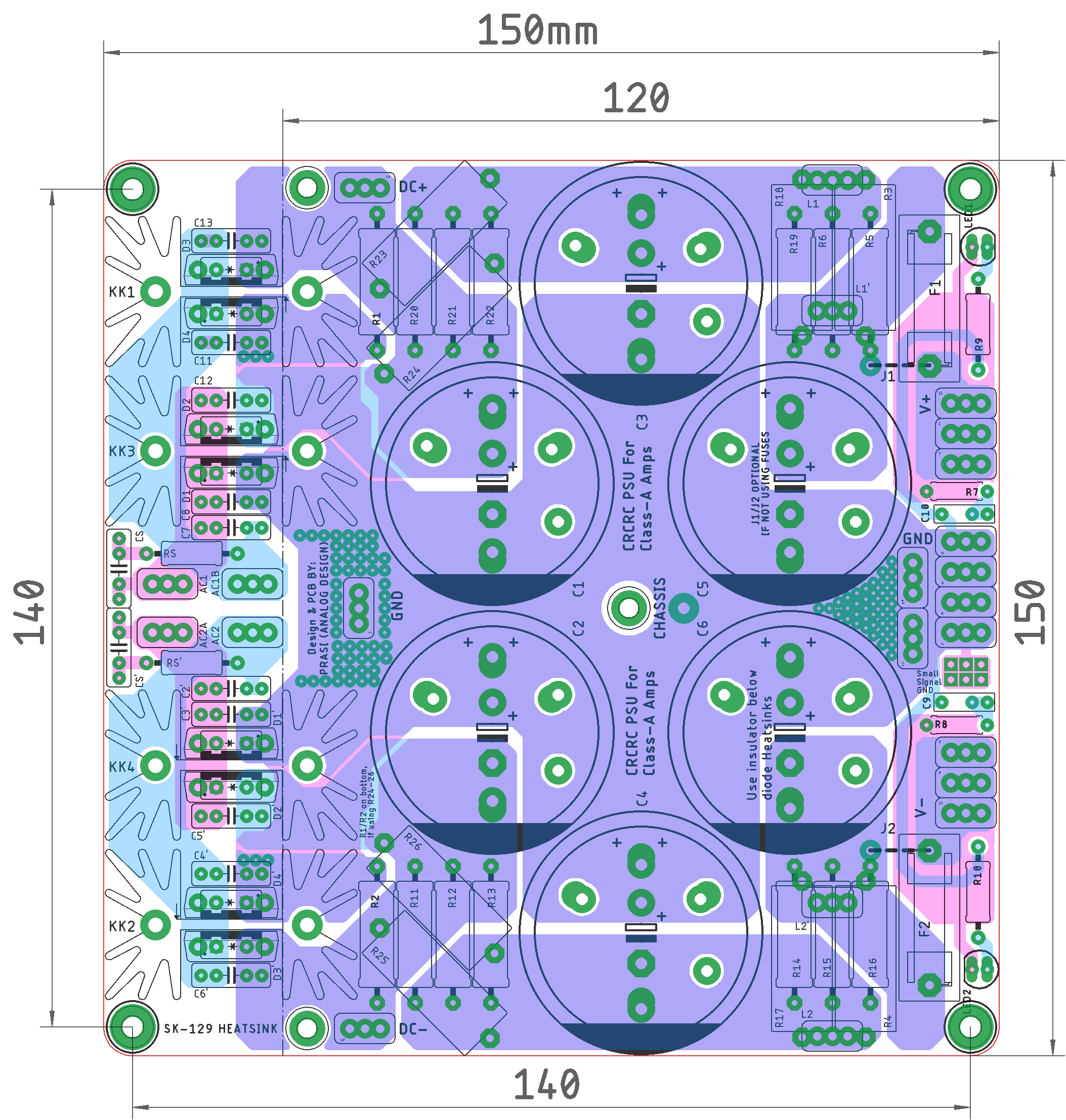

Hi PrasiAlmost ready.

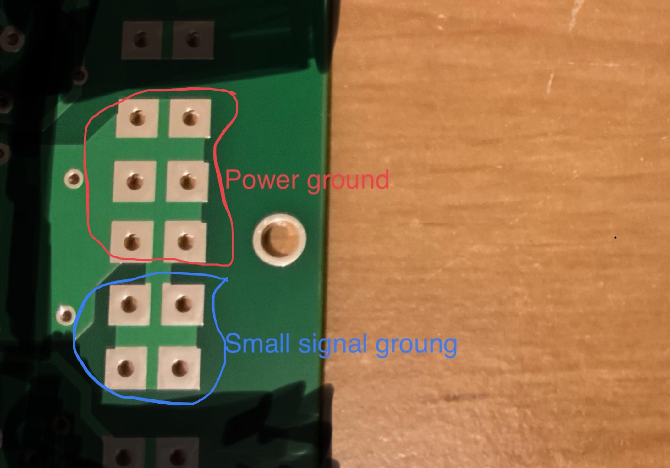

Indeed a good pcb layout. I would suggest a small change on the output ground to have a slightly higher trace return impedance for small signal ground compared to high power ground. This way it avoids more “pollution” of small signal ground by high power ground ac signal. See this example.

Very beautiful design with impeccable optimization of the place, I really think that this layout and improvements will make this power supply a must.
There are fuse doors the led inside that illuminates the transparent fuse can be the most beautiful effect.

Hello Fab, Hicoco and P16,
thank you for your comments. I have incorporated most suggestions.
P16, thanks for suggestion of fuse with led. However some may decide not to use fuse, however will want led display. For those not using fuse, J1/J2 can be populated with 1.5mm dia wire.

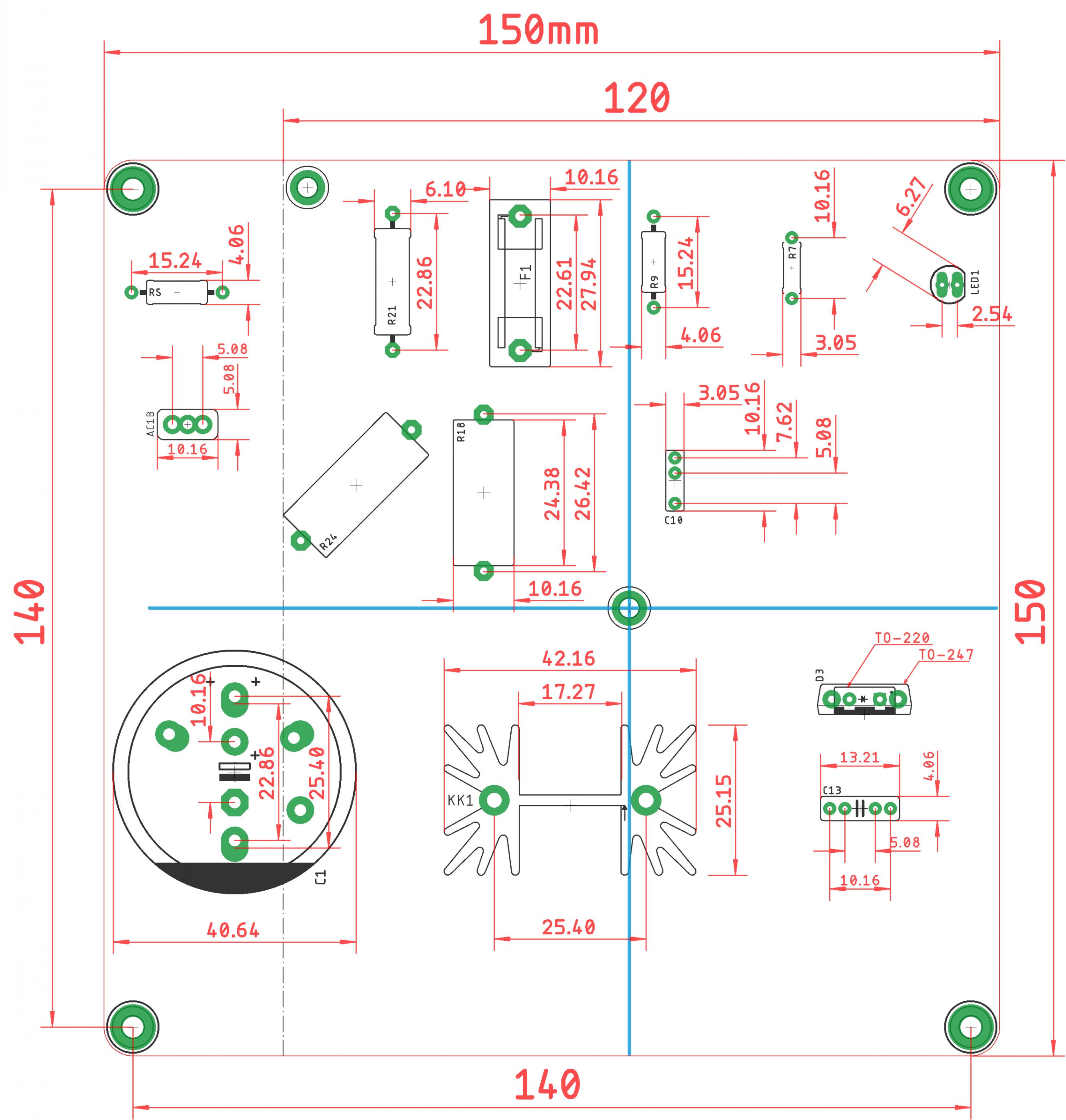

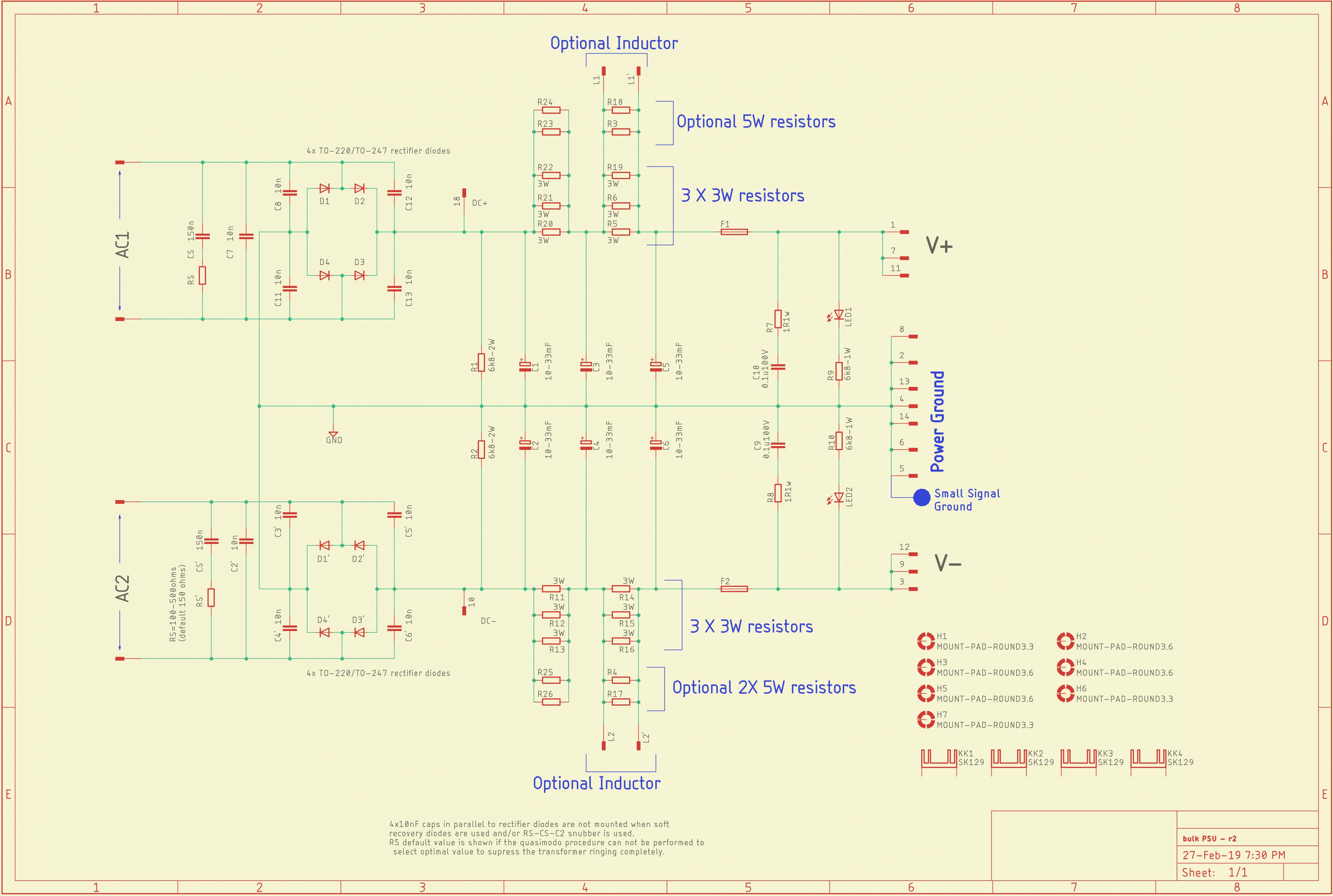

I am attaching the schematic and layout along with component dimensions.
I think this will give general idea of components to be used.

If you want to isolate the small signal GND from dirty power GND, perhaps a 10R resistor GLB and two anti-parallel 1N4004 diodes and 22nF film cap in parallel to form the connection rather than just a thinner trace - which is so short I am not sure it will it will provide any benefit.
