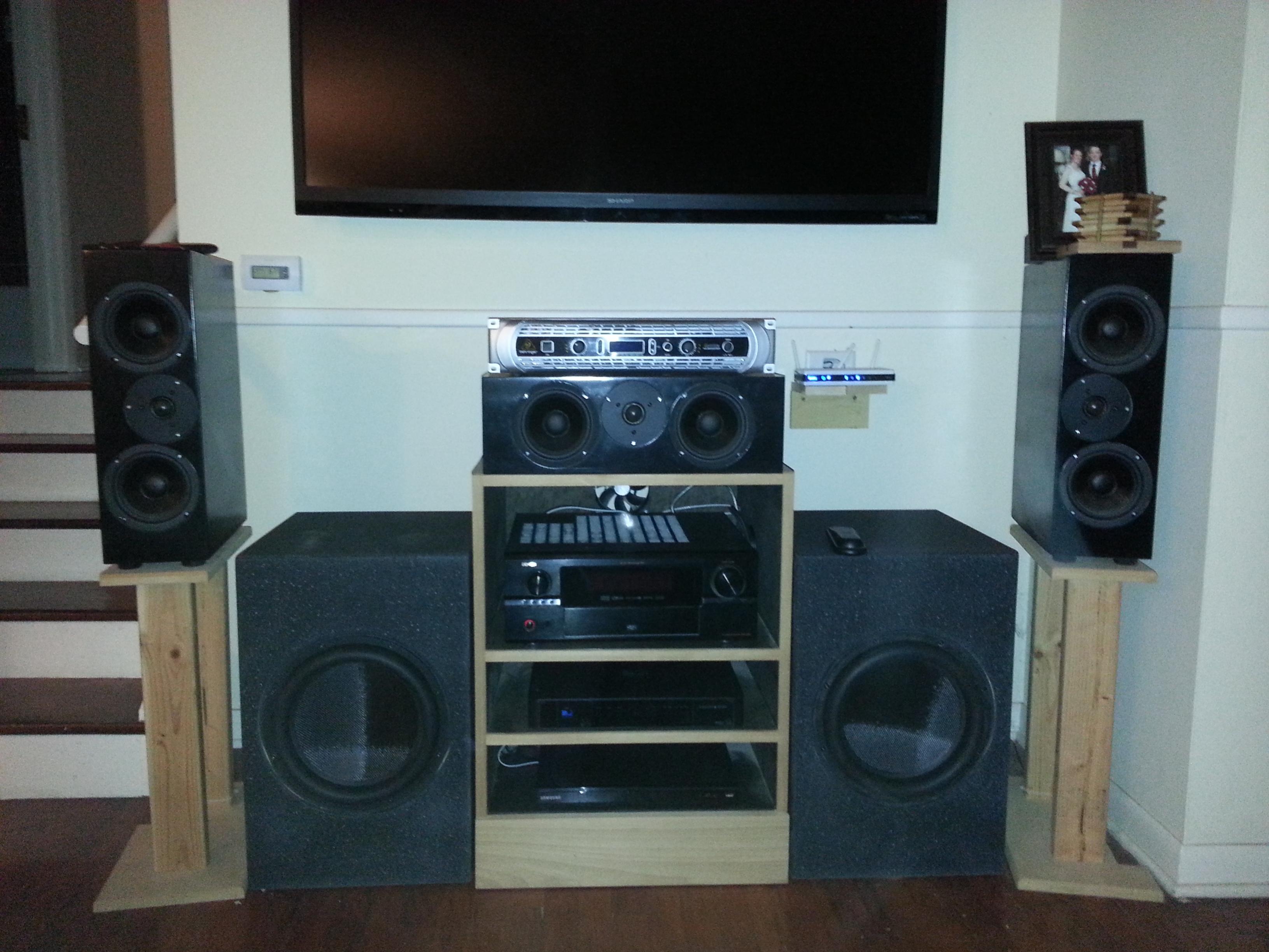

currently have 2 bash 500 amps.I assumed the bjorno option was in addition to what I have. I will have to convince the wife to accept a nearly 6 foot tall enclosure in the living room
IMHO, you haven't verbalized what your trying to accomplish with a third sub. I'm sure that the two sealed Ultimax 12 subs you currently have are more than enough(maybe with some EQ tweaking) for listening to any music genre.

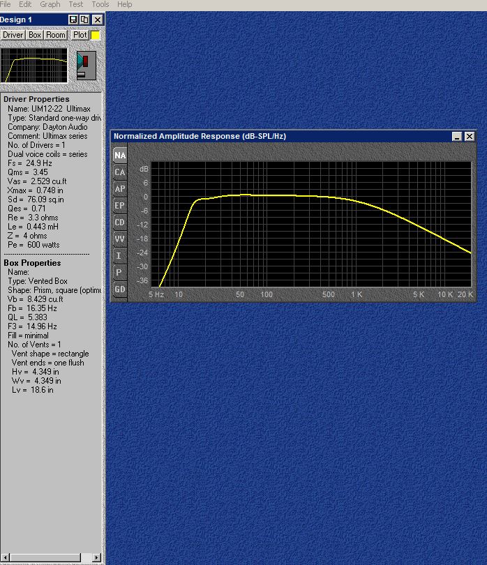

I see you have followed the orientation from Partsexpress the 2 cu.ft. sealed box.
I'd build two vented enclosures, this Bash 500w should be enough to drive the Ultimax 12, coils wired in series (6,6 ohms) so pushing them at 300w, giving 108,5 dB.
Something like the image attached, there's a little boost 2,5dB at the end I know, I've been using mine like this with a 3dB boost, but I don't use the sub on the corner. According to Geddes middle-sideways gives a good excitation for the room.

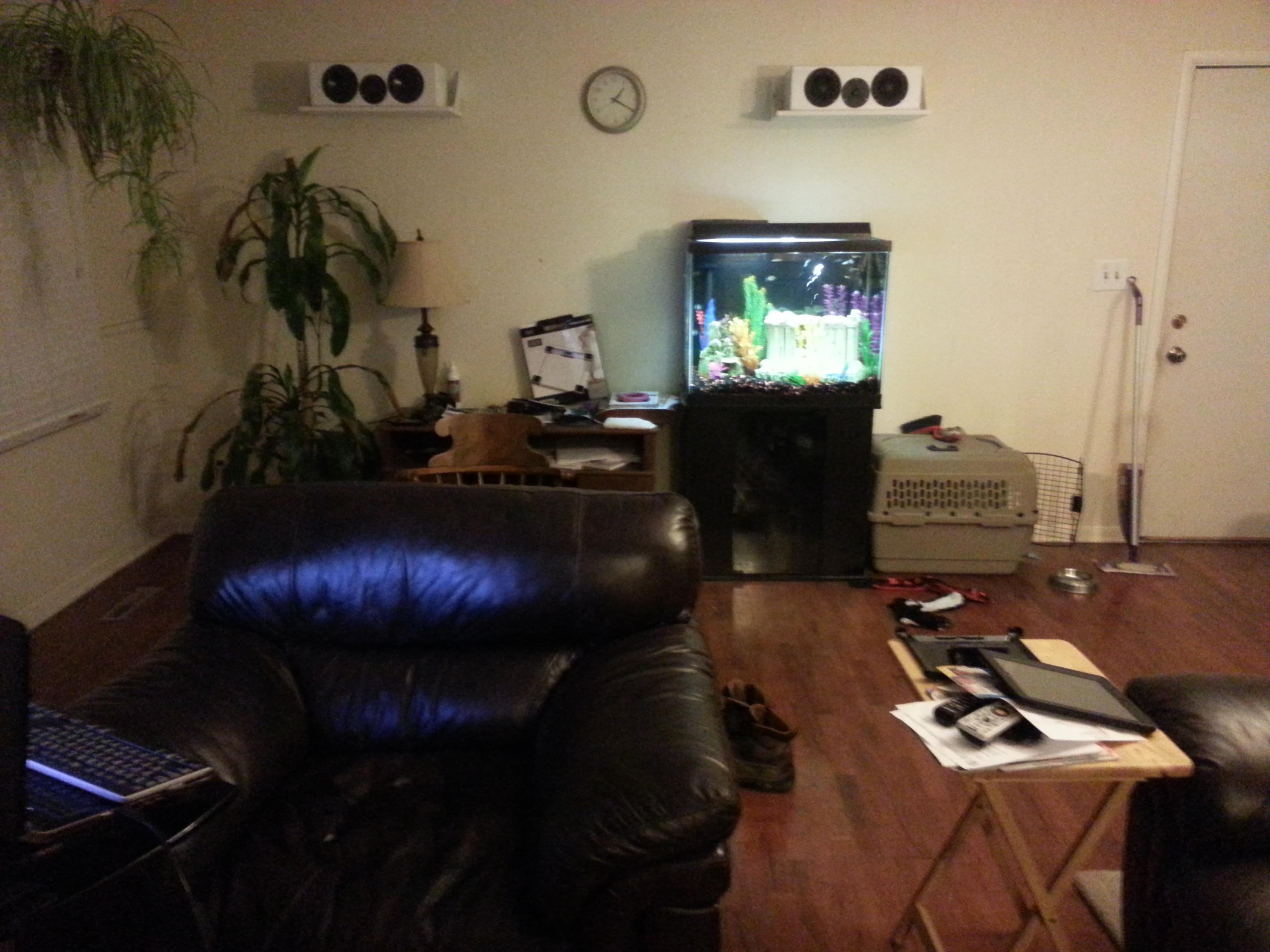

  • What's your available net volume (footprint/space). You mention room, which is 20X15. footprint could be 30-36 inches deep or wide and up to ceiling on your post #8.

Working interior space after all braces and driver account for = 7 cu ft.
all 3/4" MDF with double thick front baffle
4" flared(both ends) port 16" long
Box tuned to 17 Hz
HF driver xmax will be reached at 300W
Output = 112 db
f3 = 21 Hz
f10 = 14Hz
And yes, it is clean for music but does shake your socks with LFE from movies
I went for it. I built a third subwoofer using the dayton reference HF 15". very large enclosure,,ended up being 8.4 cubic feet after bracing. 2 4inch 16inch long ports,,. bash 500 amp. bassbox has the f3 at 22Htz. I am completely satisfied with my decision to build. The fullness of the lower frequencies that this sub provides has made my system complete. Movies are incredible! Music is wonderful. I worried that the 15 would drown out the 12's, but it does not. I can hear the tightness of the 2 12's just as clear as I can hear the rumble of the 15. I am thinking of minidsp still,,,or possible putting a 50 hertz highpass on the 2 12's. I appreciate everyone's advice. I am stubborn and hard headed,,but I do learn from you guys despite my stubborness. I feel a bit sad that I have no more speakers to build. I may have to sell it all and start over. For now I will just enjoy.
