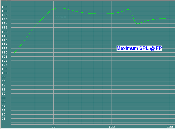

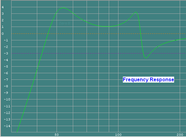

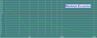

Here's an DCR that i did today with the time i had, with the intention of taking it further at some point by adding on the A
18 Sound 18NLW9600
45Hz - 130Hz + or - 2dB
No excursion problems
Full 1800W AES Power down to 40Hz
Box =
Vol 1 = 120 L - Port 1 = 150mm Diam x 380mm L
Vol 2 = 60 L - Port 2 = 150mm Diam x 200mm L
Internal Port 3 = 150mm Diam x 50mm L
3 x Round Ports
Looks ok so far in all respects i believe, and adding on the A should "hopefully" GAIN further benefits
