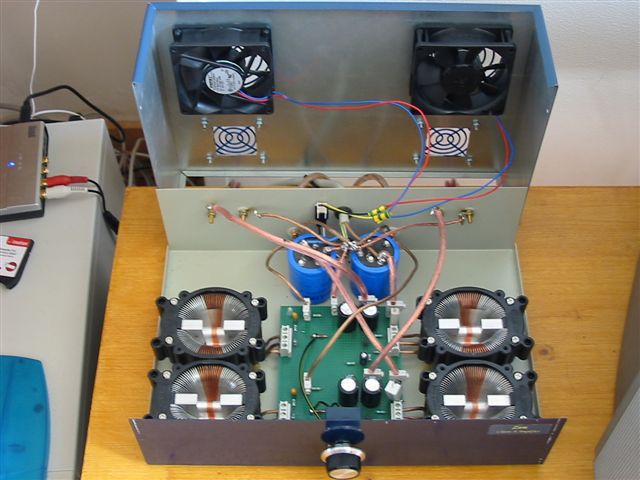

I'm getting back into building my zen v2 which got back burnered for about a year after I moved. I had originally built it on the bench (no case) with a pair of the cheezy heatsinks that came with amd athlon processors. I think it was an 1800+ I ran two of them, one for each channel, and put both the current source/amplifying transistor on the same one.
It worked just great, not even really warm to the touch until one day when I accidentally disconnected the fans just before leaving the room to get a drink. Came back 5-10 minutes later, and had to shut it off, wait 10 minutes, peel the heatsink out of the hotmelt glue sticks I was using to temporarily hold them up, and re-solder the wires to the mosfets which had gotten hot enough to desolder themselves. Amazingly enough they still worked, but at some point my cheap sound card I was using for a test source got killed.
so IF you're going to use cpu coolers make sure the fans never stop.

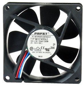

As for your case airflow/noise concerns, my biggest recomendations for reducing noise is to reduce the restriction on the airflow immediately near the fan.
the cheap punched steel grills that are cut in many cases cause a lot of restriction which leads to a lot of noise. cutting them out, and replacing with a thin wire fan grill will help. No grill even quieter, but will be hard on the fingers when you get stupid with it.
Another thing that can help a lot keeping noise down is to move the fan grill away from the fan with some kind of duct. You still want it to seal, not like the cheap "fan silencers" you can buy, but if you can give an inch or so of clearance it will reduce the airspeed through the grill, and quiet things down considerably.
An excellent trick a friend of mine came up with is to get some dead fans the same size as the ones you're using, and cut the fan part out, so only the frame remains. You can stack the empty fan ring between the fan and the grill. (dremel tool works well)
Myself, I think I want to lose the fans so I'm on the hunt for a large heatsink, although that's a subject for another thread.

Yeah. I just drilled and tapped them. There's no flat surface on the top of most sinks where you could put the nut.
Possibly if you drilled it right in the centre where the clip normally sits.
my next project is going to be to see if I can weld together a couple dozen athlon64 or P4 heatsinks into one big one, and run it without fans.
