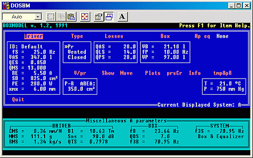

As opposed to mfg with "corrupted" information, I've found an example of mfg offering very good information*: http://www.d-s-t.com (home of Peerless, Vifa, Scan-Speak). It seems their graphs show SPL at 2.83V, and an impedance curve is showed as well. Since I'll be using an active XO solution I don't care that much about impedance, as long as it doesn't go so low as to make the amp run out of steam. What I want is ruler-flat SPL from X to Y Hz, measured at a specific voltage [the amp outputs volts, the amperes is just a "consequence" of the speakers impedance], and now I've understood how to read mfg graphs, thanks everyone for enlightening me!
* = I'm not affiliated with DST in any way, I just happen to like their graphs.
