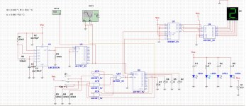

I have a 555 generating pulses feeding a 4029 or a 4017 which counts them. When the 4029/4017 reaches, say, 5 counts, I detect it with a couple of AND gates and then reset the 4029/4017 so it starts counting again from 0.
This works fine when the output of the divider/counter is used to drive say a 7-seg display or an LED.
However this technique of resetting still allows the count to reach number '5' even for a few milliseconds and this is undesirable. What is the proper way of counting to X and resetting at X+1 but without allowing X+1 to appear at the output ?

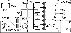

Maybe skip the and gates? Here's something similar for inspiration: PROPORTIONAL RADIO CONTROL by SM0VPO

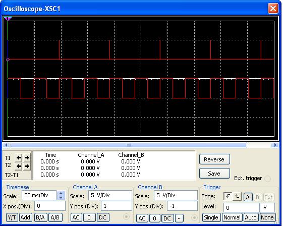

Maybe not 100s of milliseconds but there is a spike at the output. As you can see the outputs will also need to drive relay switches, and I am scared that some relays receiving spikes and maybe even accidentally switch on.
Probably the problem is that you correctly decode the '5' but to reset the counter, you need another clock pulse and until that one comes along, the '5' is tehre.
So you should use the gate detection of '5' to reset and clock the counter at the same time. You can combine clocks with a couple of diodes.

The chip resets immediately on the '5' - here is the simulated oscilloscope output from pin '3' at the top and the clock pulse at the bottom. The intention is to count: '1', '2', '1', '2', '1' .... so when the '3' comes in the count goes back to '1' - but there is a spike that appears (necessarily) on '3'.
Maybe this spike is nothing to worry about, I am just looking for a cleaner way.

So latch the display on the other edge of the clock pulse so the counter will reset while you're not looking. Cheesy but effective and no worse than 555 timers.

Use a low pass filter to drive a Schmitt trigger? That will smooth away the spike. Remember, all digital circuits are merely overdriven analogue circuits so you can use analogue tricks - the circuit itself is using all sorts of analogue tricks you don't want (stray capacitance, ground bounce etc.) so why not add one you do want?
