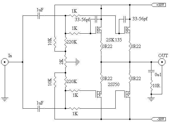

Well, the seller is here in NJ, so I was thinking I might be able to pursuade him to make an extra-tight match.
I've been spending quite a bit of time trying to understand power MOSFETS - it seems some ot the vertical ones have a NTC and some a PTC after a certain point. I've also read (only on one page) that the 20N16/20P16 seem to be more prone to oscillation than the 10N16/10P16.
It looks like what I want to do can be done with a relatively minimum amount of effort. The only advantage I can see of really tight matching in this open-loop output circuit (with NTC devices) is to lower distortion. Am I missing something?
I'm not expecting a damping factor that is much better than a tube amp, and so far (when the amp is not oscillating) the distortion measurements are lower than the originl spec, and on par with a tube amp.
I'm going to try one more thing before I shelf the amp for another year - I attached a schematic that I found.
You are right, Chris - the more I look at this design (and the more I learn about design) the more goofy it looks. I'm starting to think it shoud be abandoned and maybe made into a MOSKido :)
That's if he is capable. Who knows how he is matching his stuff? Could be okay, might be acceptable for normal designs. This design requires very, very close matching.
Those issues aside, oscillation is a problem for all mosfets, so once you have it licked - no sweat from there on in.
After your parts are matched - yes.
Nope. Although, matching these outputs will probably reduce distortion as a side benefit.
Yes. Current sharing. If one of the pair works harder than the other, you may have that channel fail. Who wants to redo work already done. That just means your first bit of work is totally wasted. Most people would blame the design after this happens when it is really their own fault.

Why not just finish it while the concepts are fresh in your mind. Counterpoint sold lots of these, and if you use better (for sound) outputs and watch the idle current you should be fine.
Look at it this way, you have a dead SA-100. If you repair it, it's worth more to sell and you might even like it. At the very least, it's a good learning exercise.
