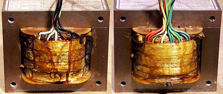

Yes, two leads, connected to the same secondary winding. You can see that in the pictures I posted towards the begining of the thread. This incidentallly makes for an additional ground loop since the actual ground wire from the transformer is split in two, then recombined in the amp.
Still, the core is simply underdimensioned. It's a 200VA transformer AT MOST, and this would, with some clever design, perhaps suffice for 60-80WPC reliably - but you and I both know clever is not really in the picture. Ohm's and Joule's laws simply don't work 'by ear'.

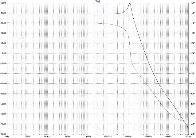

Hi Brian,
Your oscillation has got to be in the final stage, or more likely in the output stage. Those models have normally been burnt out already and I don't get a chance to see them. The thought of one of these having response up that high is a little foreign to me.
-Chris
This is a plot of the feed point to the FETs. It appears that the oscillation is caused by the path delay from the input triode to the feedback triode - psudo LTP thing.
If the circuit is redesigned to avoid the coupling cap you don't see the oscillation.
But as mentioned there are so many other issues....
Brian
